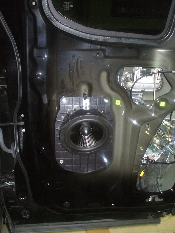

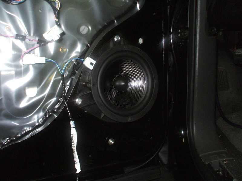

    Here was one I did for a access cab tacoma, although I cannot remember the year. He did not want to lose any room either, and also wanted to keep the factory HU. I used a Soundgate LOC 4 and caught the signal AFTER the amp, but the factory amp must remain plugged up an powered or the volume on the factory HU WILL NOT WORK.
    Used an Arc 300.4 and Image CX 64 components up front with the CX Mid Bass drivers in the rear doors. Put Second Skin Damplifier Pro on the insides of the doors for him as well to help stop resonance. In his truck the window track was very close to the speaker baffle, so there was very little room. If you build out, you get to close to the door panel. I solved this by using a longer bolt at the bottom of the track with a metal cylinder spacer to tighten it against between the track and the sheet metal. Gave me another inch or so of depth and did the trick well, WITHOUT causing the windows or power window motor to bind up.
    Another option is to use a 6.5 sub in the rear doors, and sound deaden the crap out of them. It will not be head banging bass, but it will give you that low frequency reproduction you are looking for without sacrificing room. Lots of options, but this one is a easy way to go.
    Rear Doors
    Front doors
    The bolt Im talking about is the only one below the speaker.
    Really dont have any other pics of the install. Sorry. LOL.
