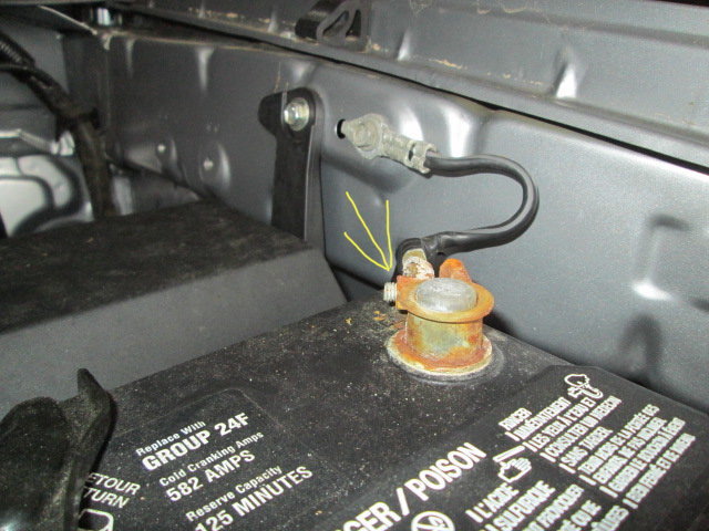

    Did you look at my pics in post 17?
    I have a 5 lug with a 24F I just pulled out tonight. So the cable is plain as day.
    'back side of the battery' is the side facing the firewall, your pic is from the front looking at the fender.
    Just because we've been wrenching a long time doesn't mean we don't have room to learn. :hattip:
    Williston, TnShooter, Jimmyh and 5 others like this.
  4. Mar 13, 2023 at 5:45 PM
    #24
    03maurderman
    03maurderman [OP] Well-Known Member
    May 1, 2016
    #185801
    180
    The picture that I show is exactly what I was looking for, call it a pig tail, ground wire, what ever...Its about 6 " long & has the terminal that bolts on the negative post of the battery on one end & the other end bolts to the fender...Now if its crimped down the line that's a whole other conversation.... I am looking to replace this part of it.....Perhaps I wasn't clear but I just don't know any other way to explain it.....
  5. Mar 13, 2023 at 5:46 PM
    #25
    fatfurious2
    Jun 28, 2014
    #132884
    49,845
    David
    Ashburn, VA
    2010 TRD OR Access Cab
    4cyl vs 6 cyl doesn't matter here. Same as 2wd vs 4wd. The battery cable is still the same.
    like others are saying, you can chop up your factory cable just to knock off some surface rust, or put it in coke, or use a wire brush if it's bothering you this much.
    if i were you, id get a wire brush for $1, use 10 min of elbow grease, and then spray some battery post protector on there and reconnect. Or you can pay $300 and have a much bigger job than 2 bolts.

    Its crimped at the clamp. Probably not an easy job to undo the crimp, replace the small section, and re-crimp. The battery wires require a more serious crimping tool than just a pair of pliers

    Your picture shows the heaver gauge cable crimped in parallel with the short body ground cable you’re wanting to replace, does it not?
    fatfurious2 likes this.
  9. Mar 13, 2023 at 6:06 PM
    #29
    03maurderman
    May 1, 2016
    #185801
    180
    Correct.... and I was looking to replace the cable between the fender & battery post.....

    You can ignore that little wire and just run a wire from the engine block where the bigger wire attaches, and run a ground wire from there to the body. But I still think your wiring is fine as is. I would just remove the terminal and unbolt the little wire and wire brush everything. As suggested, applying some dielectric grease to the terminal will prevent further corrosion. Also apply to all metal contact parts.

    pretty sure this is the part youre asking about, and yes, its part of the complete harness. battery cable.jpg
