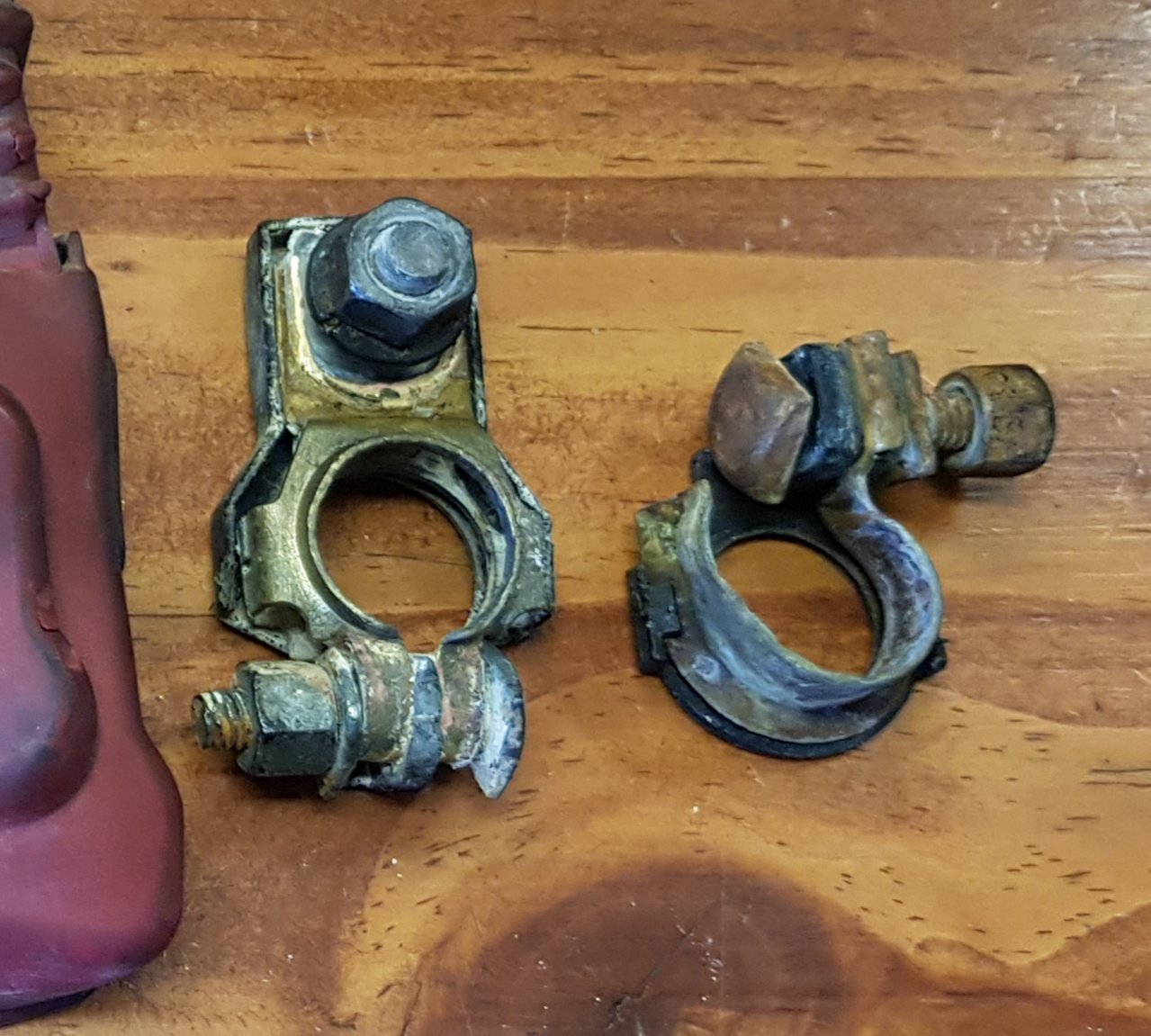

    It's cause the negative terminal does not unbolt like the positive. It's one piece with the harness that costs $180. P/N 82122-04042
    I did the same as mentioned above. I got the negative terminal from an Avalon or something, cut the radius portion of old negative terminal off, flattened the edges, & used the existing bolt hole as a ring terminal.

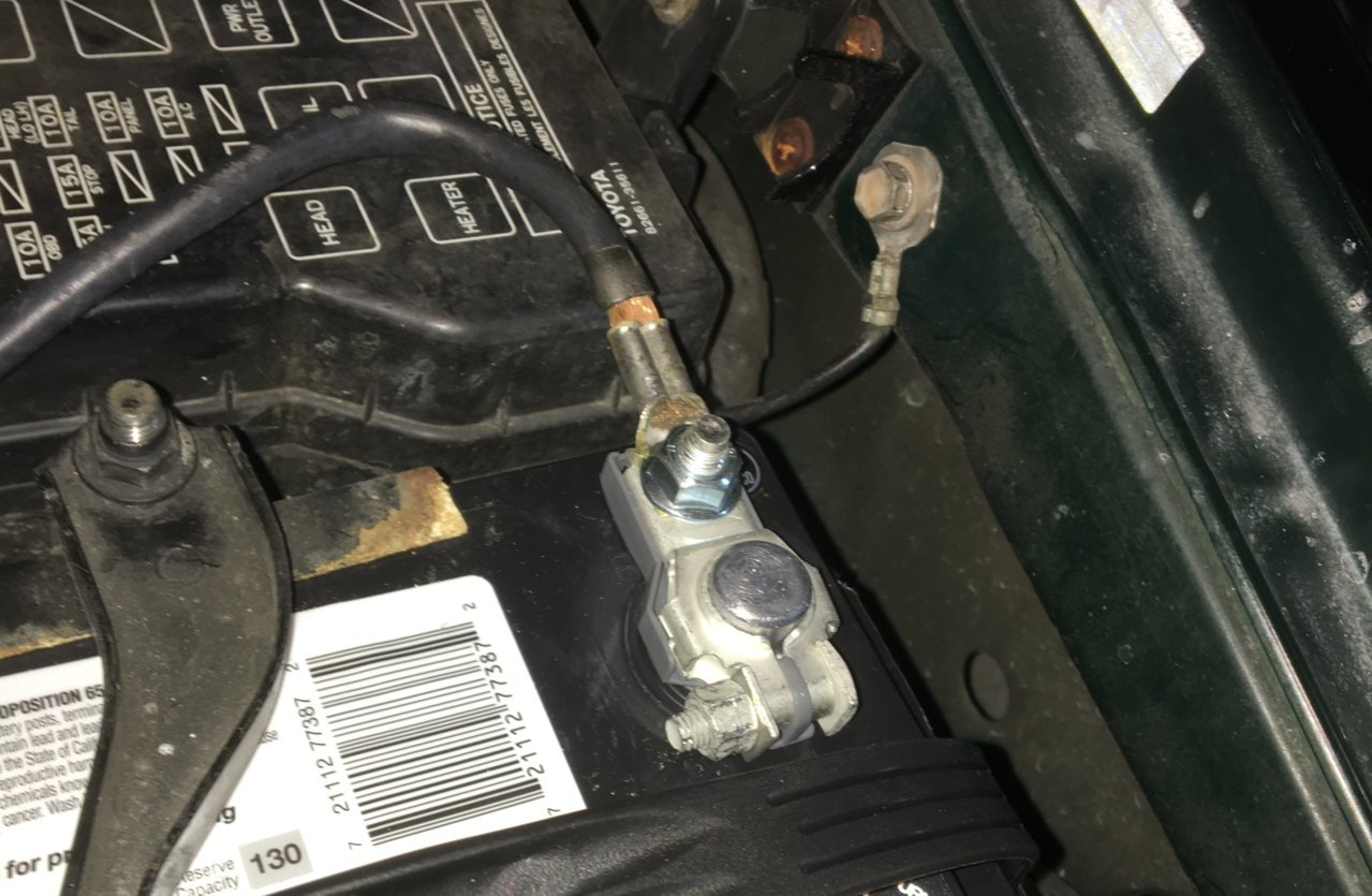

    OK, so it was a little more work than I had hoped.
    Late in the game I realized that my tin snips would go through the metal I needed to cut fairly easily after wrestling extensively with a hacksaw. Also, I needed to enlarge the hole in the cable terminal to fit onto the stud coming out of the new part. Thankfully I had a nice rat tail file.
    The part I used was 90982-06022.

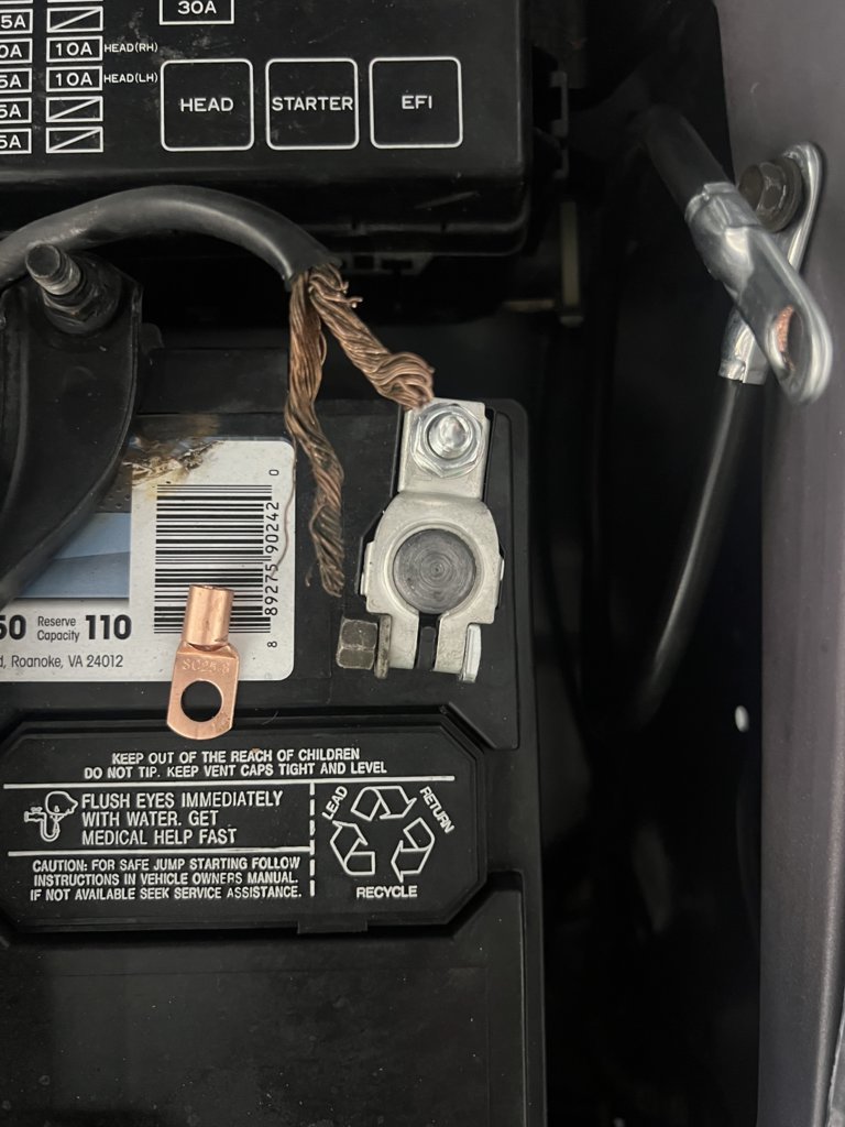

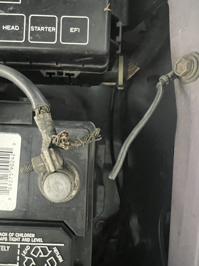

    IMG_2804.jpg IMG_2721.jpg IMG_2804.jpg Hello I could use some help here.
    I would like to replace the negative battery terminal connector as the extra ground wire that went to the body has broken off. I can tell the original terminal I’ve been monkeyed with at some point in the past. I purchased an OE style replacement terminal and a battery cable cramp kit with eyelet Connectors. I don’t have a lot of cable length to play with here. What would be the cleanest install here with eyelet connectors and does anyone know the gauge of this cable? Open to suggestions. Thanks

    I would make sure you use a tinned version of a crimp lug, just like the one you have on the body ground.
    Amazon has a good selection under the Sel term name. I believe the wire is either two or four gauge. But get a few different sizes so you are covered.
    if the wire is too short, cut it back 8 inches and use a butt splice crimp with adhesive lined Heat shrink over it and add a short piece of wire to get you back where you need to be

    Do you have enough cable to crimp the eyelet terminal on and connect it to the positive style terminal you already purchased or otherwise would crimping the negative style I linked to have enough length? Seems easiest to just use what you have in hand. Do you have a hydraulic wire swaging (crimping) tool?
