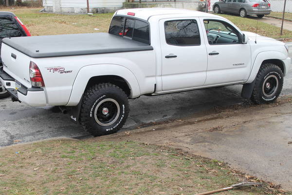

    It is done. I have to trim but I think I can keep my mud flaps. I drove it around running errands and stuff this evening. I definitely hear the tires, but i've never had mt's before. The ride is still smooth because I didn't change the suspension. The offset/backspacing is perfect for this width tire. It puts the tires right in line with the outer edge of the truck.

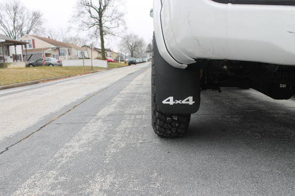

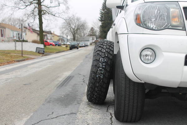

    My opinion is this is just about the maximum you can do to a truck that you regularly use on the street. I have got an almost car-like ride with the Eibach coils. No matter how much I lift it the rear axle height isn't gonna change unless I go bigger tires. These tires will still go into the wheelwells as others have demonstrated. As far as trimming the right front mud flap is the biggest offender. It happens when making a right turn. It's peculiar that the left mudflap doesn't make contact at all.

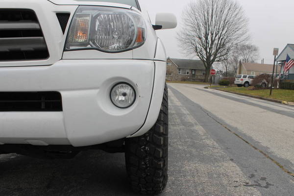

    Another from earlier today! I need a sunny day to take some more pics. Can you tell I really like the new tires?

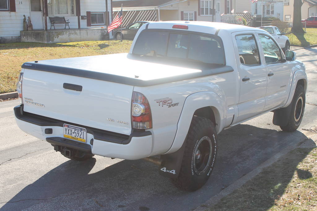

    The sun finally came out yesterday.

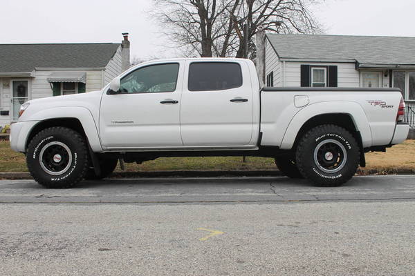

    Yeah. Just Eibach coils and the tsb. Compared to most others it looks low, like you said. Some have said with the double cab you only get an inch of lift. I might do the billy's @ .85 and small tsb add a leaf eventually. I love the tire size and wheels though. Thank you.

    Another little update. Immediately after installation the tires rubbed significantly on the right front mud flap. But only on the right side. If you walked from one side of the truck to the other and compared the gap from tire to mud flap, it was less on the right side. I trimmed that mud flap significantly and still had rubbing on certain right hand turns. Well alignment showed the caster was way out of spec. So I'll be in the market for used mud flaps soon! These pop up all the time in mint condition because a lot of owners just remove them from brand new trucks.
