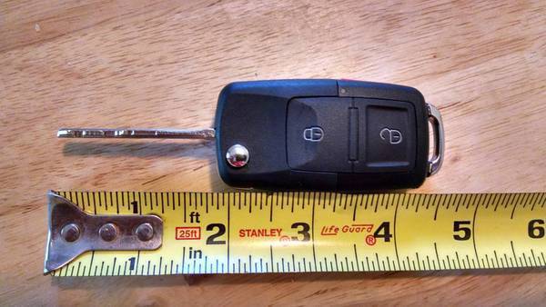

    Recently purchased a flip key with a "G" transponder from neneago for my '11 Tacoma and writing a review of my experience. I am not affiliated with the seller nor do I guarantee your interaction will be similar to mine.
    Contact and Delivery
    Contacted seller via pm requesting a flip key with unlock/lock and a "G" transponder, he got back to me immediately (literally 5 minutes) with paypal information. Seller answered all my questions promptly, payment was sent Wednesday evening, key was delivered via USPS Saturday morning which is impressive since seller is located in CA!
    Product

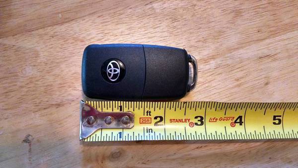

    Neneago's All-In-One Flip Key feels like a professional product and the quality of plastic is very similar to that of my Toyota OEM FOB. Not as nice as a high-end key like BMW, but it met my expectations for $50 shipped. In terms of weight, the All-In-One definitely weighs more than the OEM FOB+Key by a gram or two but being less bulk in your pocket and no pointy end is a worthwhile trade-off for me.
    The key arrives in two pieces, uncut with battery already in FOB and transponder inside case. It is the buyers responsibility to get the key cut as well as pair the FOB and transponder with the vehicle. Here's what I did:
