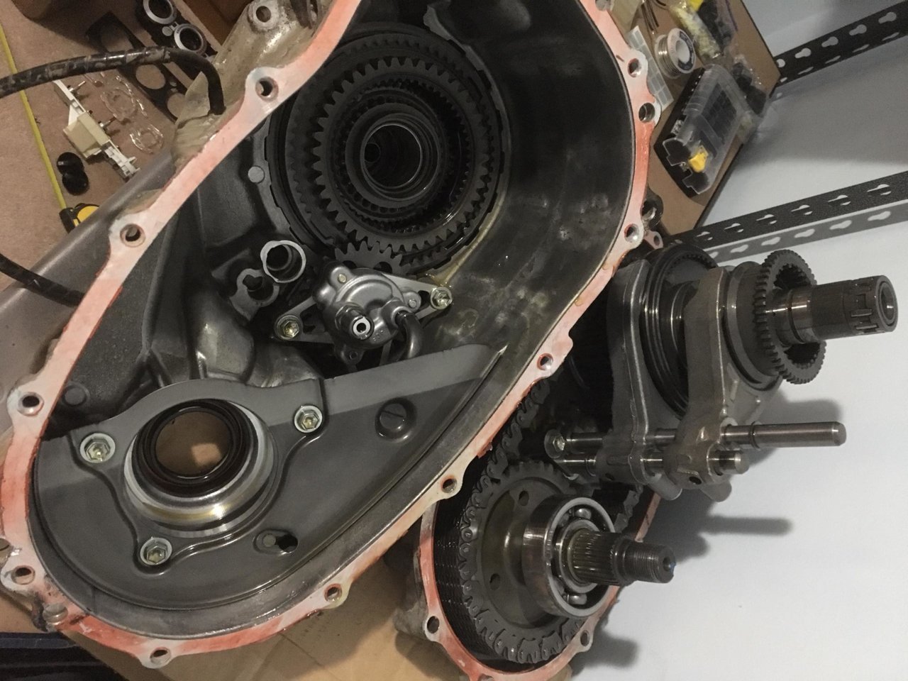

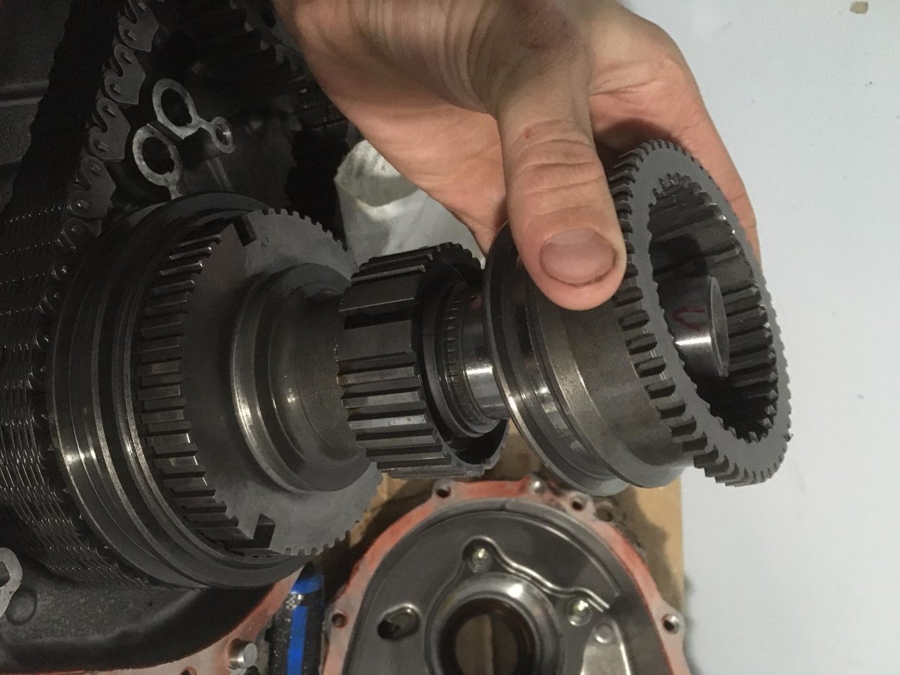

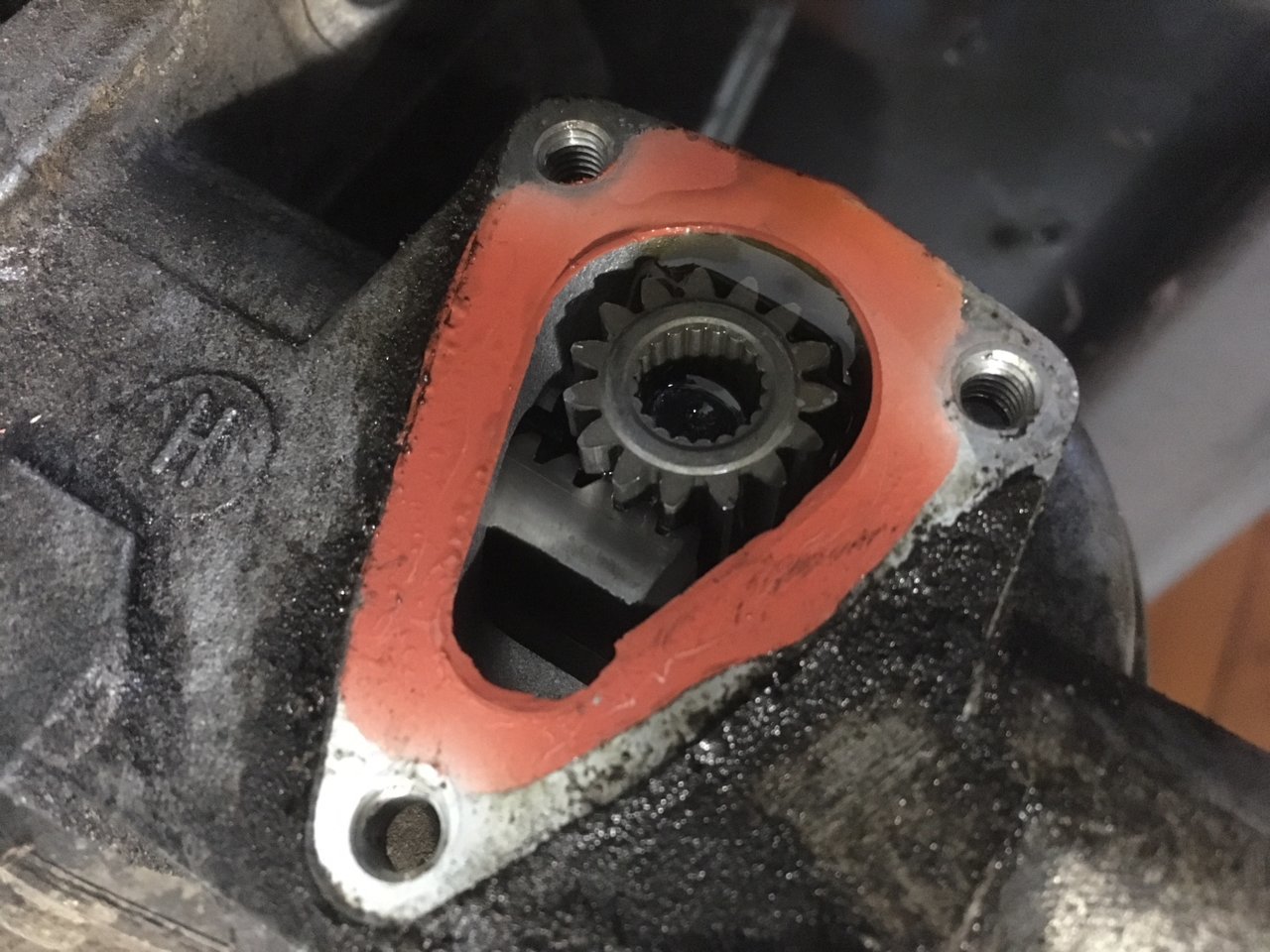

    Investigating my faulty transfer case..
    When I bought my truck, I flicked the 4x4 button into 4HI to test if it was working. When the light illuminated, I assumed all was well. However, the first time I went offroading, I attempted to put the truck into 4LO and it refused to engage. I tried many different times, and the truck refused to go into low range. 4Hi worked completely fine, and I ruled out any problems with the transfer case actuator or front ADD. Both were functioning properly.
    I recently performed an FJ cruiser transfer case swap on my truck, and now have functioning 4LO once again. Ive had my old Tacoma transfer case sitting on my shelf, and figured I might as well dive in and see what the problem actually was. The intention was to possibly fix the issue, and sell the case as a fully functioning transfer case.

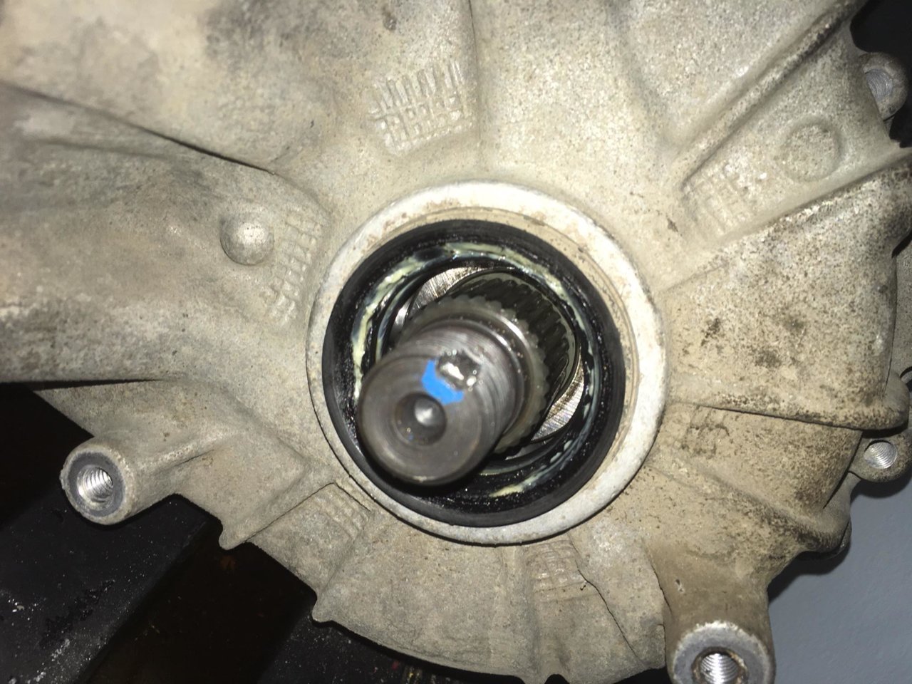

    So I started disassembling the case by removing the flange nut on the front drive flange. After that was removed, the whole flange slides off. I then unbolted the actuator by removing 3 bolts holding it onto the transfer case, and then removing the actuator gear under the small cover on the side of the actuator.
    After that, I unbolted the 12 bolts around the case, holding the two halves together, and separating them with a prybar (revealing the inner workings of my taco case).

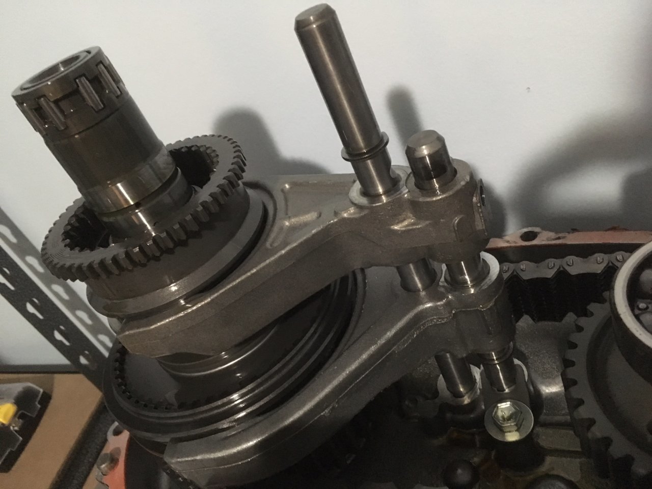

    I then began investigating the case for any stuck components/unusual movement. The actuator rod that moves the shift forks moves easily from 2HI, to 4HI, but will not move into 4LO. It just stops after 4HI and will not move past that position regardless of how much pressure is put on it.
    I disassembled the shift forks in an attempt to find the issue, but couldn't see anything. I then realized that the shift forks werent the problem. The problem was the HI-LOW clutch sleeve that the HI-LOW fork attaches to. It seems to be stuck onto the surrounding gear and will not budge at all. I took a hammer and punch and wacked it for a solid 20 minutes straight. every 20 or so wacks moved it forward about a 1/16th of an inch. It was extremely slow going and I eventually tired out. I remembered that I had a puller set and immediately went to grab it. The puller made short work of it, and I was able to seperate the gears
    I came to find that the teeth on the clutch sleeve have physically moved in some sections. They do not align properly with the teeth on the main high range gear set. As a result of this, the teeth put an extreme amount of pressure on the teeth of the other gear they contacted, which resulted in them being virtually unmovable. It took a thousand wacks of a hammer and a puller to separate these gears, so I highly doubt a mini 12v motor could do it...
    The gear will not go back on now that it had been removed. Im legitimately curious as to how this could of happened. Im wondering if the previous owner possibly damaged it by improperly engaging 4x4, or if it was like this out of the factory. Its possible, as I highly doubt the previous owner ever used 4LO and likely didnt even realize it was broken.

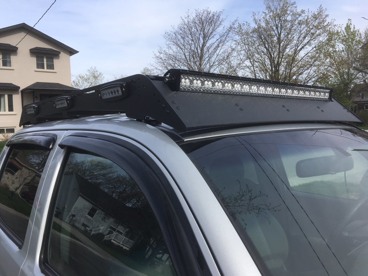

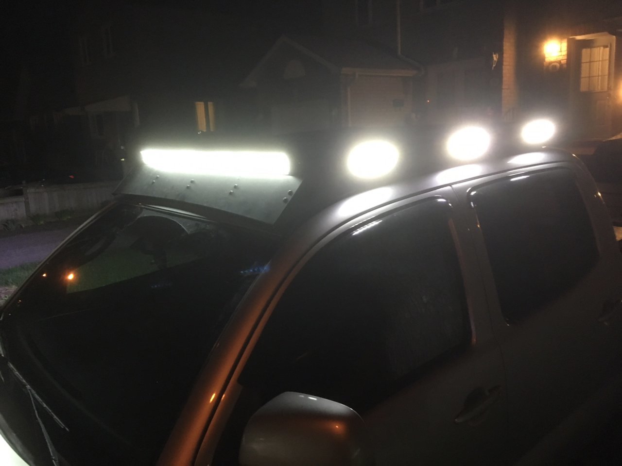

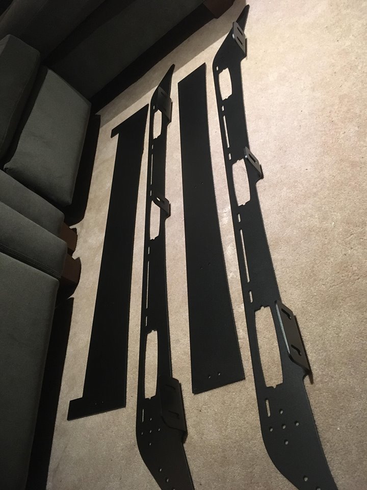

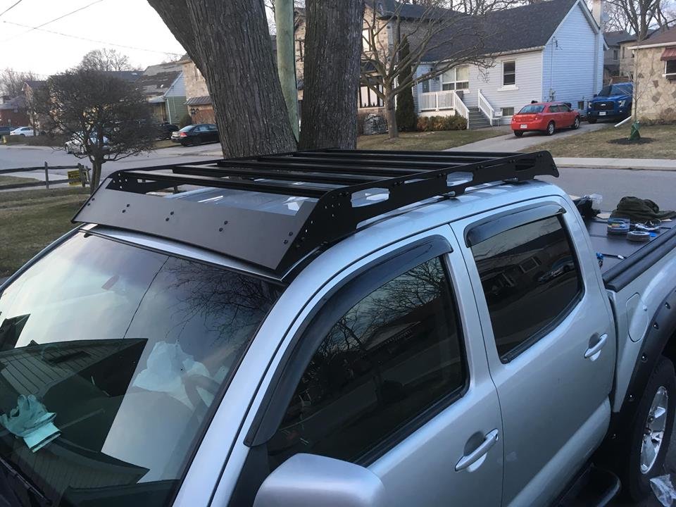

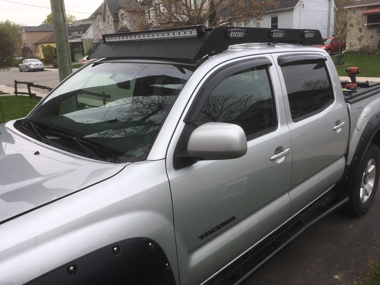

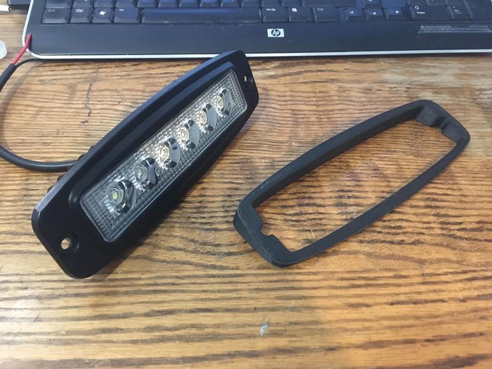

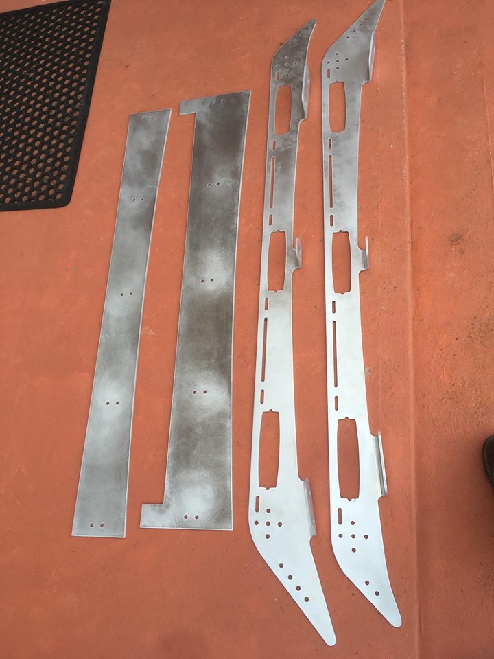

    Finished my roof rack project today. Started the design in Adobe Illustrator, transferred the design to AutoCad, and then sent that to the Laser Cutter. I designed the rack specifically to fit these flush-mount led lights I bought on Amazon. The rack had 3 cutouts on each side so the lights can sit flush with the surface of the rack, and recess into the rack. I 3D printed these spacers that are the exact shape of the flush-mount lights, and sit behind the lights to tilt the flush-mount leds on a 15 degree angle to provide better light output on the ground surrounding the truck.

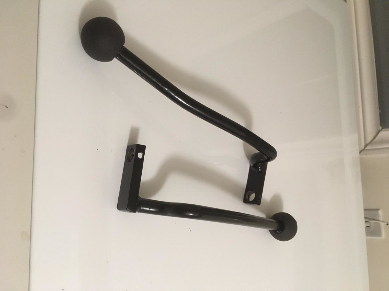

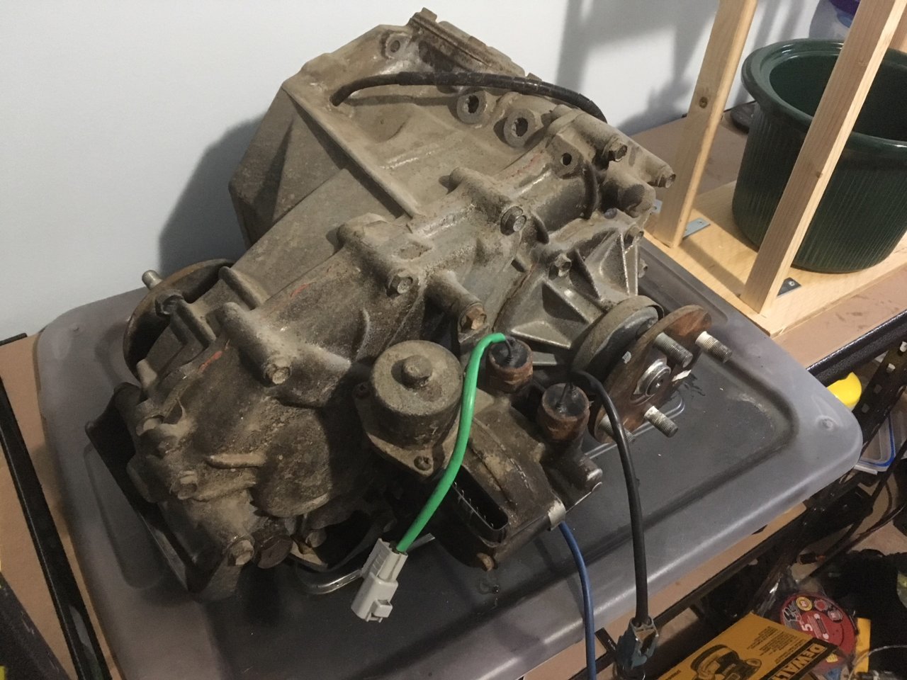

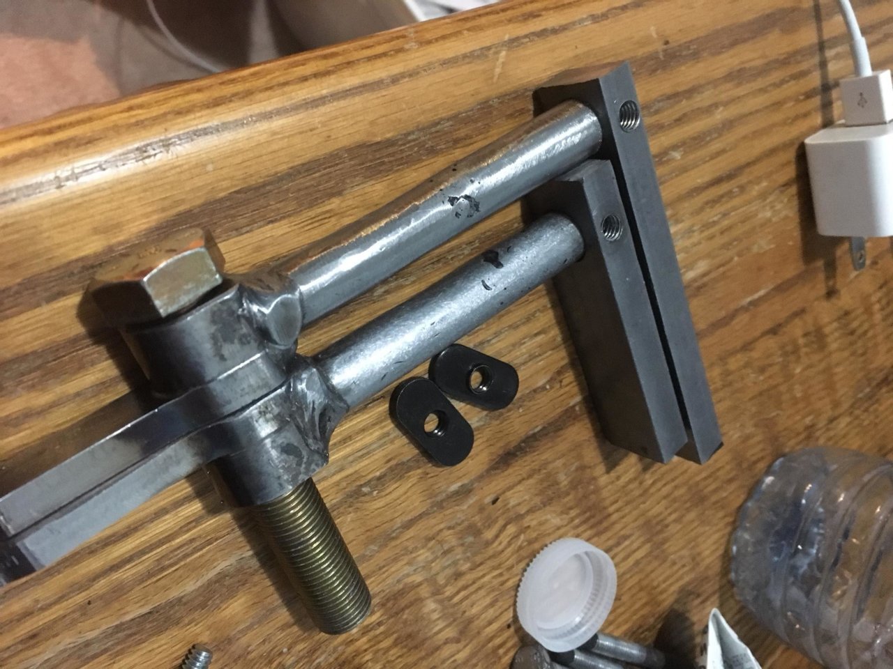

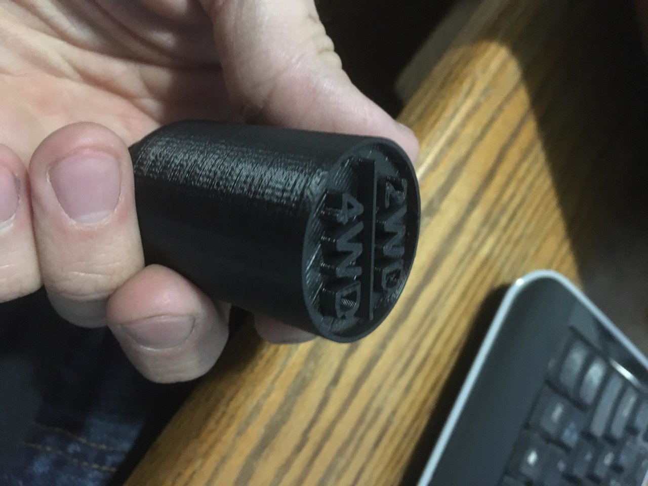

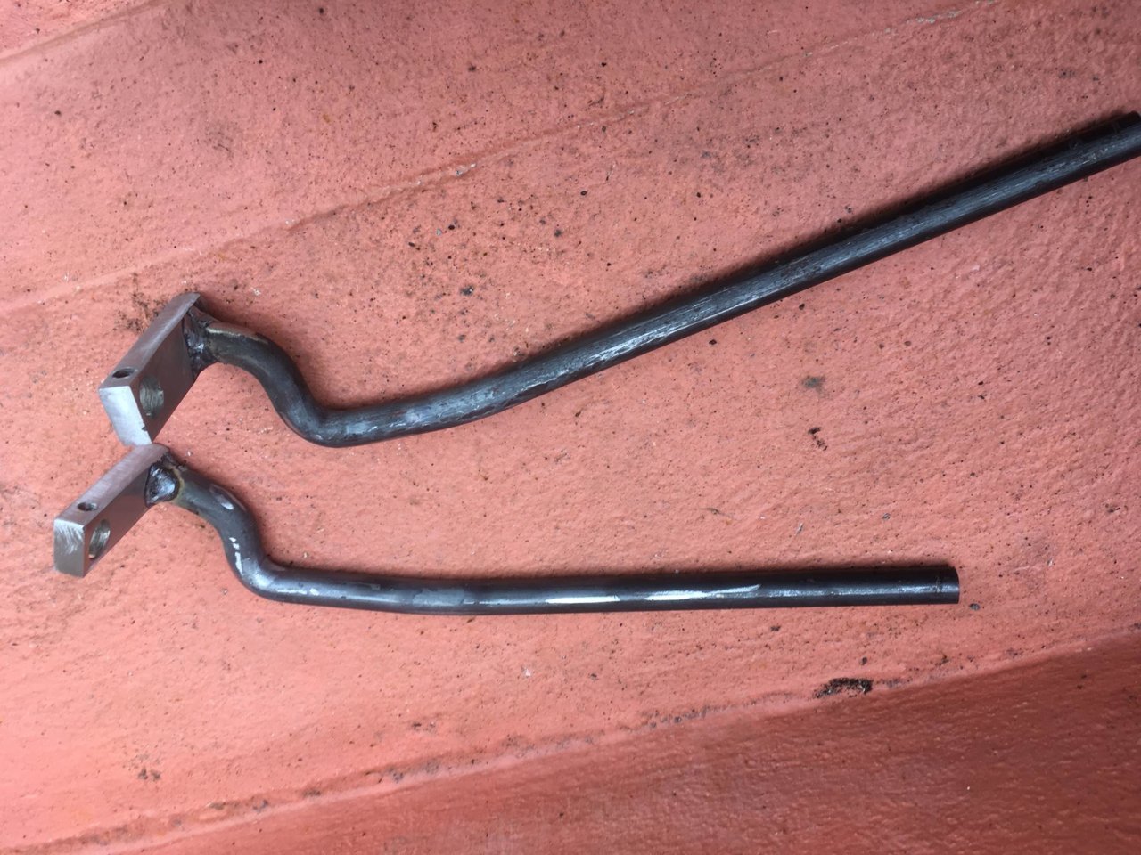

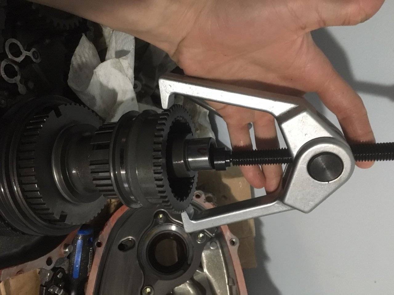

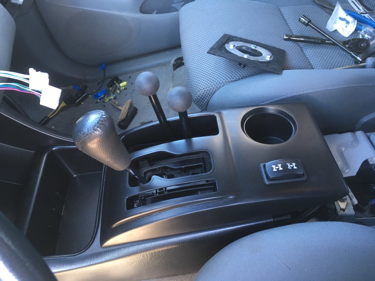

    Here are some pictures from my most recent FJ Cruiser transfer case swap. I modified the case to accept twin stick shifters. It was a ton of extra fab work, but turned out really nice. I started off with a Twin Stick setup from Front Range Offroad, and cut down the shifters and modified them to pop up in the correct location in the shifter bezel. I painted them with POR15 and tapped the ends for 1/2"-13 threads. Im now working on a 3D printed shift knob for the twin sticks. The knobs that Front Range provided are just simple black circles with no indicator on them. So I 3D printed a test knob which indicates 4WD or 2WD and I will make another one for Low range and High Range gearing. I intend to clean these up, sand them, and paint them.

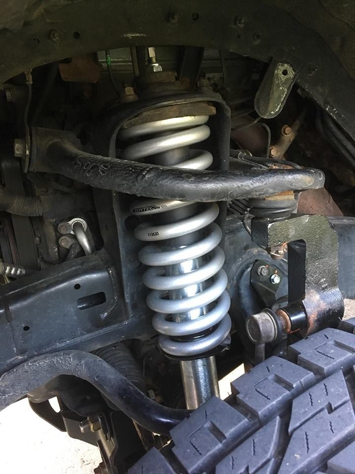

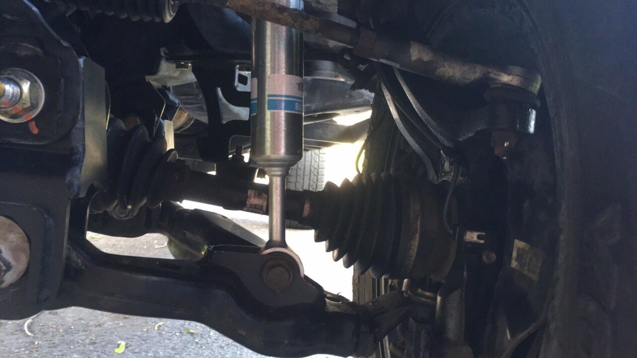

    Finally got my 6" BDS drop bracket lift back on. Went from stock/no suspension lift to 6" BDS lift with Toytec coils and extended Bilstien shocks up front. No coil spacers this time around. Took some measurements pre and post-lift. Measurements were taken from center of the hub to the bottom of the fender flare. CV angles look good.
    Running 6.5" of suspension lift in the front, with 6" of lift in the back. I also have a 1.5" body lift all around, totalling 8" of lift. Truck sits fairly level other than the lean on the rear drivers side, which im still trying to figure out why its happening (it happened way before the lift).
    PRE LIFT:
    Front Left ----- 21"
    Front Right ---- 21.5"
    Rear Left ------ 22"
    Rear Right ----- 23.5"
    Front Diff Clearance ----- 9.25"
    AFTER LIFT:
    Front Left ----- 27.5"
    Front Right ---- 27.75"
    Rear Left ------ 28"
    Rear Right ----- 29.5"
    Front Diff Clearance ----- 11.5"

    Nice! Lean is due to has tank on drivers side. You just need to add a small spacer / trim packed and that should fix it for you. Nice work though. How's riding before and after?

    I have a trim spacer. Theres something else funky going on. The leaf springs arent the issue either. Lean is there whether gas tank is full or empty
    Just finished today so ride is stiff in the rear from the AAL, but will soften as I load up the bed a bit. Front is smooth as butter from the new coils and shocks. Ive now gone from Stock to 6" lift with giant coil preload spacers, back to stock with 1.5" Body lift, then to 6" Lift with coilover front and no preload spacer. So ive tried a lot at this point. The preload spacers I tried previously were insanely stiff the first day then softened out over the course of about a week. But were still fairly hard riding for a while. Im eager to see how these ride in another day or two

    Hmm, wonder what would give it that lean still?
