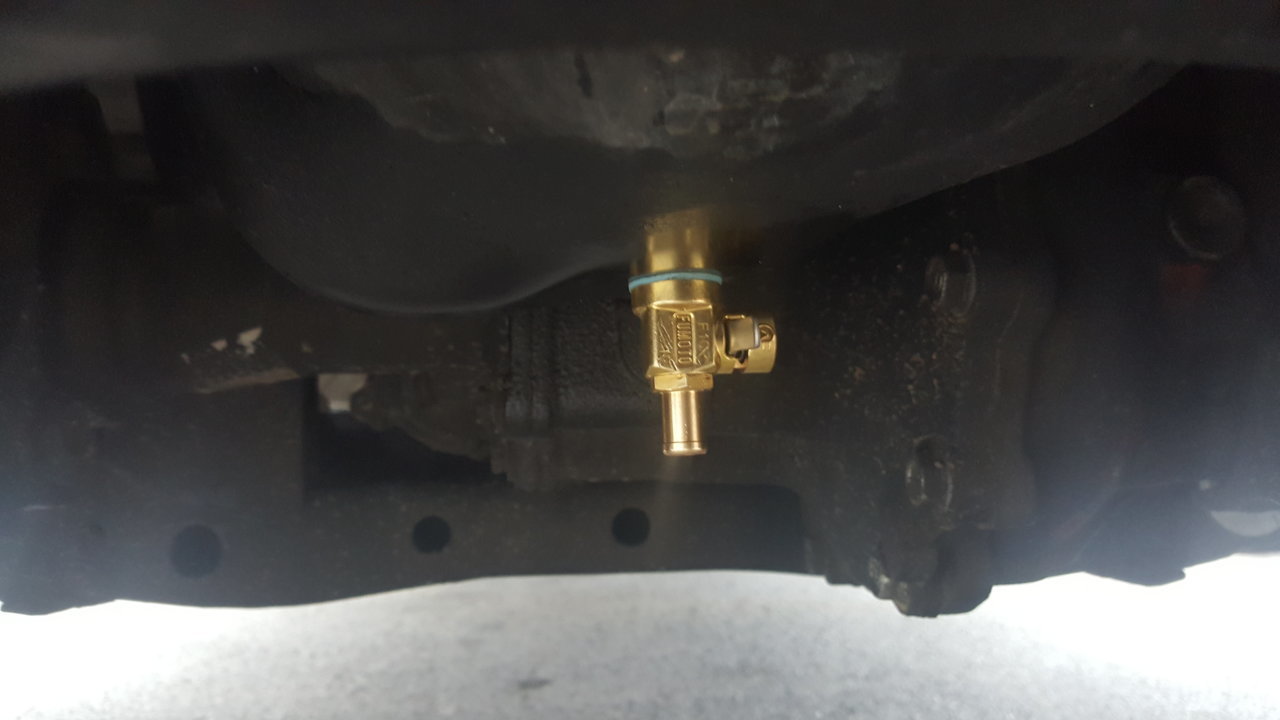

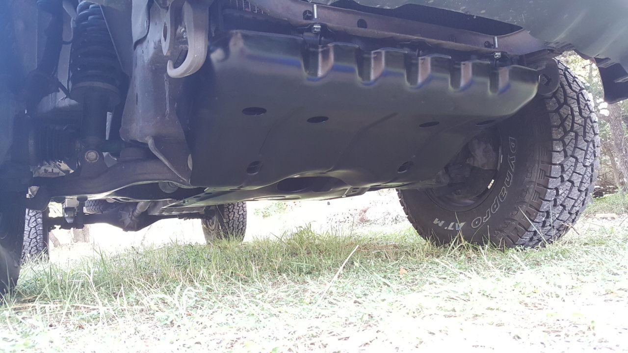

    I finally ordered the oil drain valve and installed at an oil change.
    VERY happy with build quality, no complaints after a month, feels skookum as frig.
    Link:https://www.amazon.com/gp/product/B003UT822G/ref=oh_aui_detailpage_o07_s00?ie=UTF8&psc=1
    Once the drain plug was on I needed to re-finish my skid-plates due to a few rust spots and looking a little weathered. I hit them with some scotch-brite and wiped them off. Flat black outdoor spray paint went on them after that.
    Cleaned off real good
    Painted and installed!
    Drain plug is nice and protected now!

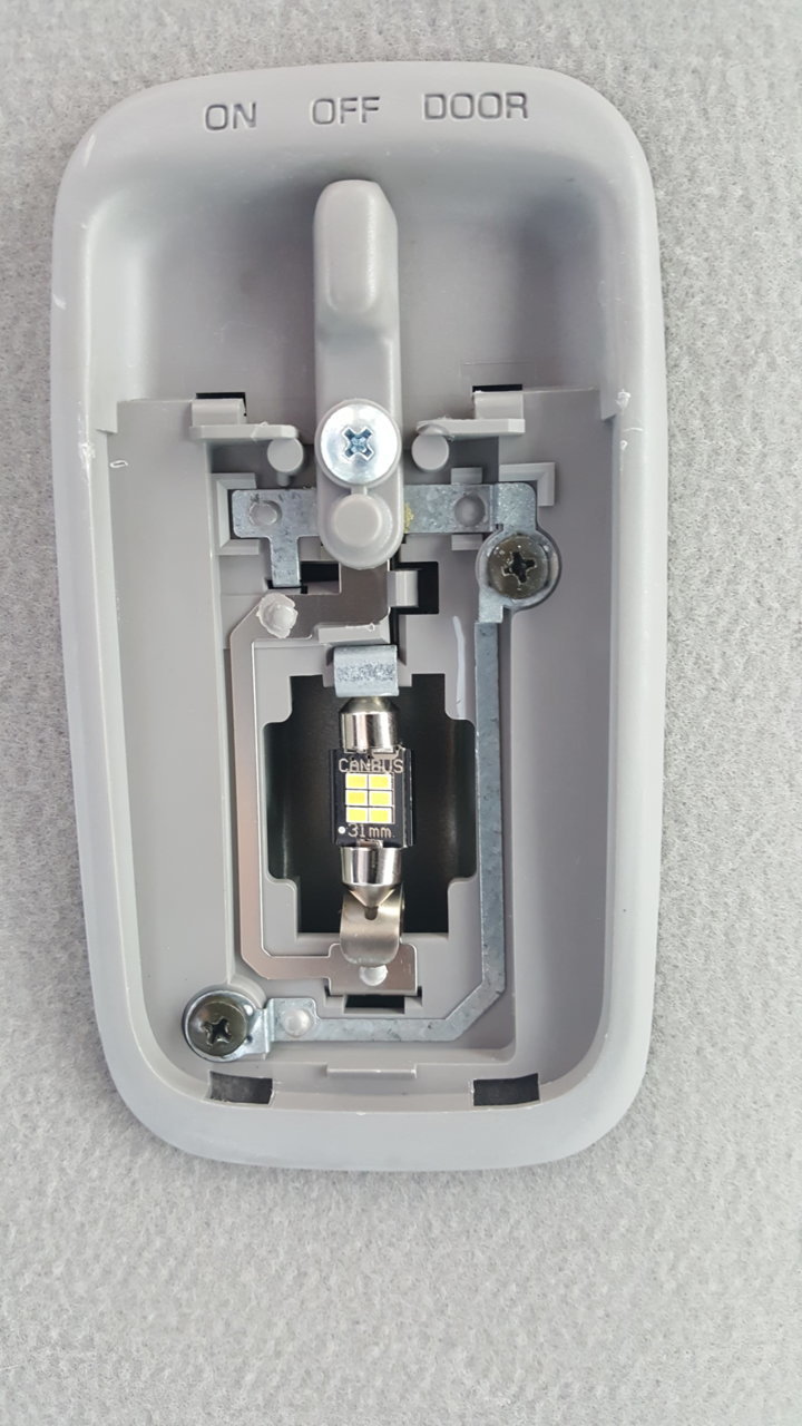

    I Replaced the incandescent bulbs in my interior overhead light and my reverse lights with LEDs.
    No pics of reverse lights, I lost a few of the skid plates too. I'll take some in the dark soon.

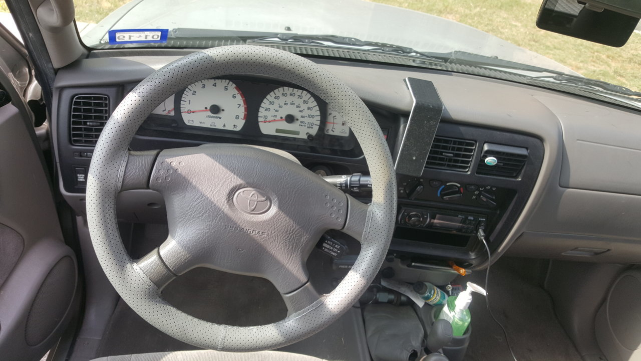

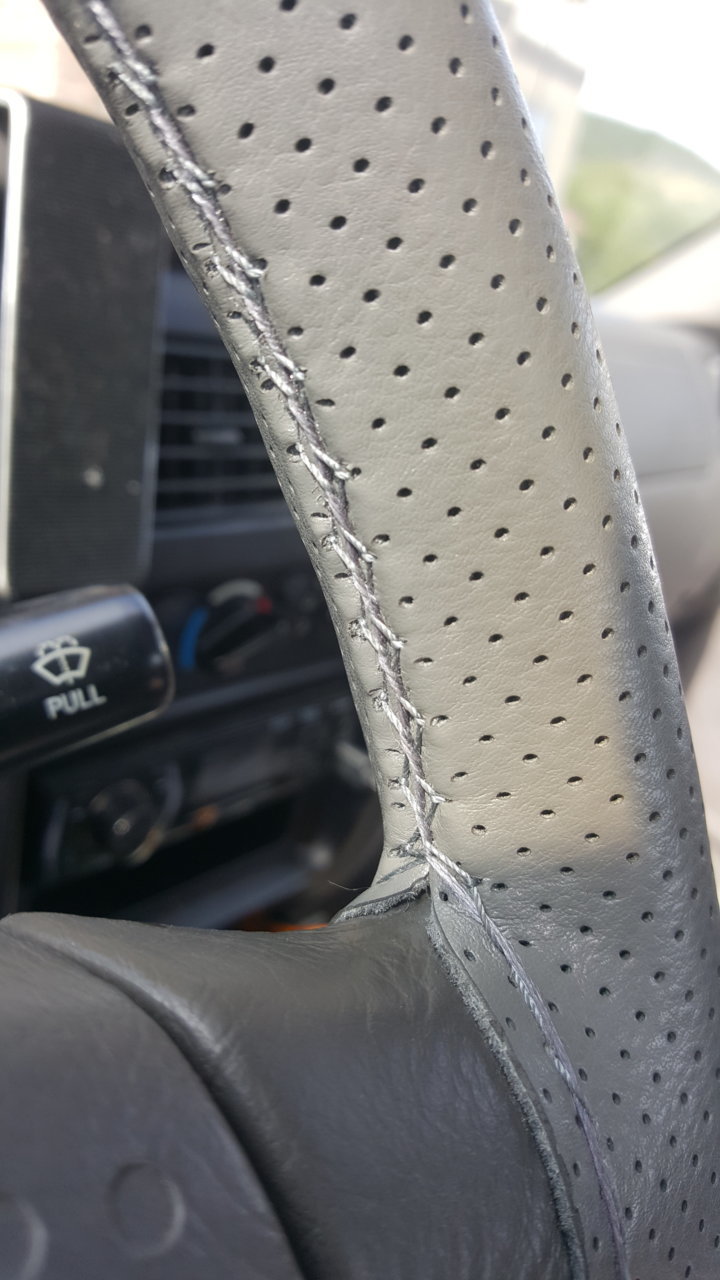

    The Steering wheel cover was stitched on one weekend (took nearly 2 hours! :annoyed:)
    Also added Velcro phone mount to dash.
    Came out nice, Good quality leather, better grip, Perfect fit.
    TIGHT stitches. :bananadance:
    Link:https://www.amazon.com/dp/B018FM55UE/_encoding=UTF8?coliid=I3AVPGFE2RP91D&colid=2EGBS78WQLTDP&psc=1

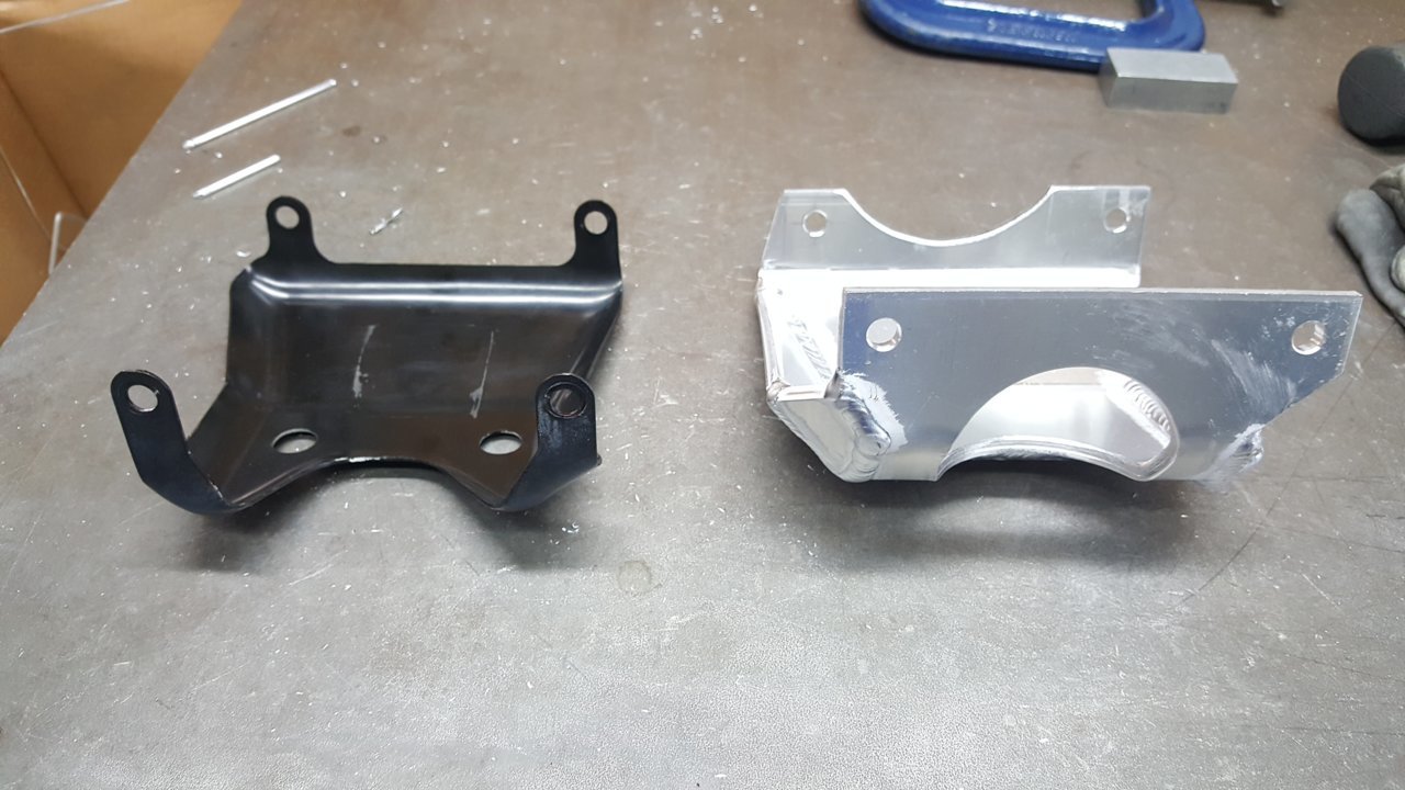

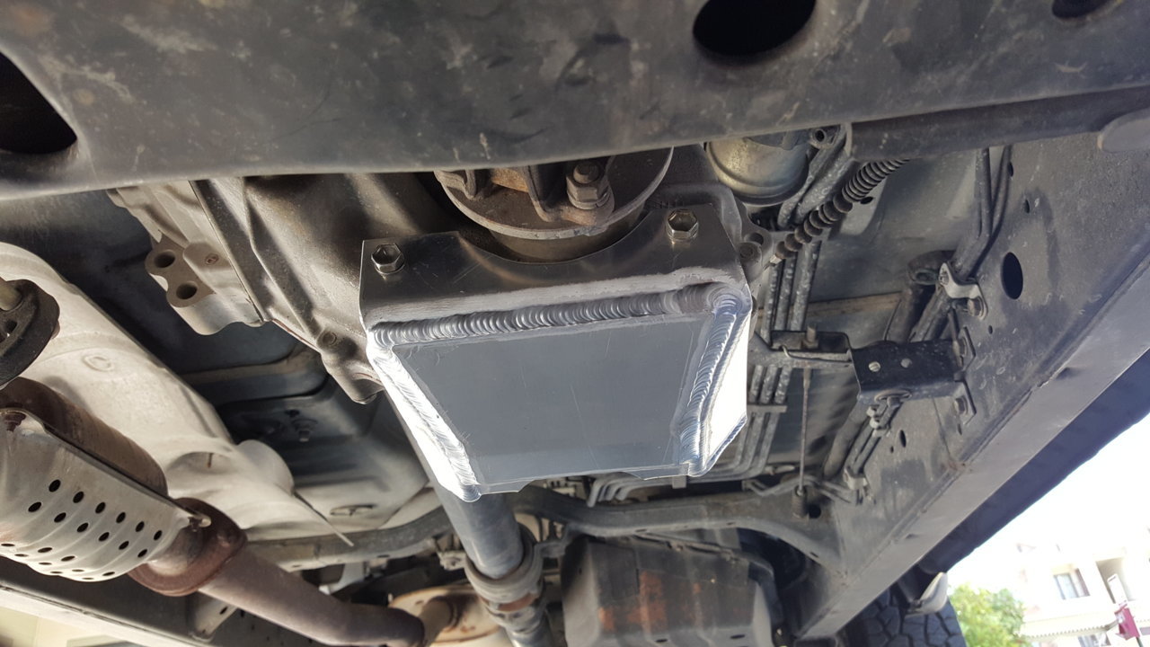

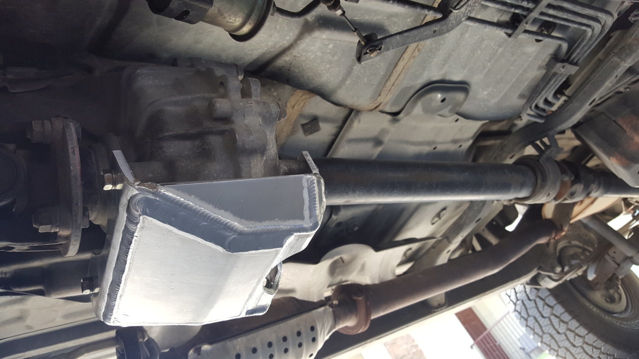

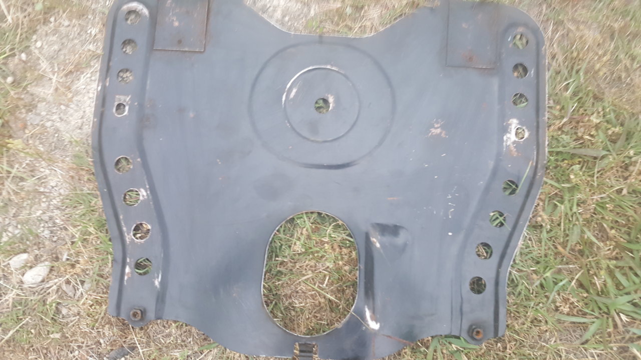

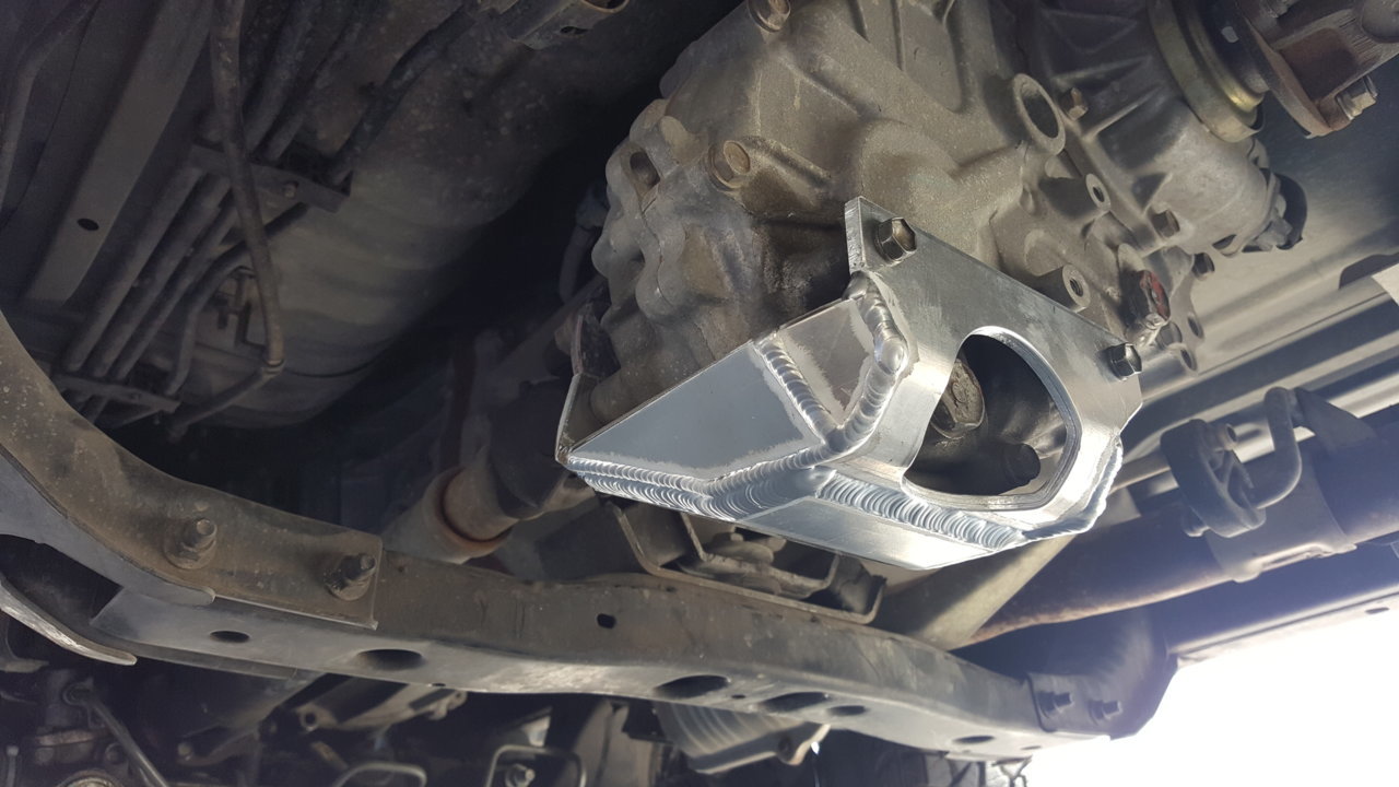

    Finally the best mod I have done lately...

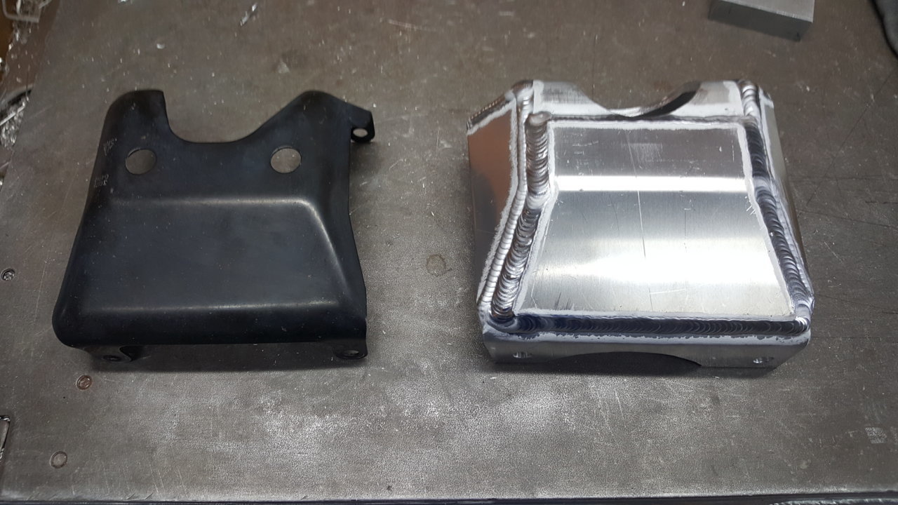

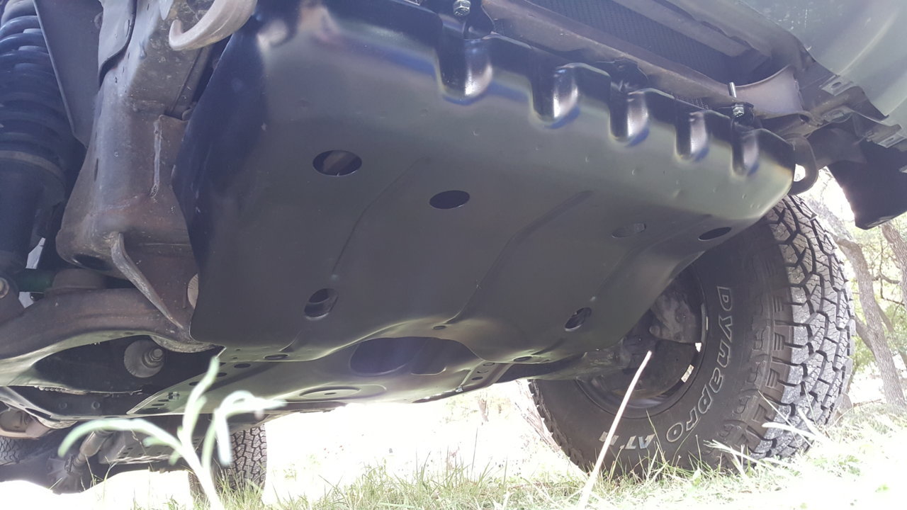

    Custom aluminum transfer case skid plate!!!
    Compare to the OEM 1/16" steel plate....
    1/4" 6061, doubled up on the face for a total of half of an inch of aluminum on the bottom, TIG welded at 350 amps, inside and out, 2 hours of fabrication and fits like a glove!
    I'm very proud of this mod and really love the way it looks. I would build these and sell to friends if I had the time/money to do so. Super easy and fun to make.

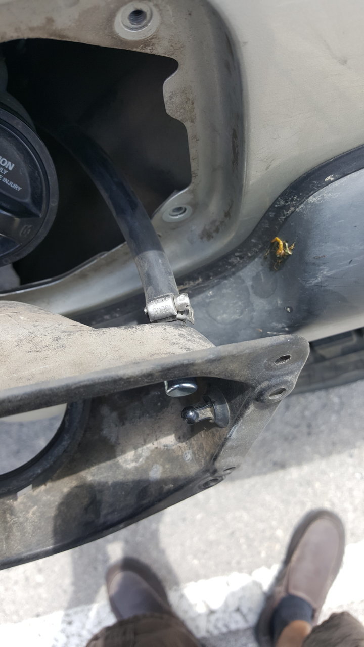

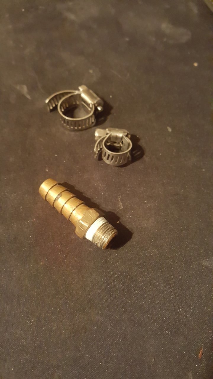

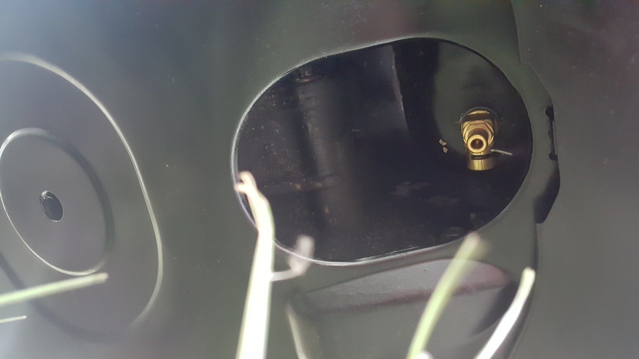

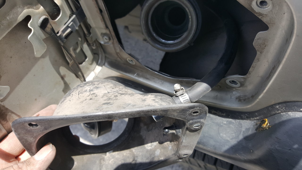

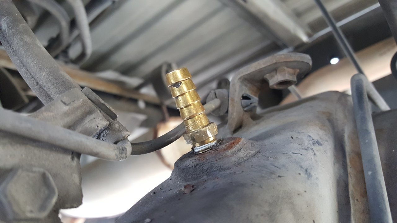

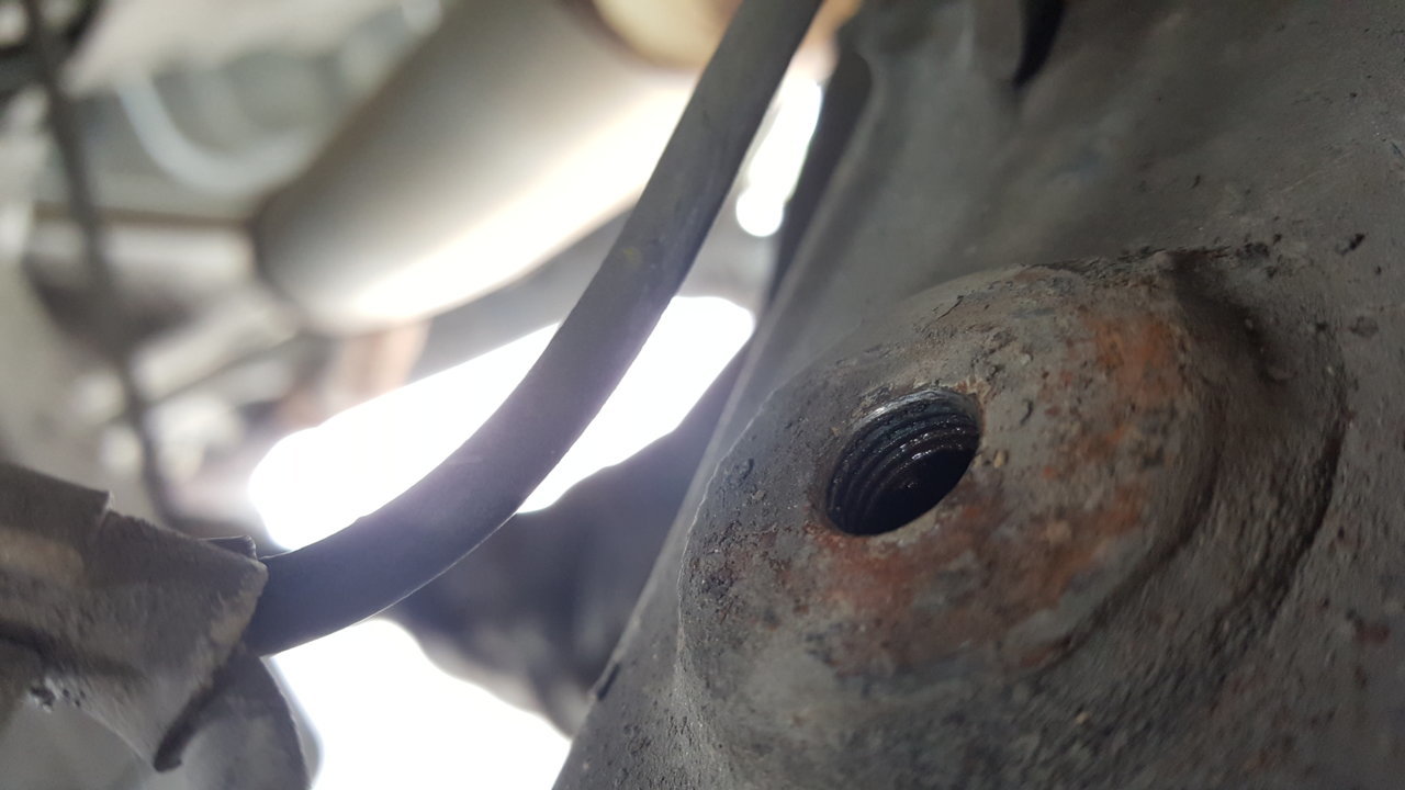

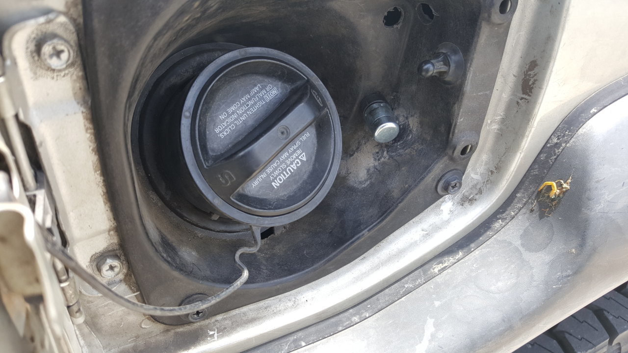

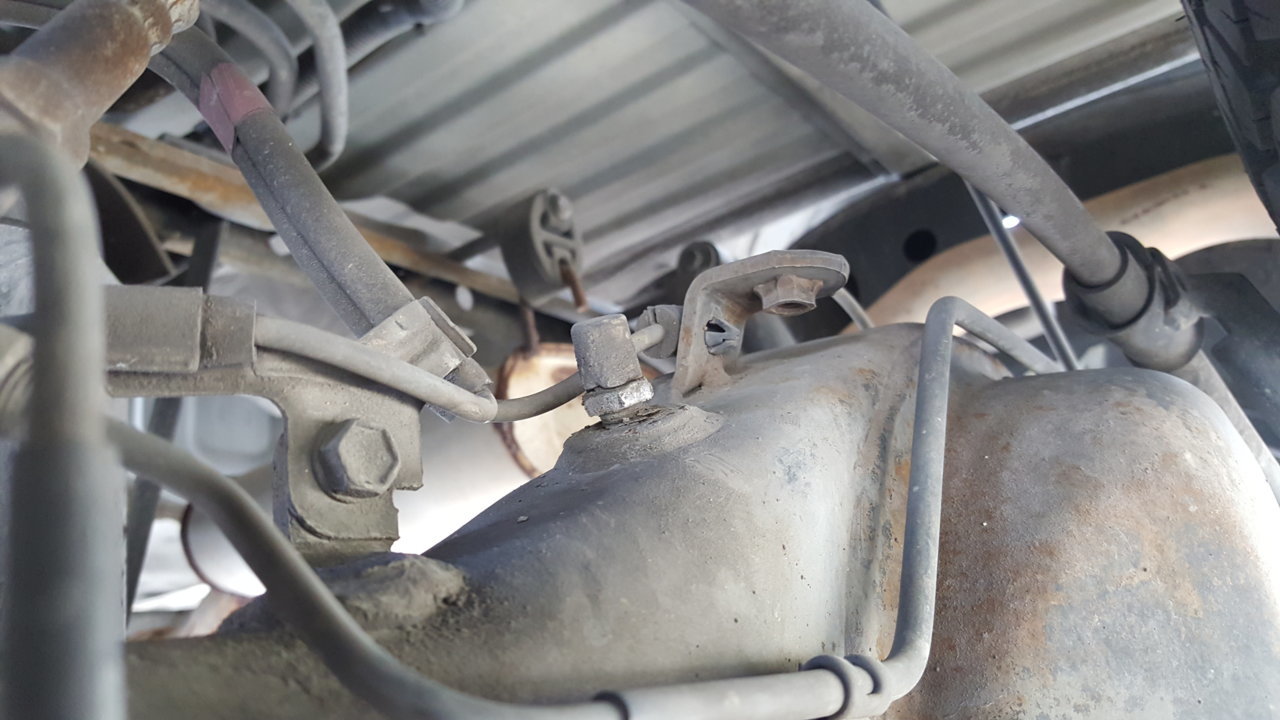

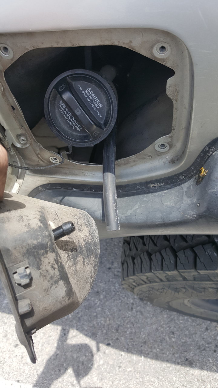

    Last weekend I did the Diff breather mod, It was an...experience...
    Parts:
    I found these in a random tool box with my tools, Free parts!
    Ordered this from Amazon: https://www.amazon.com/gp/product/B06XHBY38X/ref=oh_aui_detailpage_o04_s00?ie=UTF8&psc=1
    Picked up 6' of rubber tubing (not fuel line) for $6 @ Orileys

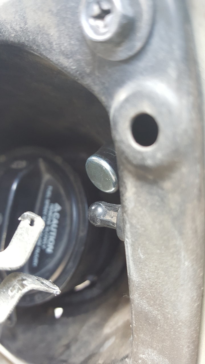

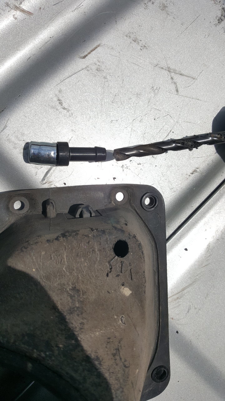

    Install:
    I made sure to give tube some slack for flexing and dropping suspension parts later, followed brake line to wheel well with zip ties.
    Went up the fuel tank neck and then poped off the cover and took a 5/16 drill to it.....
    Hole drilled, pushed in the breather and hose on the interior, clamped it.....
    Wait.....
    ....Shit.....The door bracket hits the breather and you can't close it at all......
    Ok...I'll relocate...
    90 degrees over on the other wall.
    I went to put it in and it conflicts with a metal bracket thats hidden behind the finder panel.....
    It will NOT fit again
    SHIT!
    ok. well I'll get it eventually.....
    Finally got it right...
    I'm an idiot sometimes.
    :frusty:

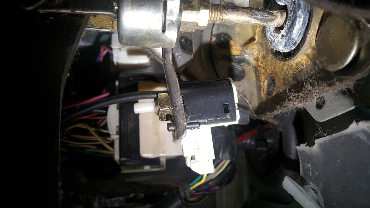

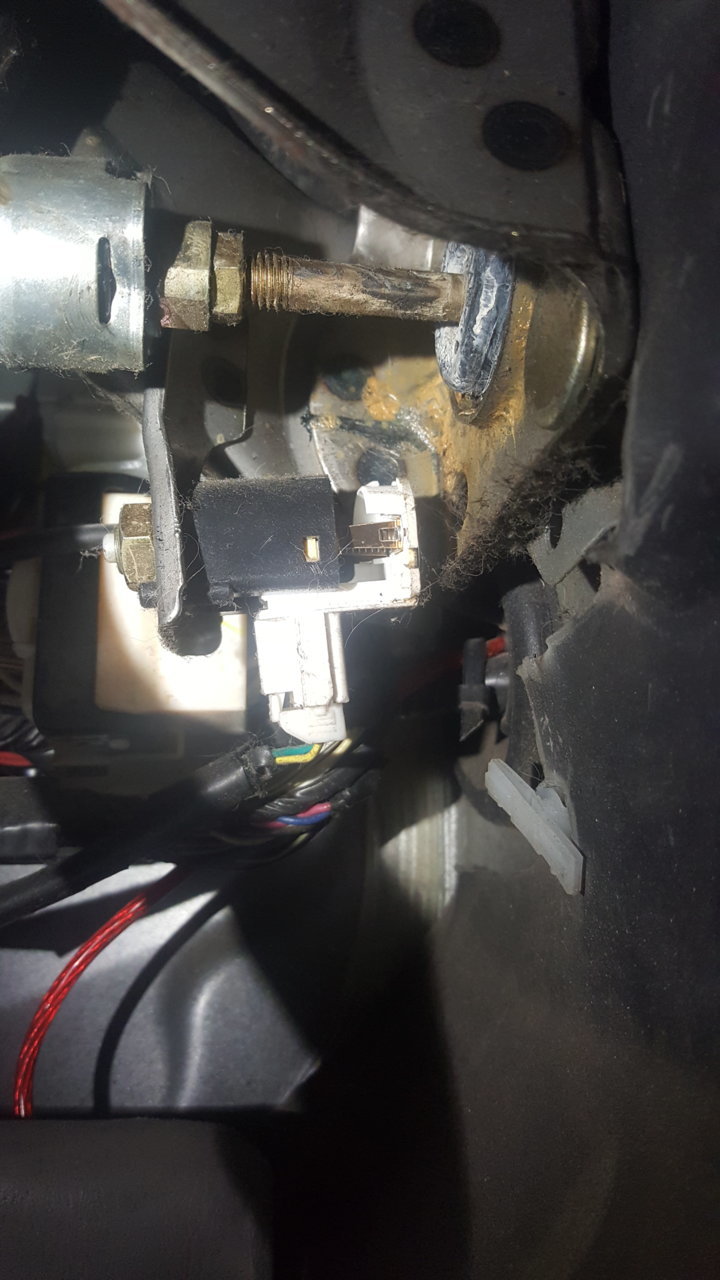

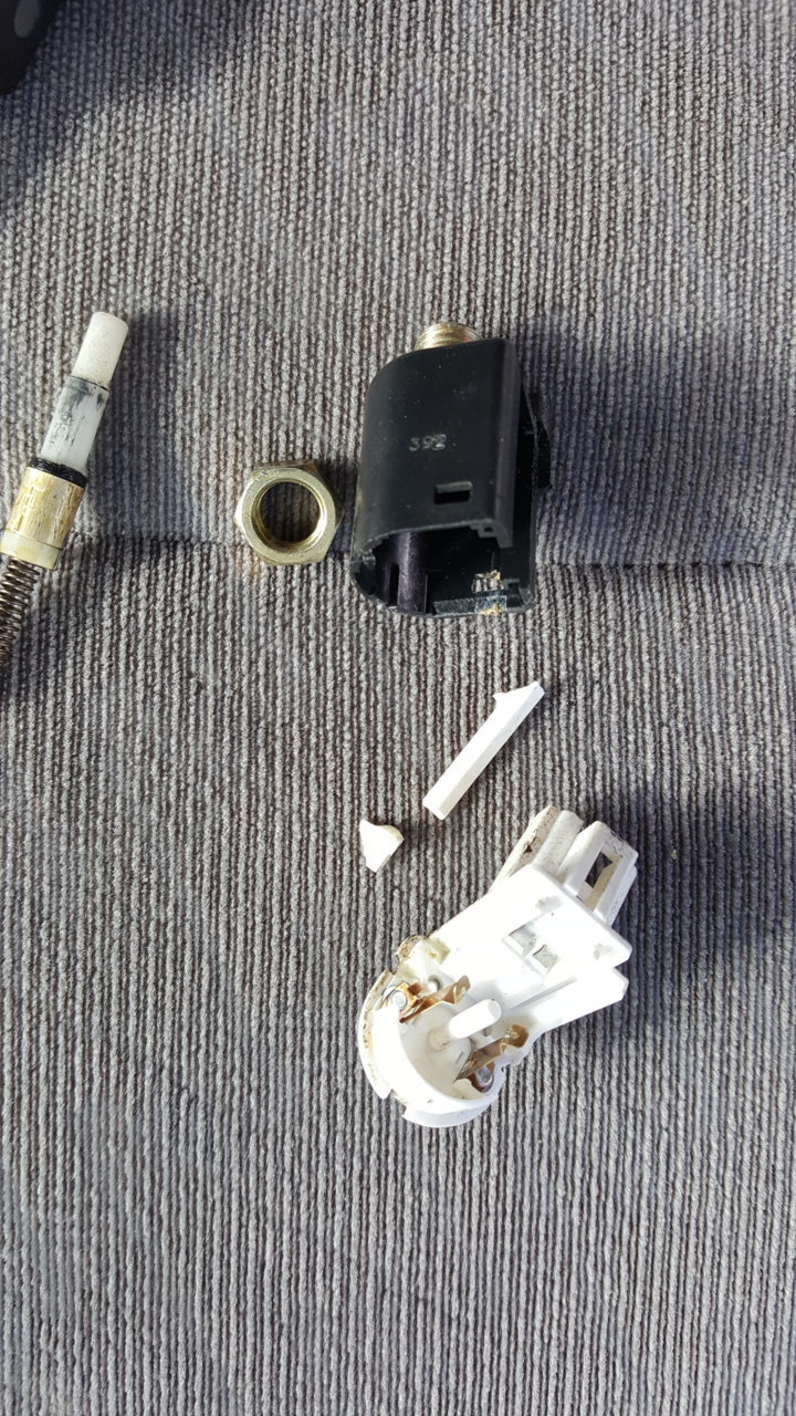

    One day last week I could not start my truck... The only way was the clutch start cancel button...So I knew something was wrong with the clutch start plunger switch...
    Ahhh, there is the problem the switch was pushed out of it's self while driving....
    The white rail and clip broke off allowing the entire assembly to separate and disassemble.
    Price online:$30-50...
    For a simple plastic plunger switch that cost less than a dollar to produce.
    NOPE!
    I took all the parts and scrubbed them with a old toothbrush and alcohol to remove the grease, then re-assembled after mixing up some epoxy to keep the body together.
    Fixed!

    If you plug in a LED bulb into your stock incandescent Dome mount, does it create any error code? I am in a 2006, 2nd Gen if that would make any difference? And i don't want to spend $5-15 on a bulb IF it's going to make issues... Thanks!

    I have 0 issues with my LEDs, but I have heard that useing LEDs for blinkers causes them to blink fast due to less draw detected and your truck thinking a bulb is out. As for the dome specifically I doubt there is a problem with useing LED. Take what I say with a grain of salt however, our trucks are very different and I would suggest searching for it here on TW to see if anyone has issues with their 2nd gen dome light LEDs.

    I don't believe the 2nd Gen Tacomas have error codes for Dome lights, but the simplest way to check without getting a replacement you may or may not want to keep is to try pulling a bulb out and see what happens. If you get an error code, then you're going to need Electrical Load Resistors if you want to replace them with LEDs. If there is no error code, you should be good to go.

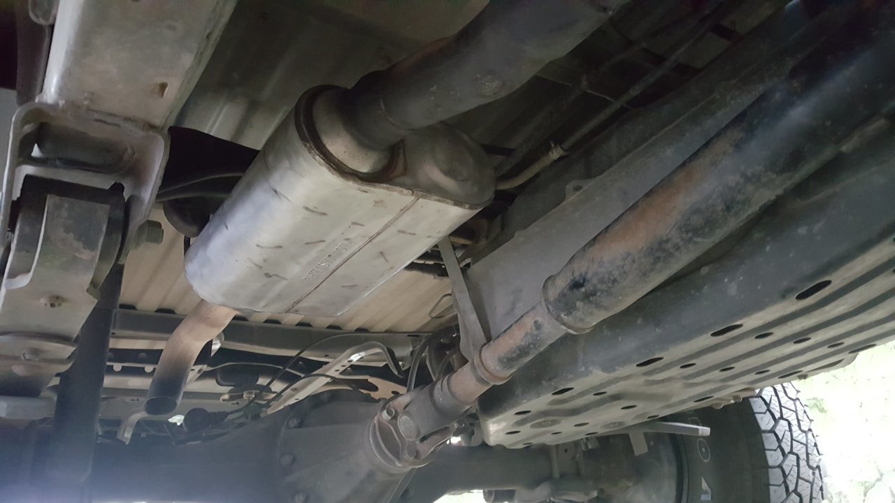

    1. Used Flowmaster 40 series muffler swap. (soon)

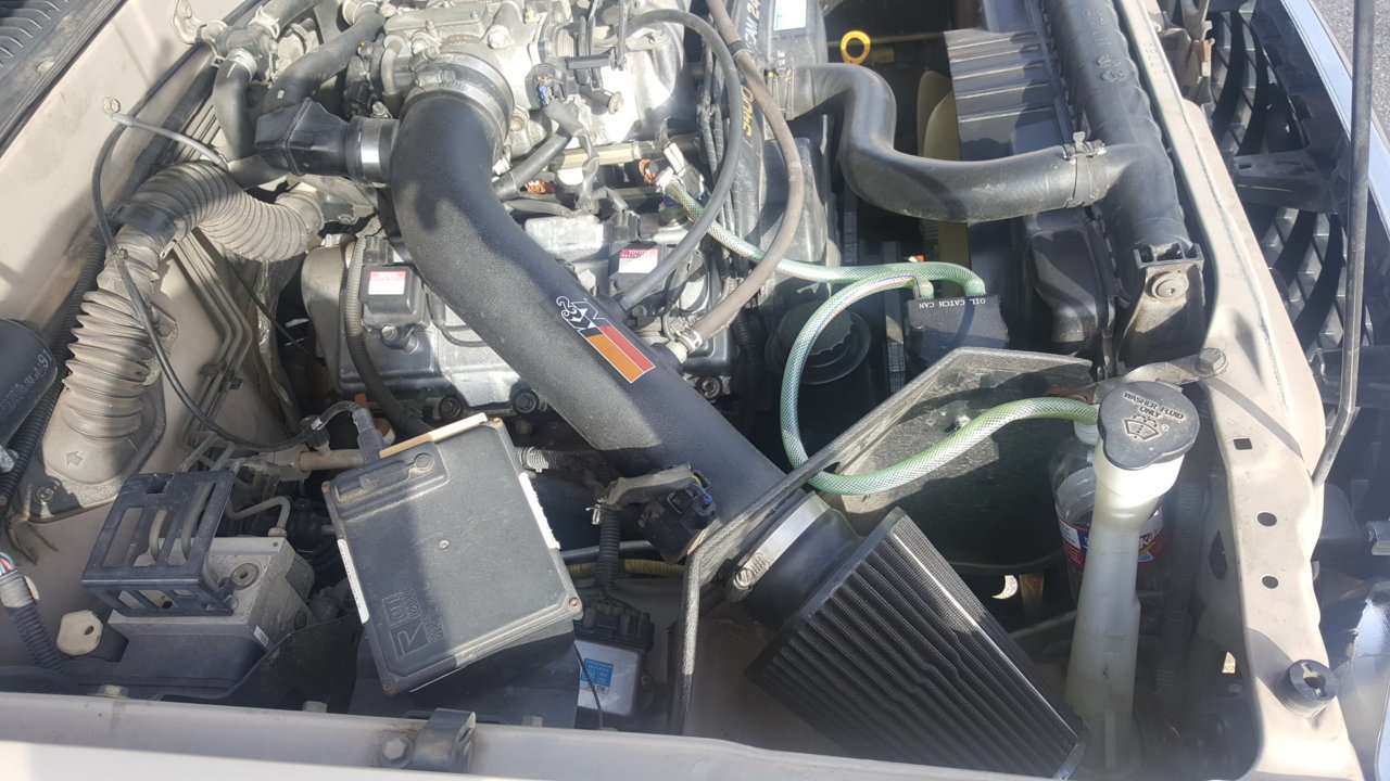

    So far I have done a valve cover gasket job, replaced the aftermarket valve cover with OEM on the passenger side, and cleaned spark plugs. It was my 2nd valve cover job and everything went smooth. Got it done in about 3 hours taking my time and having to re-do the entire vacuum tubes to/from the air intake/throttle body. The previous owner really had no idea what they were doing when installing the K&N filter and mixed the lines up and used the wrong hoses...
    Yes, Yes that is a water hose going to a water bottle and not back to vacuum...no, I have no idea what the hell he was thinking... It ran a little weird and had a lag to it when driving...I wonder why...
    Once fixed my wife noticed an immediate difference in the throttle.

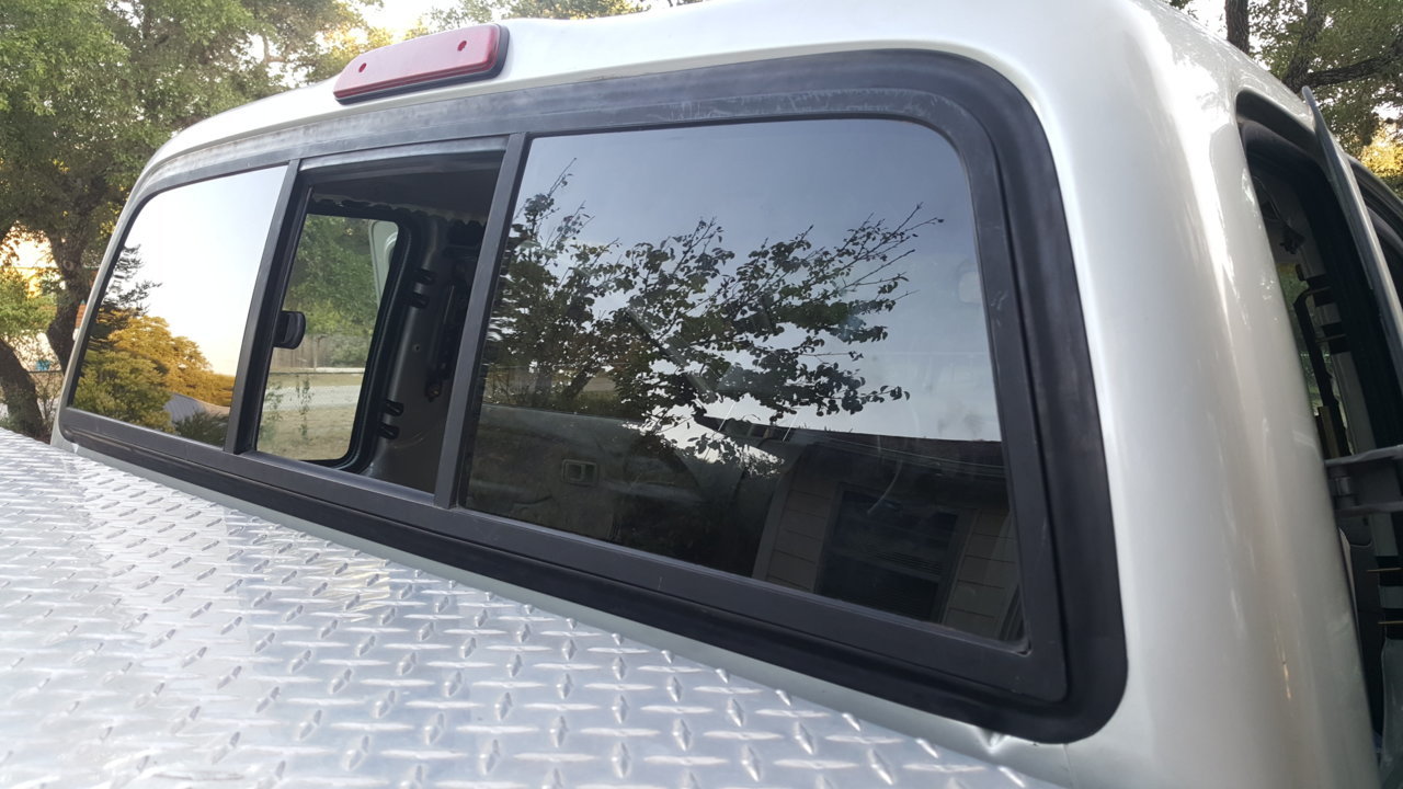

    I scored a pristine sliding rear window and replaced my old solid window. (for sale)

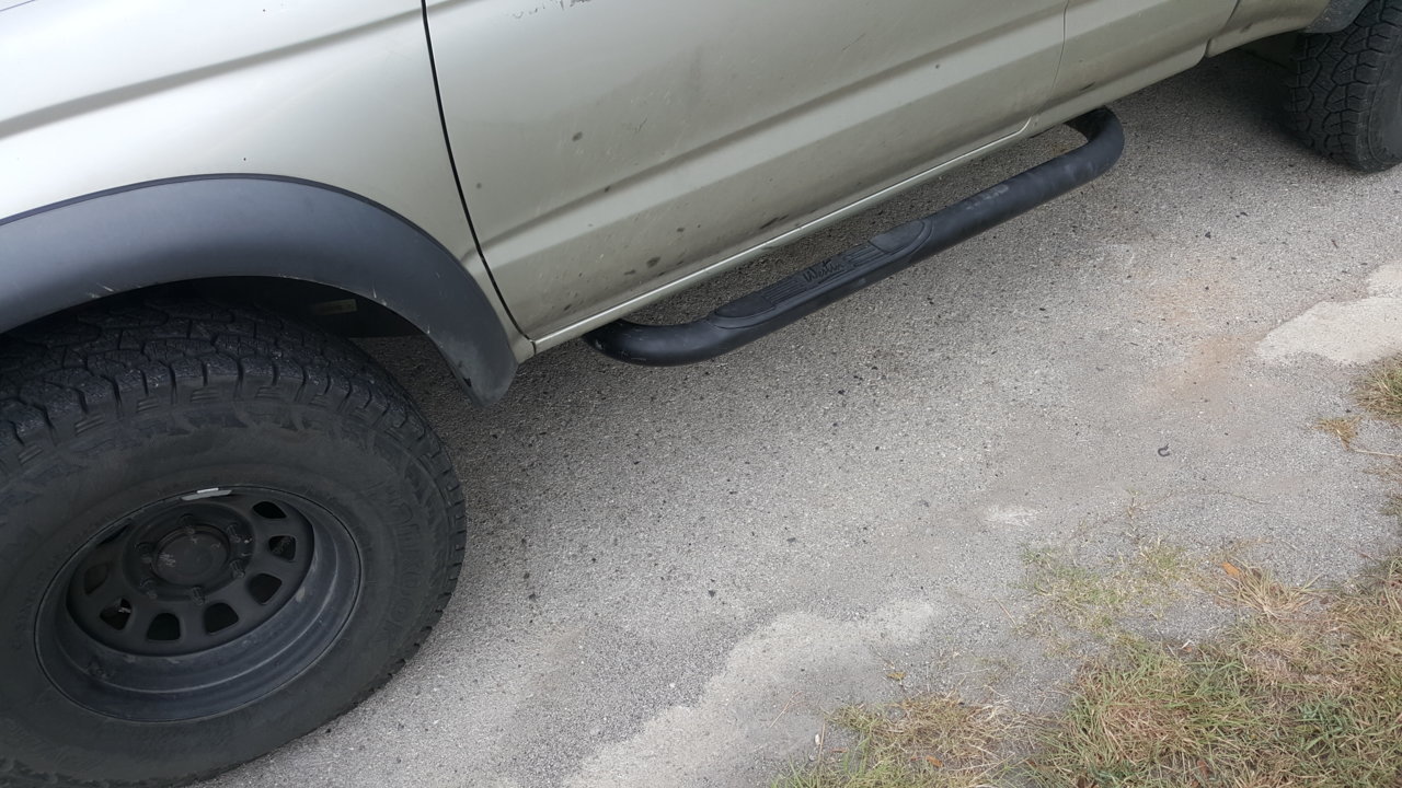

    Installed some Westin tube steps as a crap temporary alternative to real sliders.

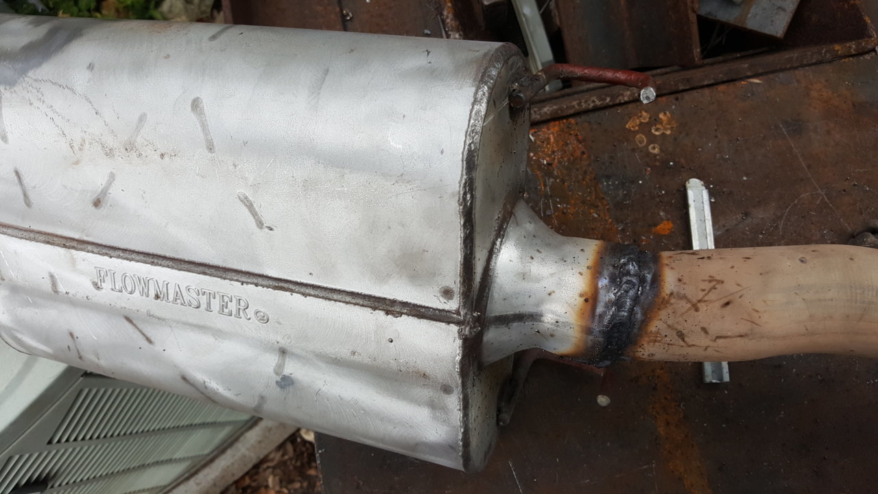

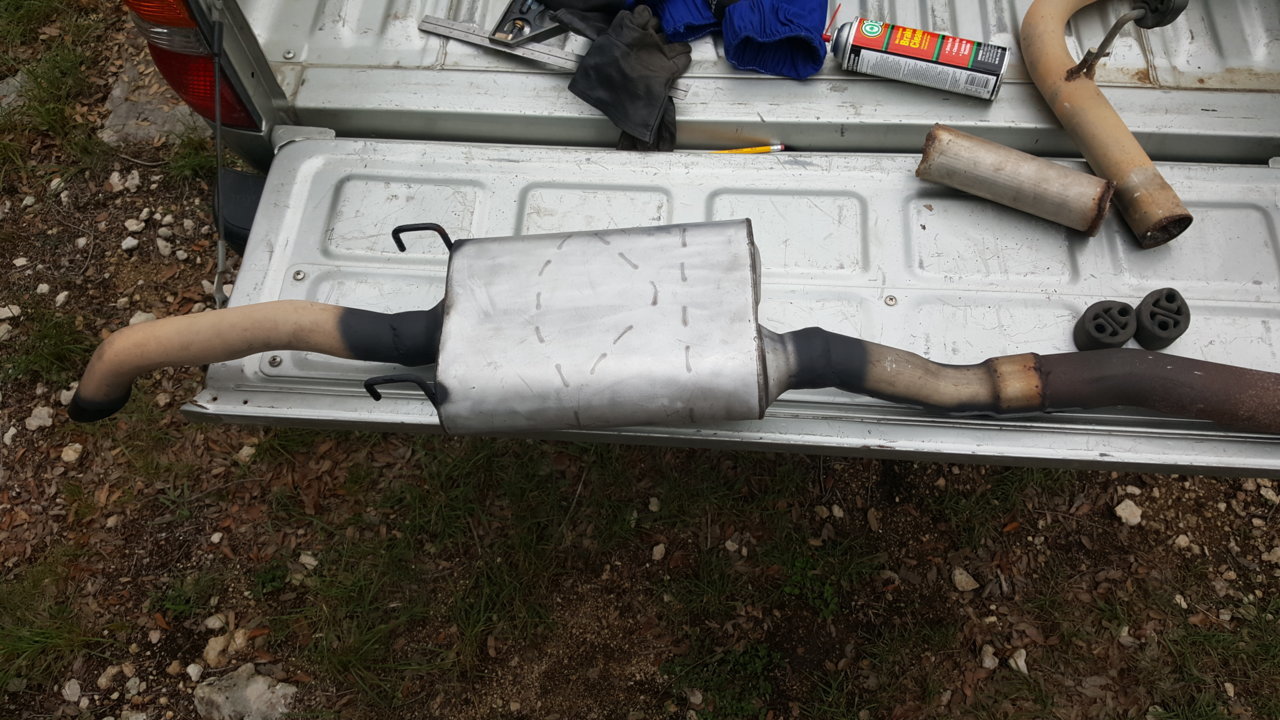

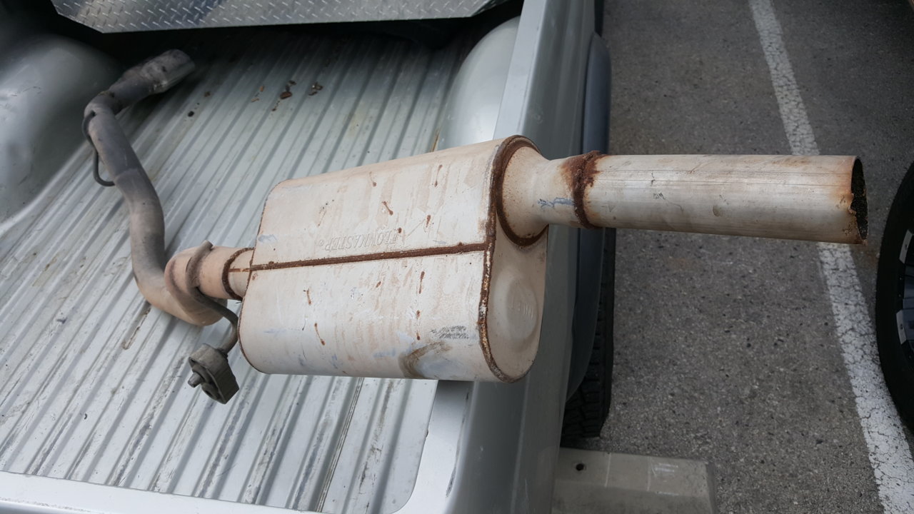

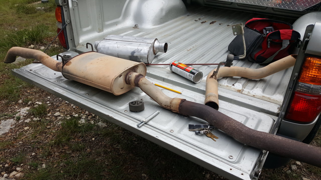

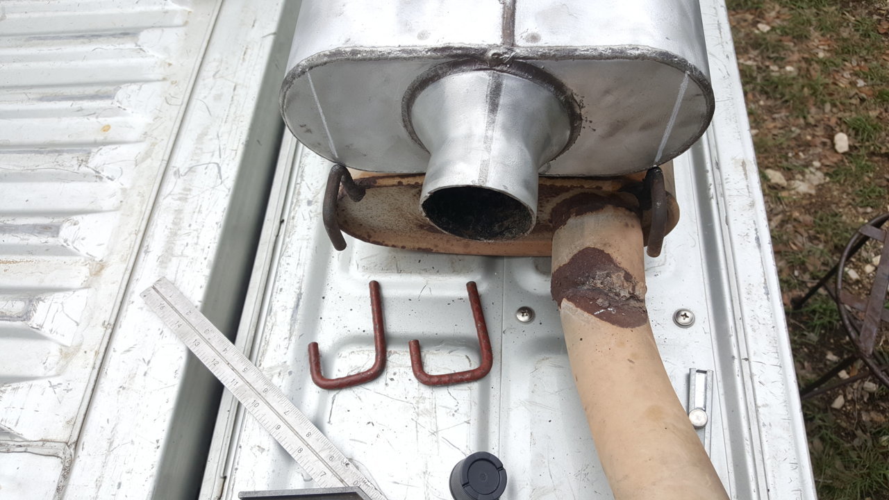

    I replaced my rusted Dynomax muffler with a Flowmaster 40 series today.
    The old:
    Rust was eating the seams and if it didn't leak...it was about to.
    I picked up a full exhaust from some dude on the Letgo app.
    It cleaned it up good with an angle grinder brush.
    I welded on some hanging bar.
    Then cut the tubing from the old muffler and welded it on.
    Cleaned the welds good, and put a thick coat of high-heat pant on all welded surfaces.
    Install was easy enough, I just made sure to copy the hanging locations and keep it level and straight.
    Just now test drove it, Here are my thoughts.
    It's very quiet at idle and at light throttle with a deep bass but still not too loud at all.
    A nice low growl comes out at medium revs with higher tones in the background.
    At a good peak around 4k-5k RPM there is a bit more noise and an even deeper tone that is met with increasing higher raspy tones but still not loud enough to wake the neighborhood.
    Performance seems to be the same as my old one, there is no noticeable increase in HP from the few launches I did. I wasn't expecting there to be so I'm not disappointed at all.
    It was more of a maintenance job (due to rust) and minor upgrade in sound aesthetics.
    Overall, I'm very happy with it, not too obnoxious and loud with a nice volume, however not the exhaust system I really want.
    There are plans for a proper full stainless exhaust rebuild with wrapped manifolds and a cat back system in the future. Right now there are more pressing things to maintain however.
    Thanks for stopping by and looking!
