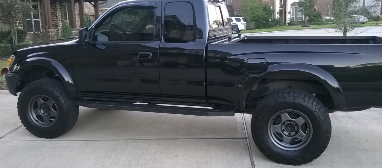

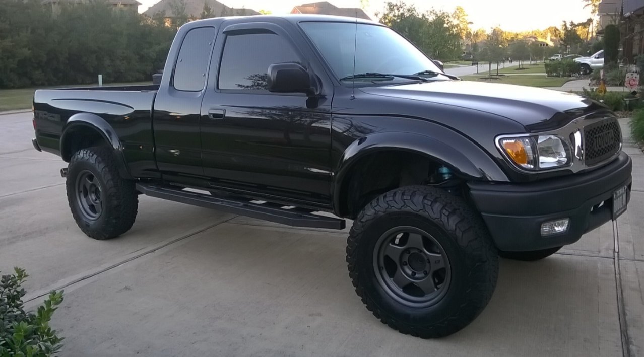

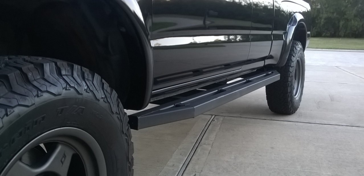

    Hi Tango,
    Welcome in! Just wanted to present another option I found in lieu of nerf bars that serve as sliders as well. My kids had a tough time getting into the truck and got the Demello Rockcrusher Sliders. They have bolt on and weld on options, serves as a great step up and keeps you off the rocks (and shopping cars/car doors wont ding you either :thumbsup:)
    Not affiliated with Demello, just a happy customer. Good luck with your choice and post pics!!

    IMO, don't get anything that's mounted to the cab (oem style running boards/nerf bars) if there is ANY chance you'll go off road with it. I've seen people royally mess up their vehicle hitting their running boards on a rock.
    You don't even have to be rock crawling or hard off roading for a rock or a log to flip up and tag you real good. I went wheelin with a friend with a nearly identical truck but he's got factory running boards (I don't have anything, yet). We were seriously on a nearly flat fire road, and I tagged my rocker panel with a log that got flipped up by my wheel, he (luckily) managed to avoid it, but I'm pretty sure if he would have hit it the way I did, it would have caused more damage than what I got - I just dented my rocker panel, he probably would have tore off a chunk of the running board.
    For the same price as (or even less than) most running boards, you can get a set of bolt on or weld on rock sliders that work just as well as running boards, but are nearly indestructible if/when you go on the dirt.
    Trail gear has a bolt-on rock slider for like $300, and it's frame mounted and will support the weight of the vehicle.

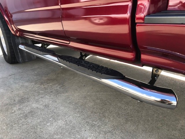

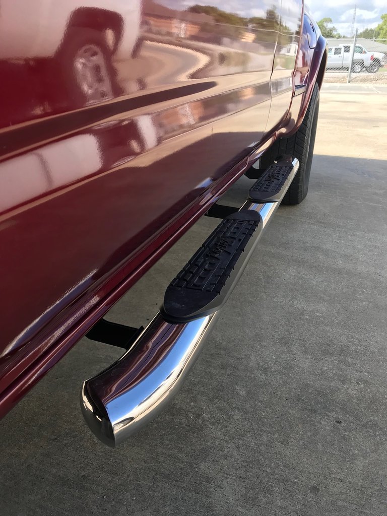

    I didn't like what bars were offered for my extended cab because they only extended under the driver and passenger door. the look I wanted was full wheel to wheel bars so I order these which were originally for a 2010 tacoma and fabricated my own brackets and bolted straight to the frame.nerf.jpgnerf 2.jpg
