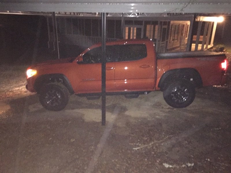

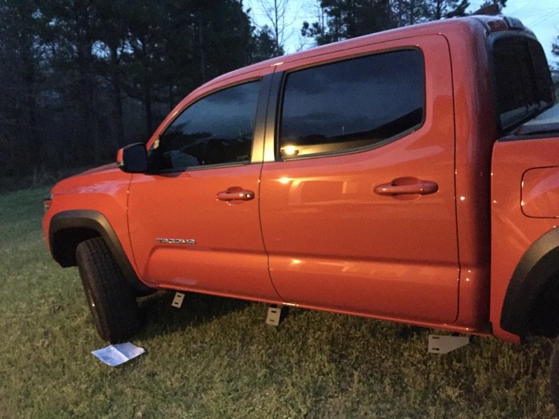

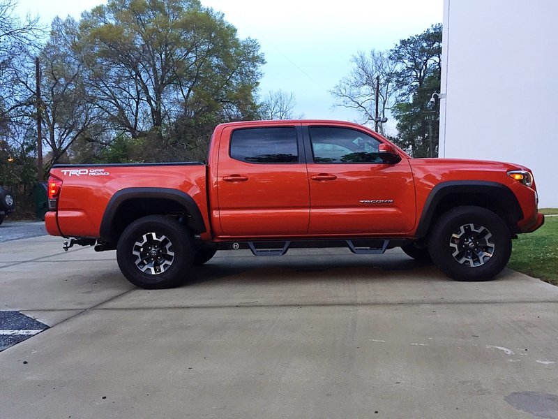

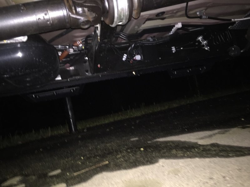

    So I went with the ICI MAgnum RT steps. And let me tell you in advance, they look awesome installed. But these things are a pain in the rear end to have to install. The mounts were easy and just like the video tutorial showed, BUT when it came time to attach the step, its insanity.
    First, there is no room to fit your fingers in the brackets to get the bolts in place, so I had to reverse the required install, putting the nut, washer and locking washer on the outside, rather than on the inside of the step.
    Second, the third bracket is higher than the front bracket. What this means is that when you go to lock it in place (which takes some funky angles on your wrenches, and very tight spaces.) it will be slanted. Adjusting the step down on the back bracket will alleviate the slant imposed.
    Third, I did this last night, and it started raining and then got cold as crap. I highly recommend you do this during the day, with at least 4 people in a shop, and just pay them to install it. At this point I can say with full confidence. I wish I had just paid the freakin $50 bucks to the shop and let them deal with the headache.
    So in conclusion, the steps look awesome, and just what I wanted. However, I highly recommend if you go with this brand, let someone with a shop and more patience do this. Otherwise, these things will drive you to drinking.IMG_7934.jpg IMG_7936.jpg IMG_7939.jpg IMG_7949.jpg

    Could you have mounted the brackets to the bar first, leaving them slightly loose for adjustment, and then mounted the whole assembly to the truck? That's how mine worked (different brand and style from yours.)

    @Sola Gratia Possibly, the only thing is that makes it very heavy, and when I attempted to do that on the drivers side, the holes would not line up on the body for some reason. So in the end I had to do what the instruction called for. I would recommend a different brand
