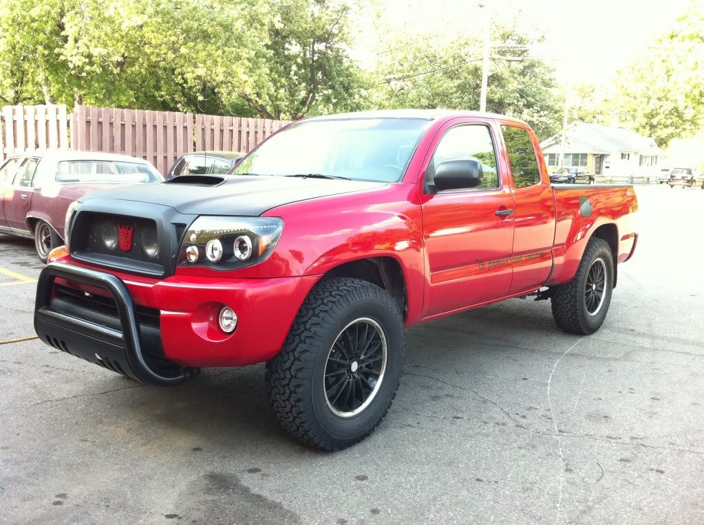

    I have a 5 lug I just ordered the ready lift for but.. I'm wondering if I can run 33's on there I have 18" rims.. Or at least how much would I have to trim the wheel wells or bumper?? Bas ass truck by da way

    IMO, you should get an aftermarket bumper if you decide to run 33s. It just looks better and the truck looks taller. If you want to run bigger tires, you will also need to consider regearing your truck. IMO don't put too much strain on the engine. BTW, have you removed the black box from behind the plastic fenders?

    It depends on on your wheels and the height/width of the tire. The offset and backspacing will affect the turn radius/rotation of the tire. You may only need to trim a few inches, but the best option would have the wheel and tire test fit on your truck and see how much you would need to cut.
    Alex took some pictures of the area(s) he cut to fit his tires. He is running BFG 32x11.5x15 A/T tire, so I am sure he still had some clearance, so he did not have to trim his bumper.
    My tires, KM2s 33x10.5 is taller and narrow tire compared to Alex's setup... I completely removed the inner fenders on my truck to avoid the rubbing. I had 33s test fit with the Mojaves, and they hit the bumper and I knew I had to cut into it. Instead of trying to cut the bumper up, I found someone to build my bumper.

    Thnks alot I'll see how it goes hopefully I can get 33 the won't hit the bumper..

    got 33's to fit! :)
