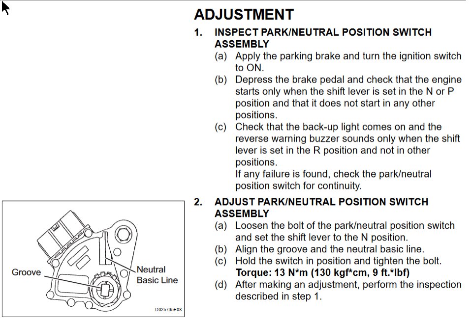

    So I got it down to it the NSS isn’t the right one or I have not put it in properly when the transmission is in reverse it thinks it’s in park. And my Speedo is working on and off no bad fuses or relays
  9. Jan 24, 2021 at 8:31 PM
    Jimmyh
    Jimmyh Well-Known Member
    May 16, 2012
    #78991
    14,243
    SC
    2012 Prerunner SR5
    Sounds like it needs to be aligned properly. There is a mark on the switch for neutral position.
