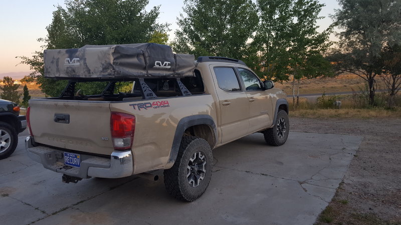

    Have you had any issues with the tent slipping around on the rack? I just got the CBI bars and Mt. Shasta tent and it almost slid backwards off my rack driving around town. With the bolts CVT issues it was a pretty tight fit.
  3. May 7, 2017 at 6:40 PM
    #223
    nevadabugle
    nevadabugle [OP] Desert Rat
    Jul 25, 2014
    #134701
    3,990
    Elko, NV
    2016 DCSB TRDOR manual in quicksand
    Wow....no problems what so ever. So are you saying the tent slid back on the rack? I hammer on my truck pretty hard with lots of high speed desert driving (45-60mph) and lots of rough two tracks. No issues with anything moving. I did tighten mine beyond what CVT recommends. I believe they say that if the flat plate is bending they are too tight. I tightened mine so that the plate were just starting to show some bend.

    yes, it slid backwords so it was only resting on on rail. when I was putting it on it almost seemed like the holes drilled in the CVT base-plates to go under the rack weren't wide enough for the the CBI bars. Tightening the nuts the slides that go in the CVT rails were pushing out a bit. I don't know if that could be it. Figured I would get on here and ask since they were close today. makes me a little concerned to put it back on.

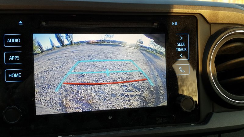

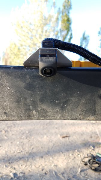

    Success! You can see the spare tire in the upper right hand corner of the screen. I may need to adjust the camera a little but overall it works great! Pretty easy to do. Hardest part is lengthening the wire harness which is too short for to offset the camera like it is from the factory.
