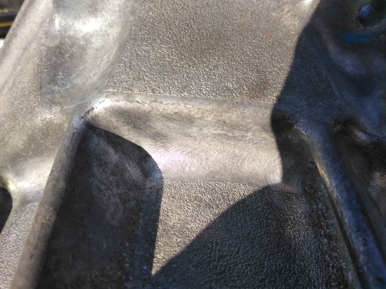

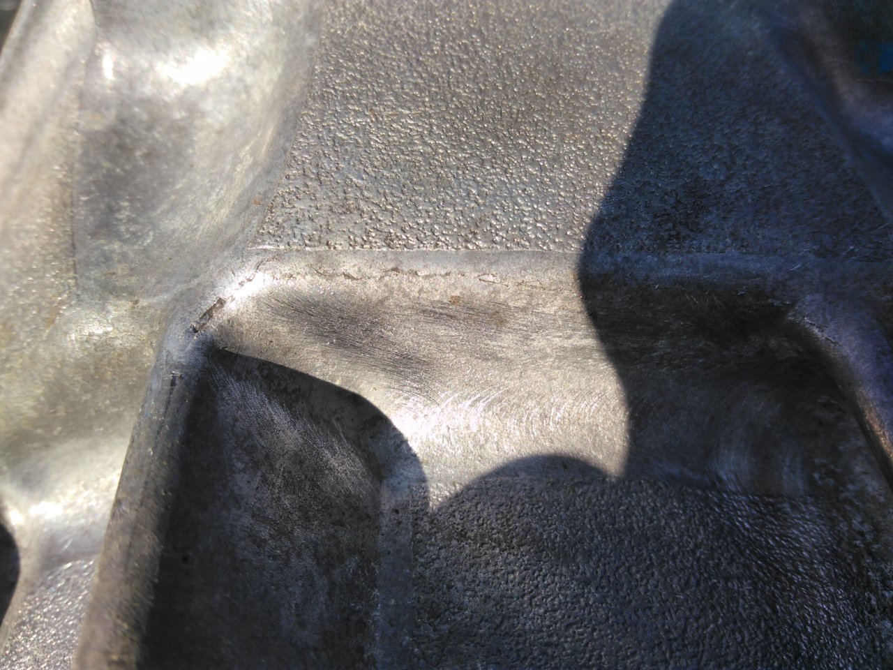

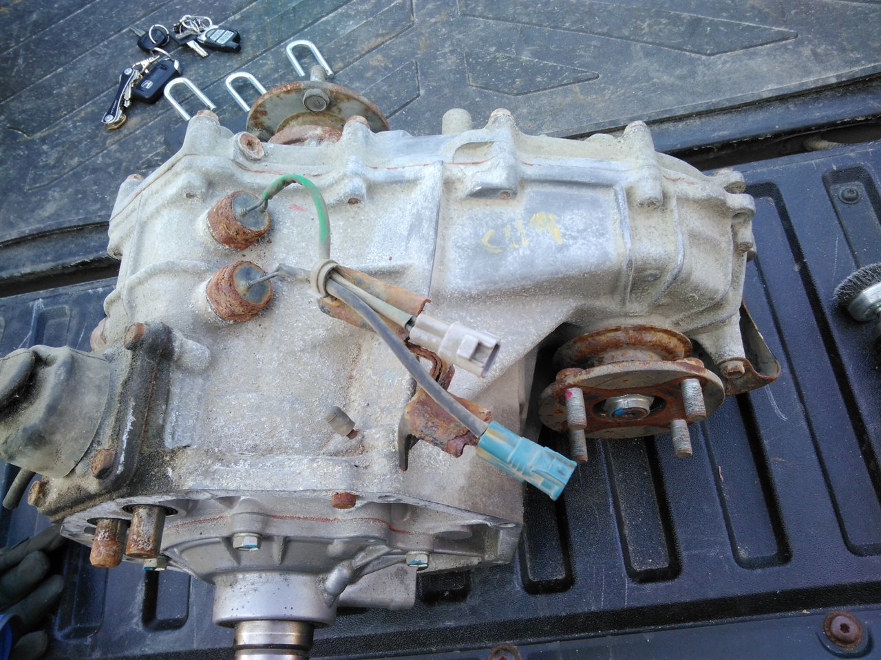

    Spent some time this morning starting the clean up of my FJ t-case.
    I know @tacoma16 keeps saying Toyota stronk, but is this cracked? Do I need another one? @Windigo
    o_O
    It looks to me as thou the molding line from the casting is just chipping off? Maybe I am wrong and its fuked.
    Looked better when I was done for the morning.
    Windigo likes this.
  9. Apr 24, 2021 at 8:32 AM
    #429
    Windigo
    Windigo Well-Known Member
    Dec 21, 2019
    #313884
    4,296
    Farook
    Toronto Ontario Canada
    '14 Acess Cab
    I don't know for sure but if it was it would be all oily, I'd say with certainty its not cracked. Thoes look like the same plugs have on my fj case. I just left it alone as they dont plug into the harness on our trucks, well that is my experience anyway.

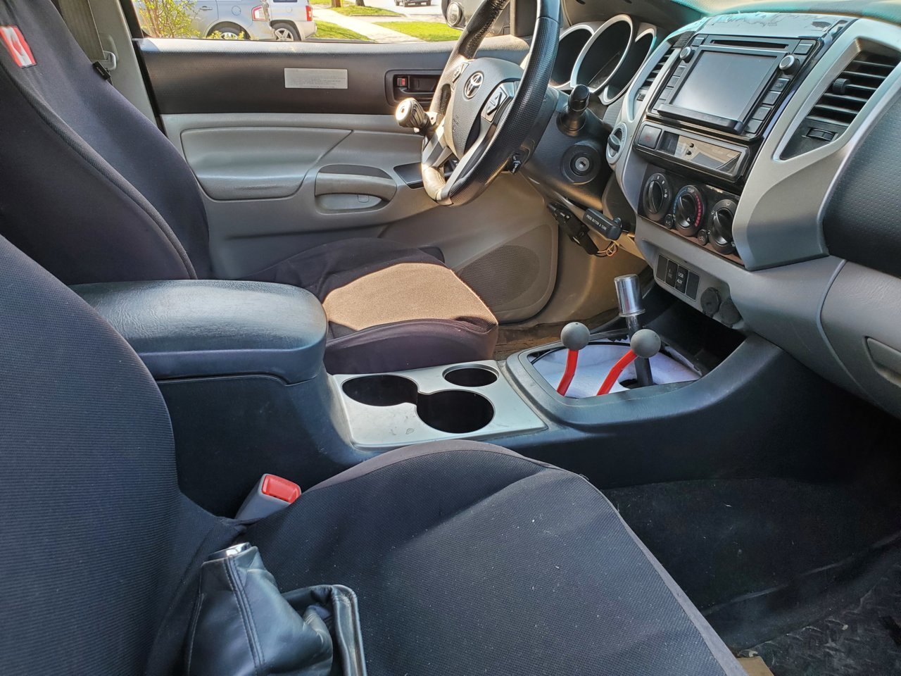

    hear is a pic of where i put my shifters. after i messed up my stock trans shifter i improvised with scrap metal peices..lol.
    I found that shifter location is the hardest part of this build
    the easiest part was what i thought was going to be hard which was the input swap.. have fun with it at least your not letting it sit and collect a year of dust like it did.....
    llamasmurf[OP] likes this.
  10. Apr 24, 2021 at 9:15 AM
    #430
    llamasmurf
    llamasmurf [OP] Herpa Derp
    Mar 1, 2016
    #179866
    5,192
    Wes
    Northern Ontario
    '15 Matte Black TRD AC
    FJ t-case with twin sticks, UTE bed, some other things :D
    Yours looks great Farook!
    Thanks for the feedback. I think you are correct and it is not cracked. It is just chipping a bit on the mold casing line. It was not oily at all down there.
    :hattip:
    Windigo[QUOTED] likes this.
  11. Apr 24, 2021 at 2:14 PM
    #431
    tacoma16
    tacoma16 Well-Known Member
    Mar 15, 2011
    #53109
    11,214
    Peter
    Ontario
    Double cab SR5 4x4
    looks to be just the casting lines. I had a few spots like that on mine.
  12. Apr 26, 2021 at 5:57 AM
    #432
    llamasmurf
    Mar 1, 2016
    #179866
    5,192
    Wes
    Northern Ontario
    Thanks Peter,
    I was scared when at 1st when I saw it, but after inspection. I am pretty sure you and Farook are right.
    It's casting lines flaking off. :fingerscrossed:
    tacoma16[QUOTED] likes this.

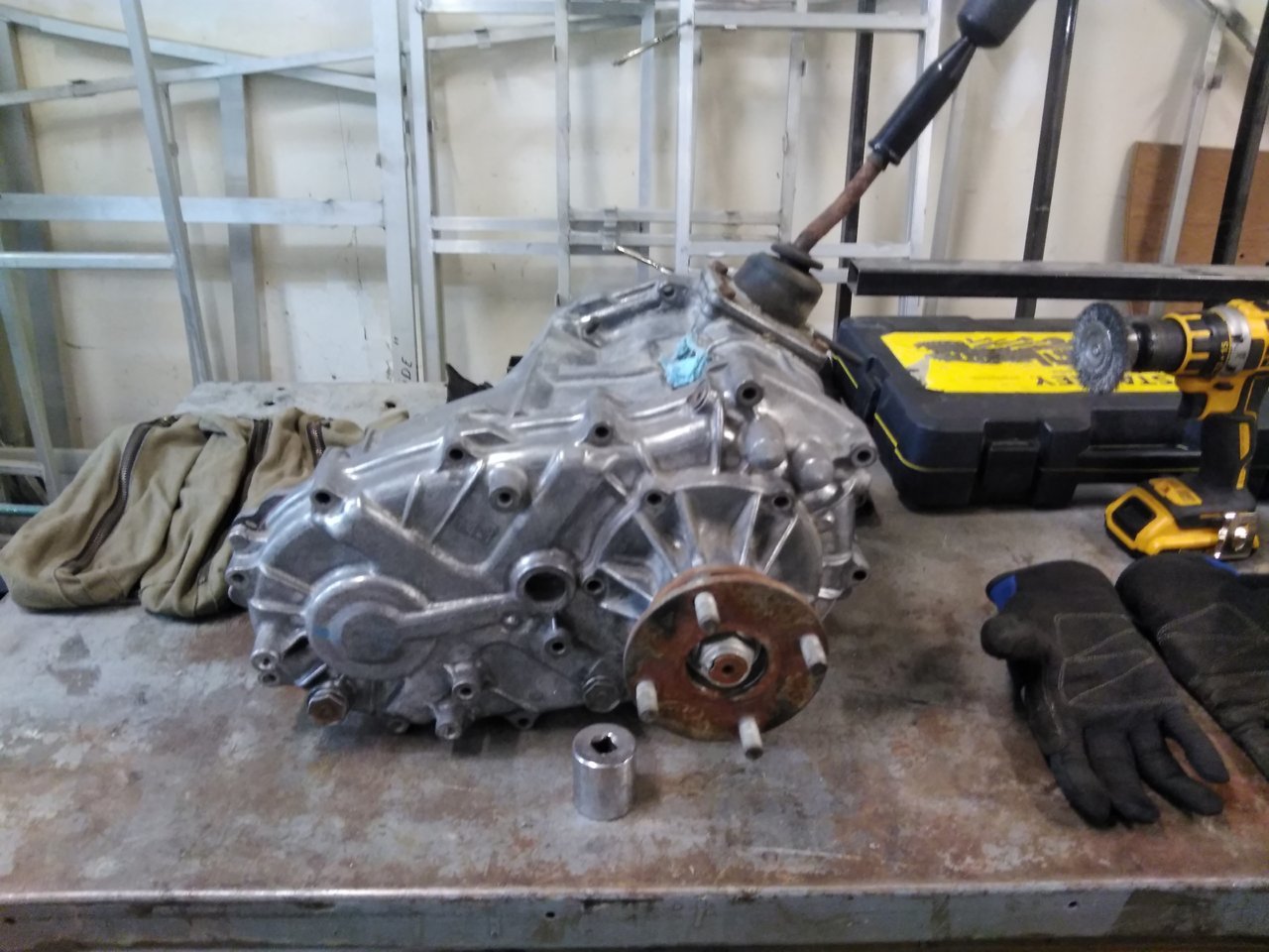

    Got my workbench all setup today. Attached a vise that I managed to borrow, 8" vise with a pipe fitting under the main jaw. Very nice, new to me vise.
    Started taking the FJ t-case apart :fistbump:

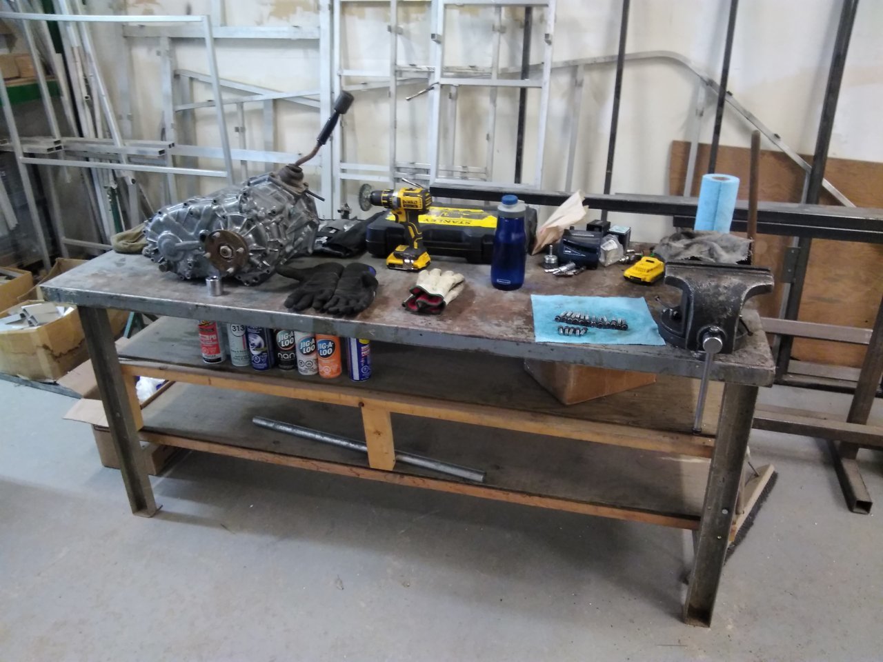

  17. May 1, 2021 at 3:14 PM
    #437
    Windigo
    Dec 21, 2019
    #313884
    4,296
    Farook
    '14 Acess Cab
    very nice work location, hopefully you got the tunes to go with the work:), a little Rush maybe or a little Hip comes to mind, enjoy

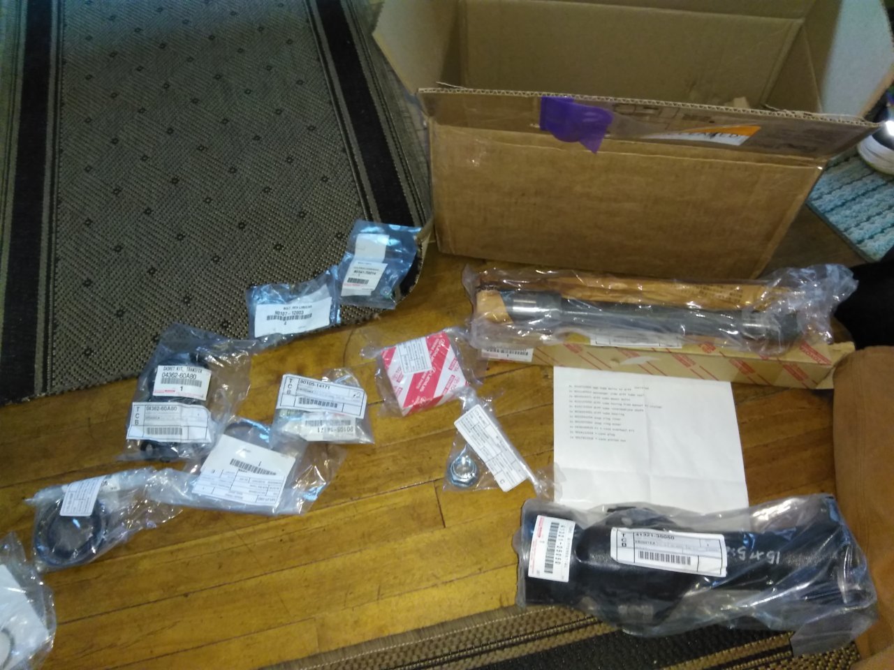

    More stuff arriving. New clock spring, as mine has started dying. Horn does not work and airbag light came on a few weeks ago.
    Some sound proofing to correct what I did on the inside by removing everything in the back.
