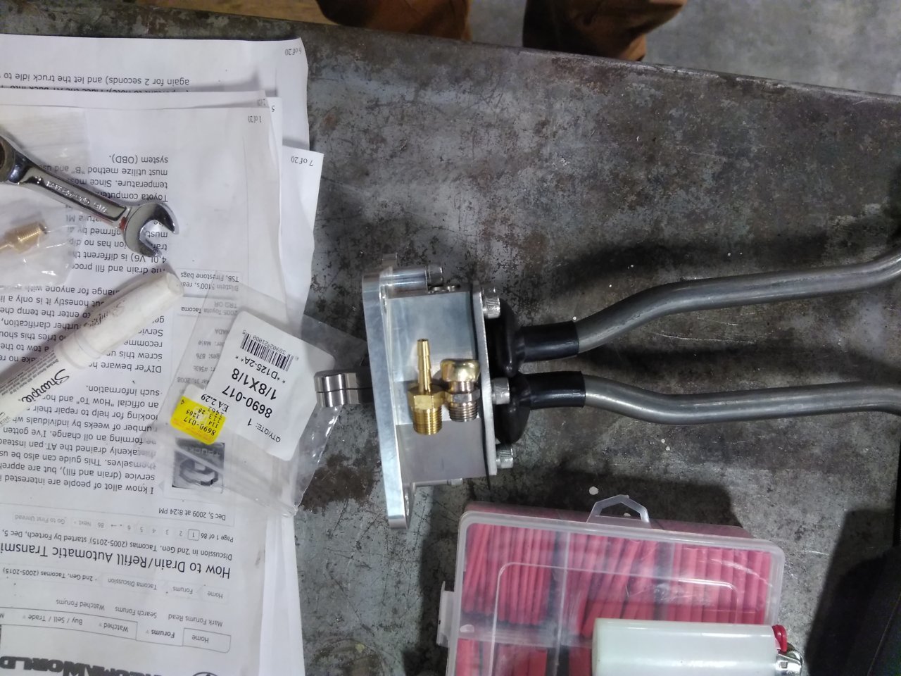

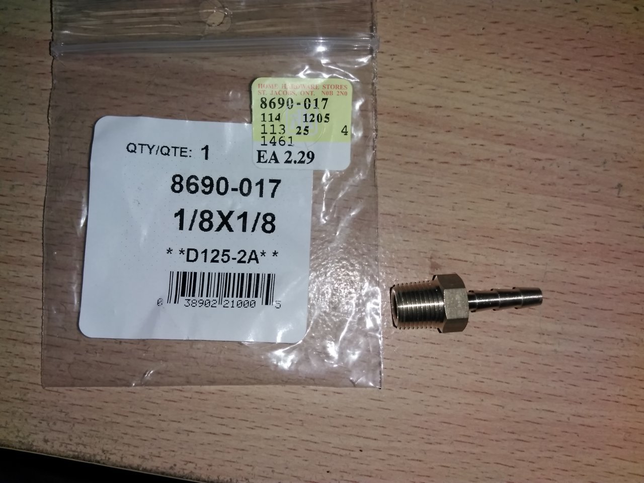

    @tacoma16 I think you replaced the breather adapter on your twin sticks.
    Was it 1/8 NPT?
    @TjAeCeOpMAmiah This should be it :rolleyes:
    'Should' screw directly into the twin stick, then plug right into the stock breather tube. :fingerscrossed:

    I did yes. Used a 90 though I believe is was 1/4” npt thread but it’s been a minute so and I don’t recall.

    Lucky enough I bought a 2nd twin stick :boom:
    Tomorrow I can test fit it, and see if its right.

    1/8 NPT looks like the winner :fistbump:

    My bad!
    I may have used an adapter from 1/8-1/4 from the looks of it. It was last year that I did this (crazy how time flies). 753A5844-97A0-45A2-A71C-157767640D62.jpg

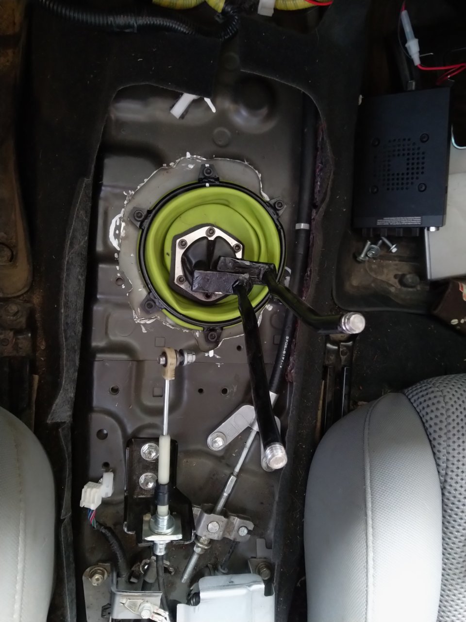

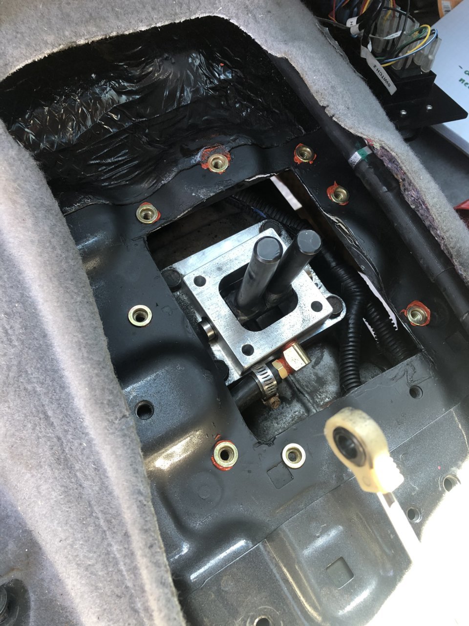

    Did about 200KM on the weekend, much of it on the trails.
    It is almost perfect!
    The only major issue is with the stock transmission stick nob, it is to large to go past the 4lo nob in 4lo to get to Park.
    So I will have to change all the nobs I guess.

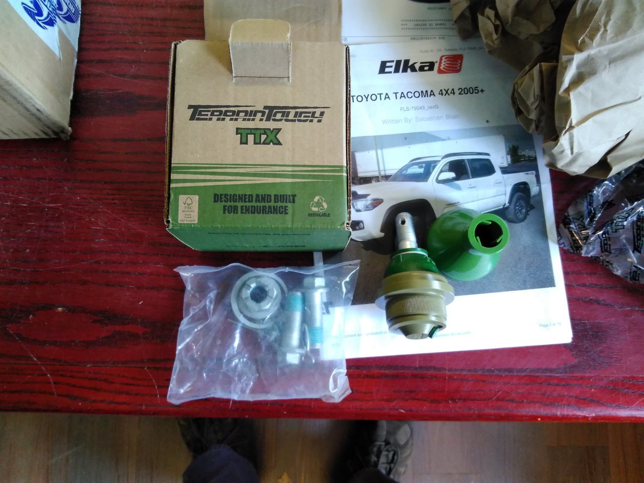

    More stuff for the horde :woot:
    LCA ball joints
    SR-71A and 3JOH22A like this.

    Are thoes greasable?
    can I get a link please..
    It's OK I got it.
    llamasmurf[OP] likes this.

    Yea they have a grease zerk you put in a hole at the bottom, comes in the bag of stuff there.
    They are the ones Dax linked

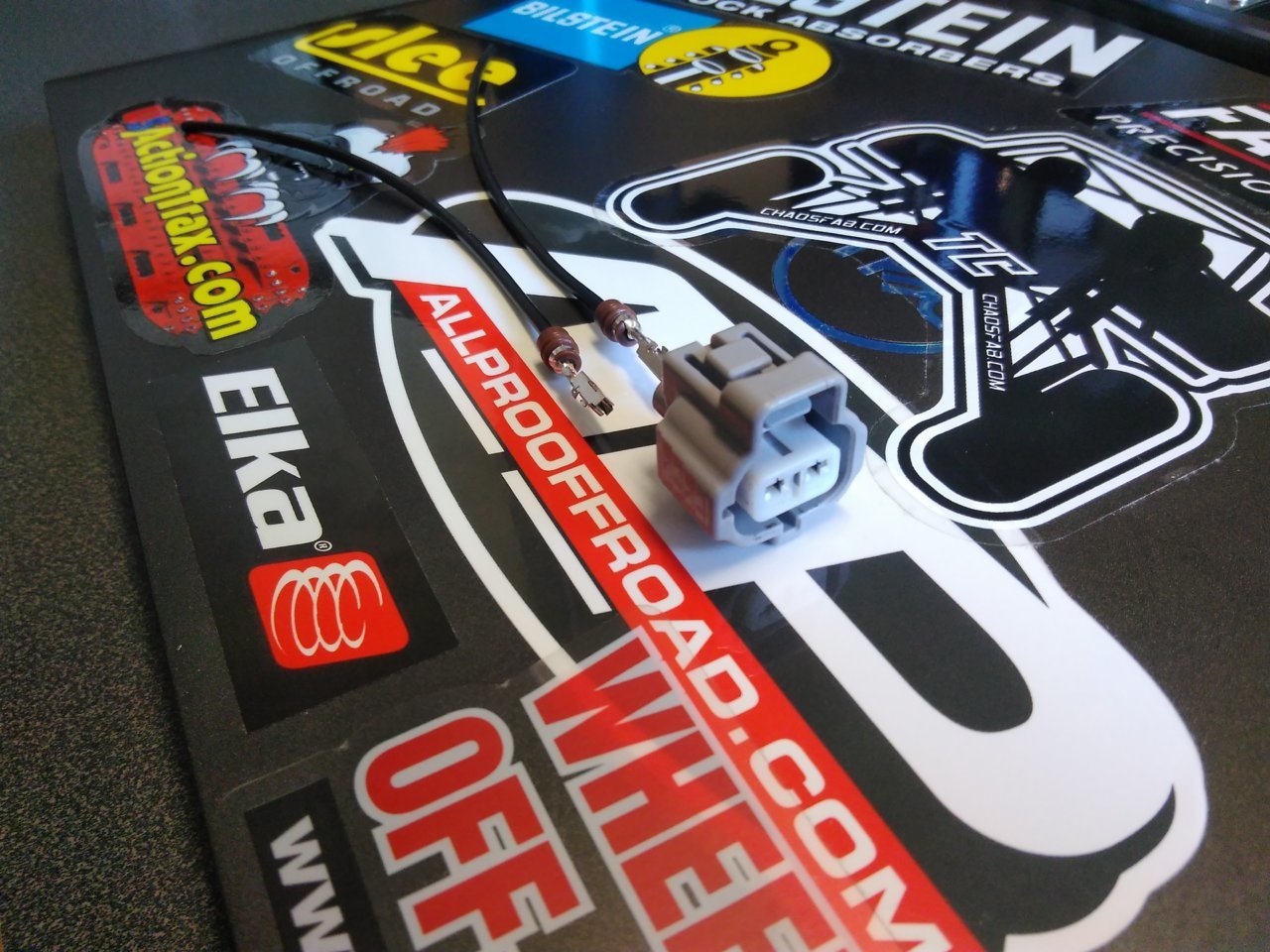

    Couple more small items to help complete the T-case switch over.
    Plug for the Neutral that comes off the FJ T-case and the leads to go in it.
    Now we can wire it up.

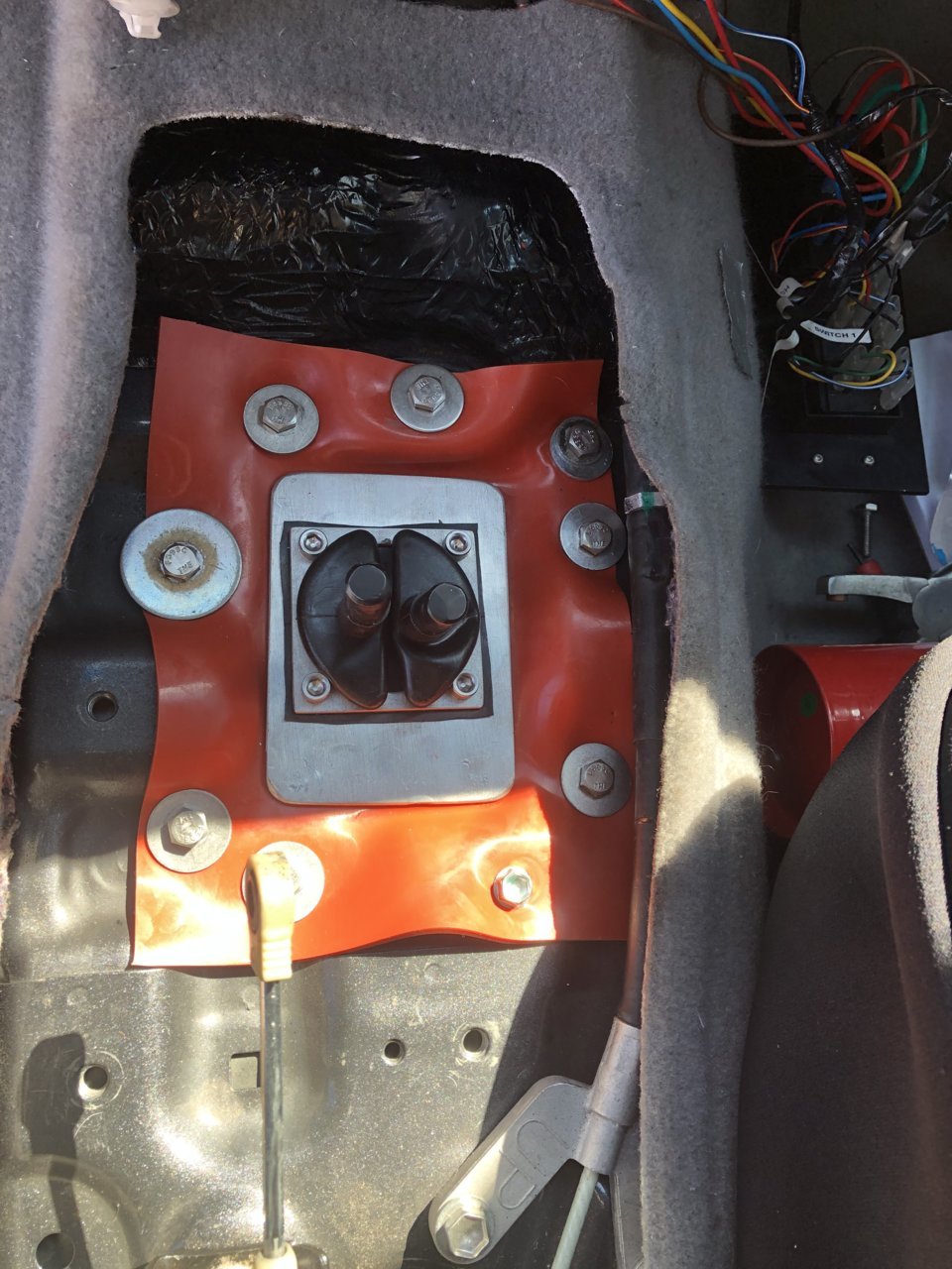

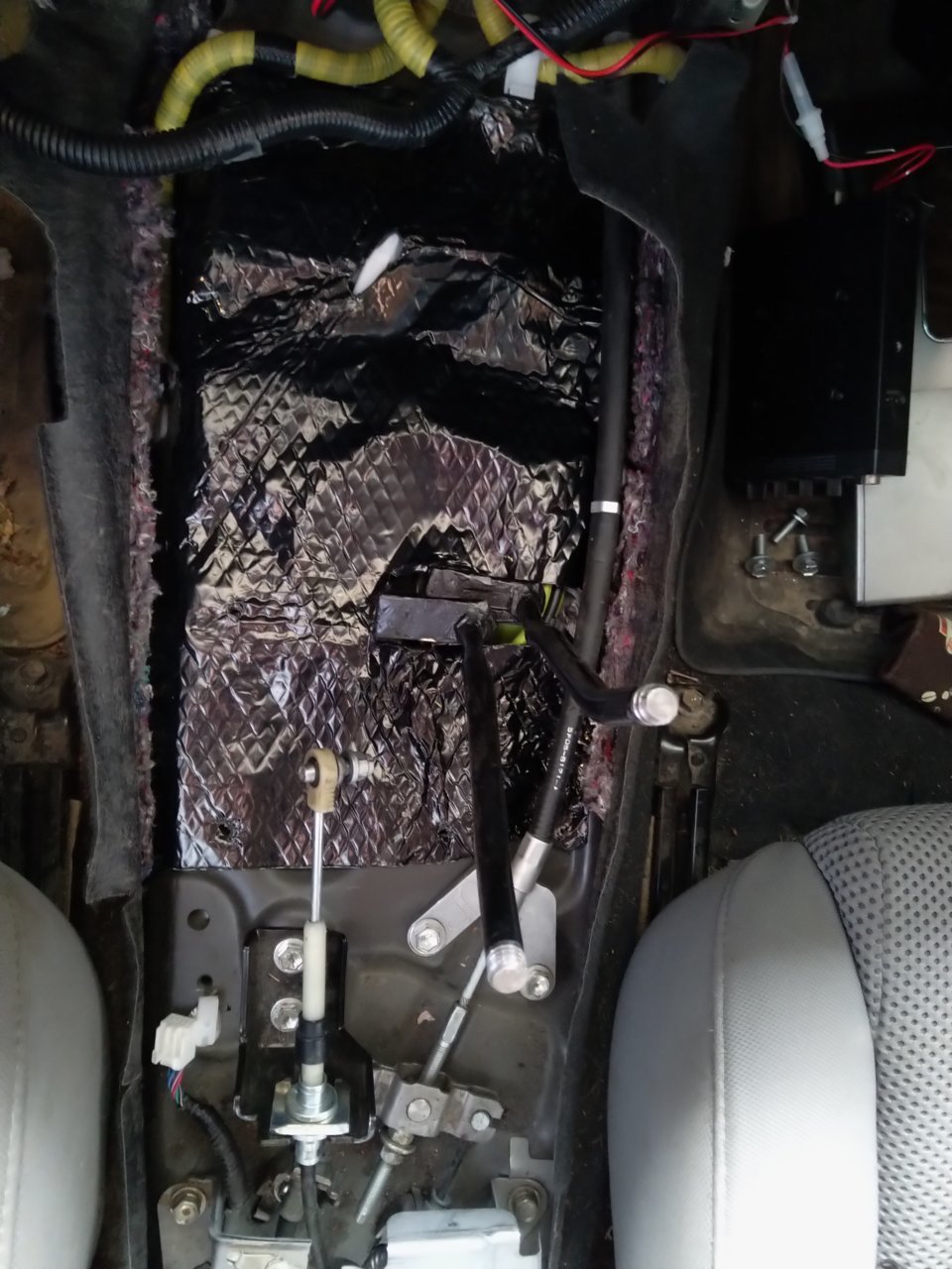

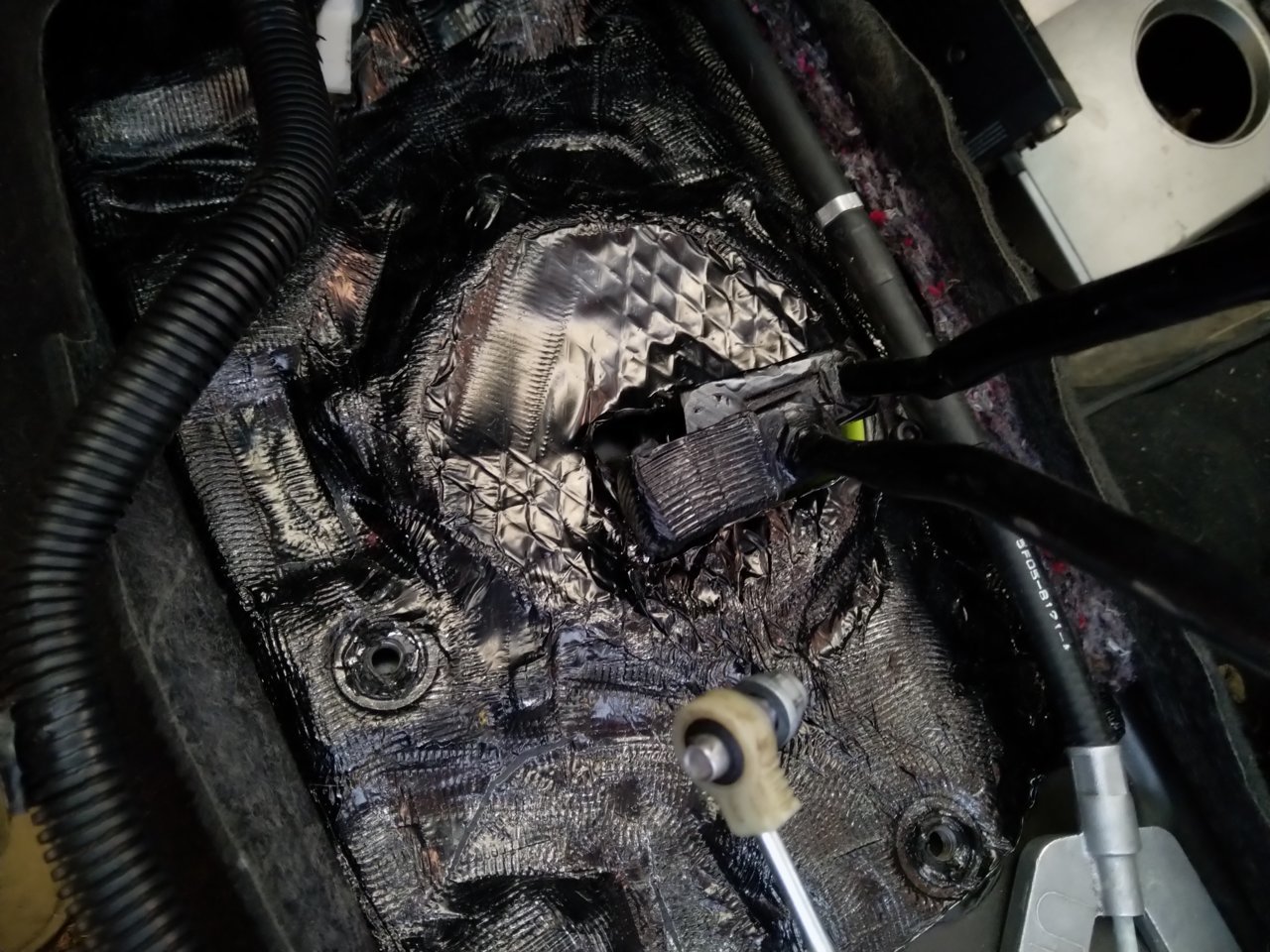

    Spent a few hours today working on sound proofing and fixing the rattle.
    Gave the 4lo stick more clearance, then put some sound proofing around the sticks. It seemed to eat up ALL the rattle.
