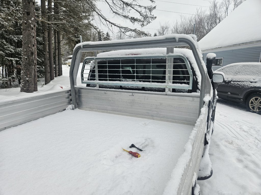

    Looks so damn good. :cookiemonster:
    We are getting hammered with snow today

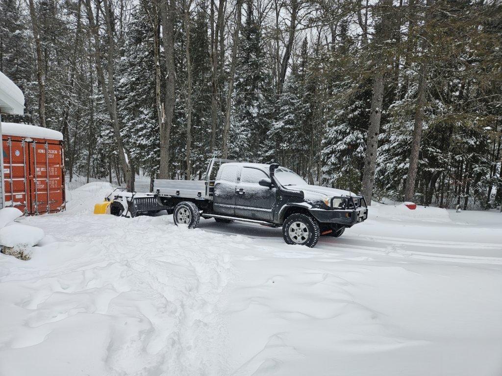

    Didn't drive it anywhere yet. Today was .5cm/h snow all day here. We must of got 25+ cm again today
    Just from my neighbors shop to my house, 200 meters.
    But I can see there is a larger gap between the bumpstop and stop point.
    I am excited to drive it, might go to town tomorrow

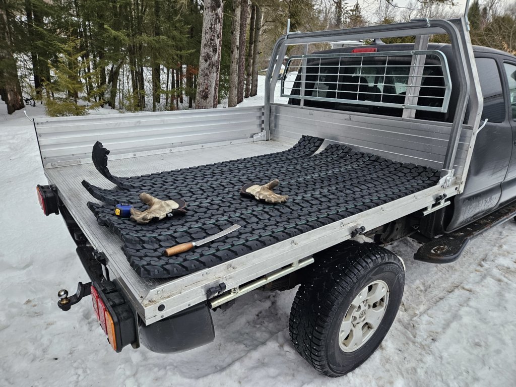

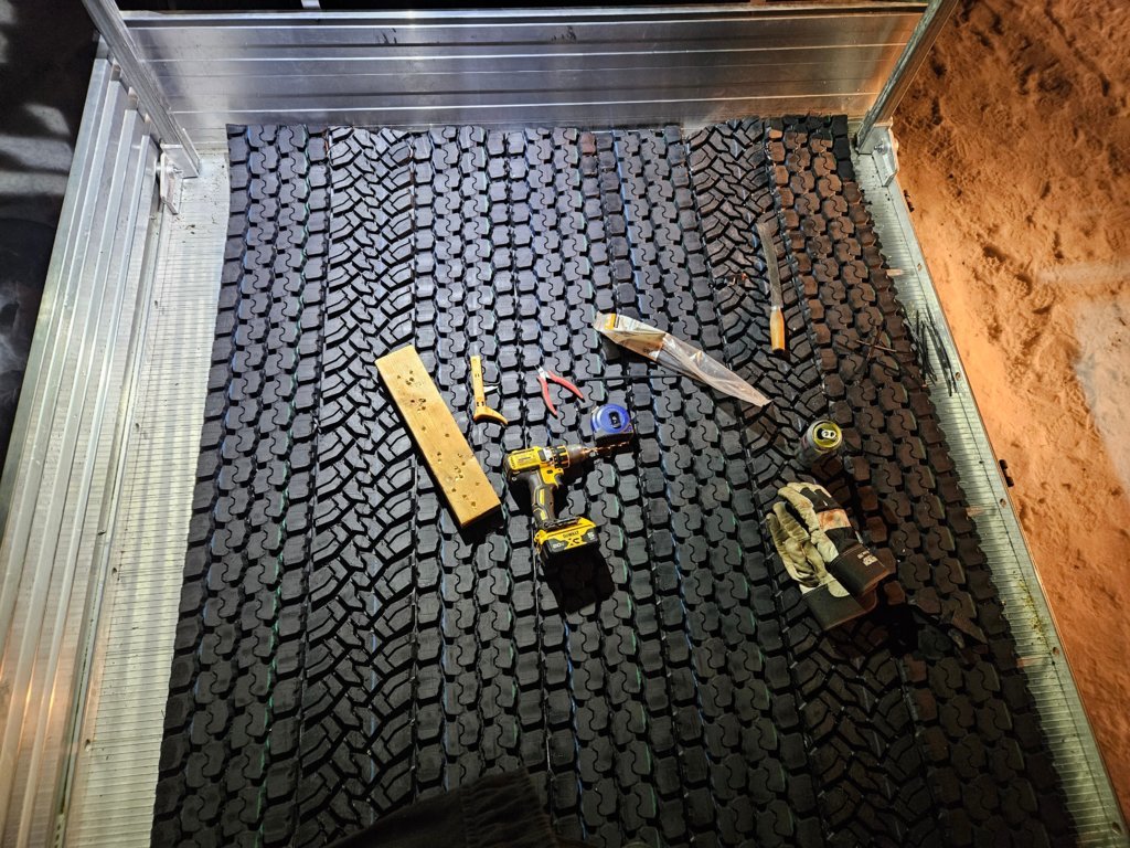

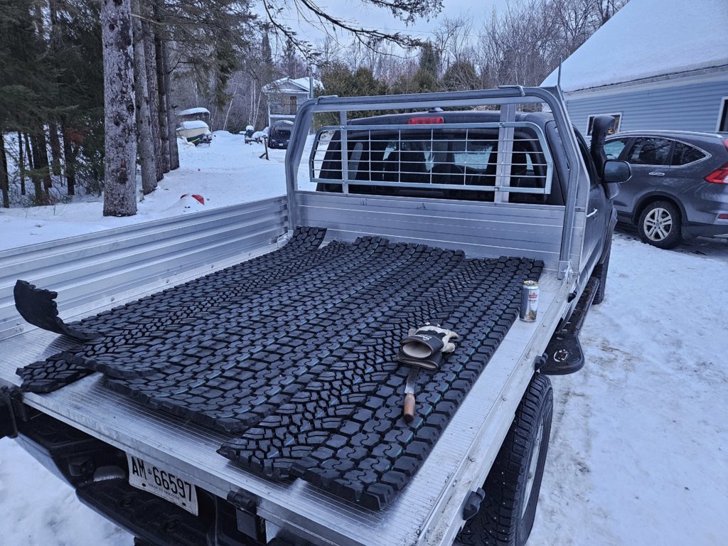

    Got busy tonight making a custom bed matt for this slick as butter aluminum flatty.
    Not done zip tieing it all together yet, but it's looking pretty good for free.

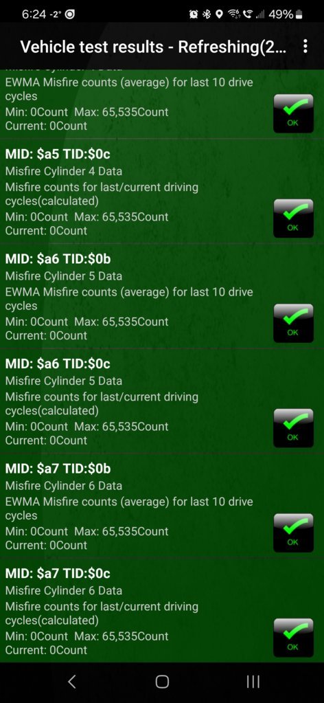

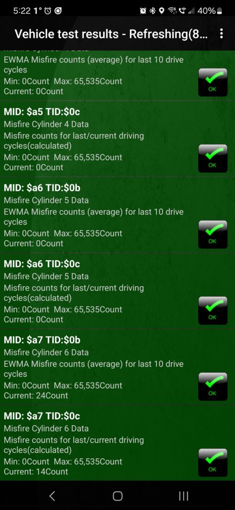

    Worked tonight on getting the slight miss fire narrowed down. It just showed up last week.
    Cylinder 6 looking good for the culprit.
    Will replace the plug and see if that fixes it. Got 1 coil today as well, incase the plug doesn't get er done.
    She gone be purring again soon.

    All fixed, the plug was gapped like a hotdog down a hallway. Changed out the coil as well, just as a trouble shooting measure. Will keep the original coil for the same purpose now, since it was working fine.
    Doing the rest of the plugs maybe Friday if I have enough time.

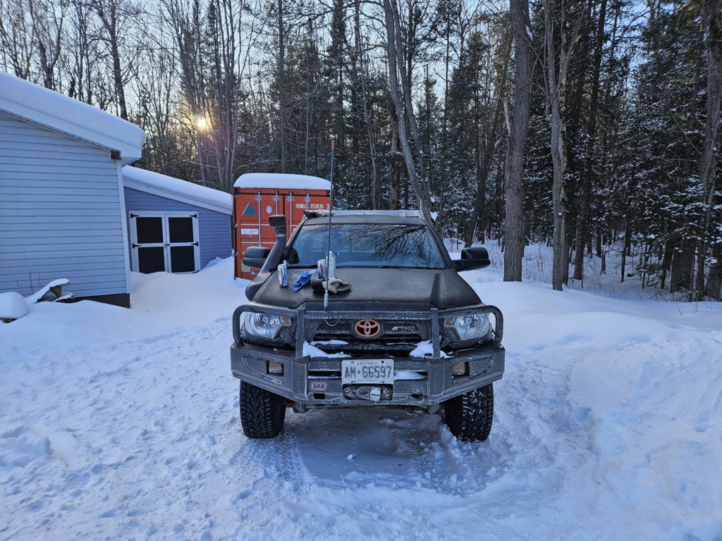

    These mirrors are great so far, barely vibrate. Can see everything now.
    We will see how long they last.
