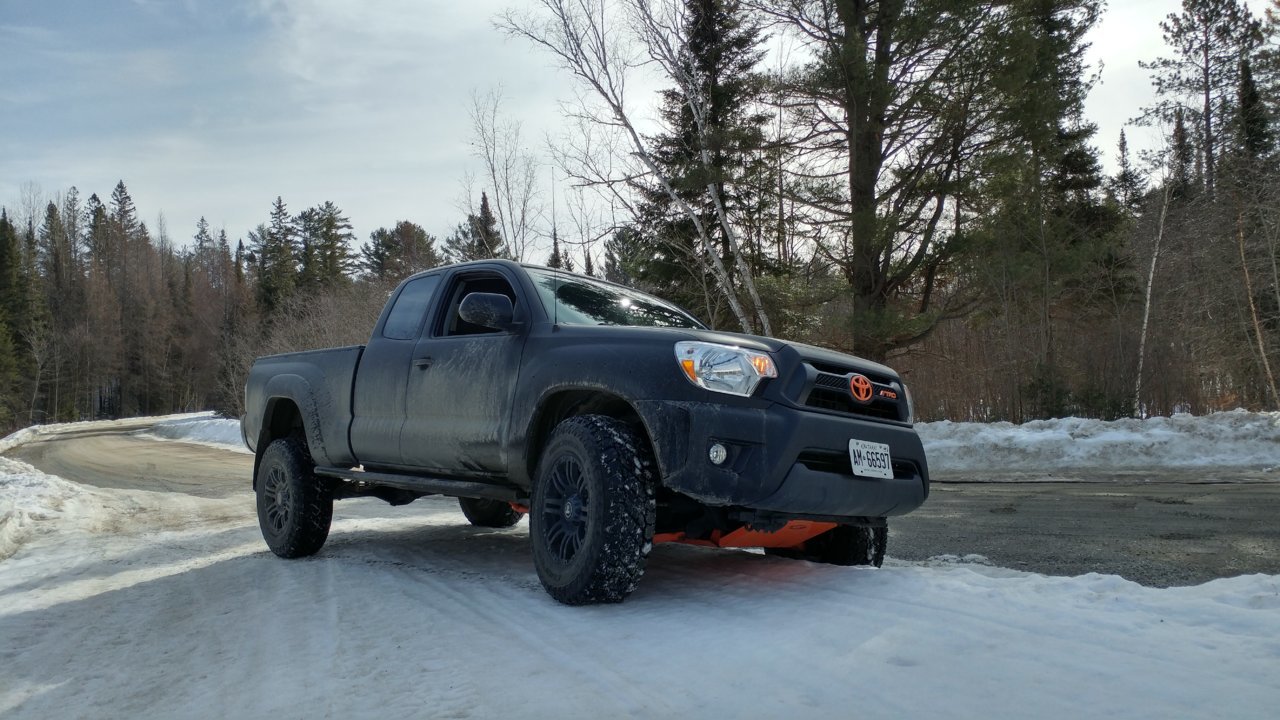

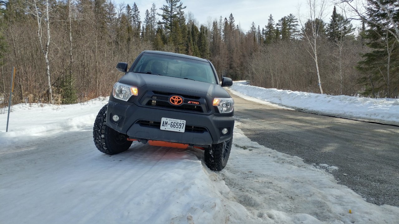

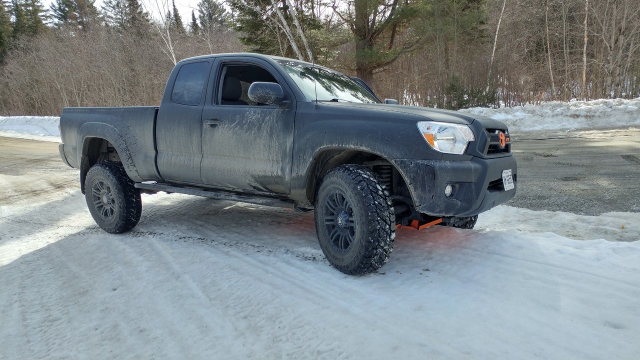

    Went out with the wife this morning to have a drive, got her to snap some pics :cookiemonster:
    Since winter is just leaving us here, I am able to actually hit some dirt on the back roads and get the air pressures correct for it on the new tires.
    24 PSI front
    20 PSI rear
    Was today's test, pretty decent, I might try 18 rear next with 24 front.

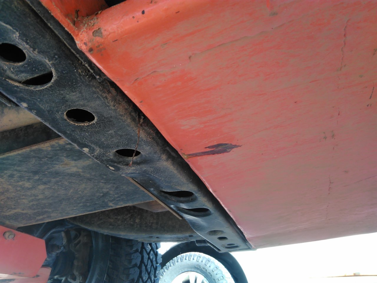

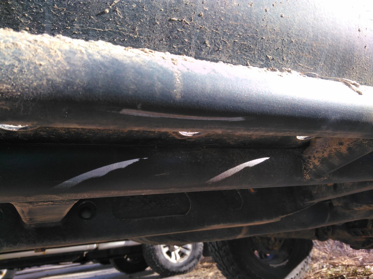

    Some trail 'damage' to the rig today. Just a love tap from a stick, a reminder to ensure I know where BOTH front tires are. I did not even feel this happen.
    :eek:
    Found it when I was aring up, never lost air or had a problem. Switched to the full size spare for the highway ride home cuz I was worried. :thumbsup:
    So glad I have all the things, full size spare, bottle-jack stand to put it the spare on with, it was a breeze.
    This is how I fixed it. Pulled the valve core to fully deflate the tire, and let more air out as it was pressed on by the jack. Used the stock bottle jack upside down against the slider, it has a nice rounded top to not damage the tire at all. :cookiemonster:
    Only got 'stuck' once and got to use the recovery boards. I was going to get a small yank from the other guy I was wheeling with but I figured lets try the recovery boards 1st, and they worked perfect.
    One recovery board in front of each rear tire that had come up against a mud / clay bank and could not get traction. They fixed it instantly, truck walked up it like it wasnt even a thing once we put them down.

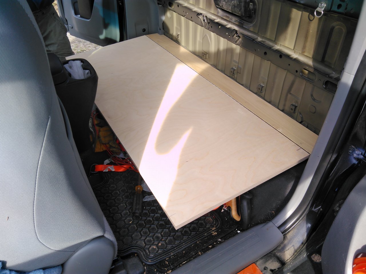

    Getting the tray test fit for the 1st time in the back tonight, this is going to be awesome! :cookiemonster:
    Piano hinge along the back, so it can be raised to allow access to the goodness under it. Some feet need to be added on hinges behind each seat. Some inlays will be put in with a CNC machine to allow the bottle-jack-stand to sit flush with it. Oh its going to be nice :thumbsup:

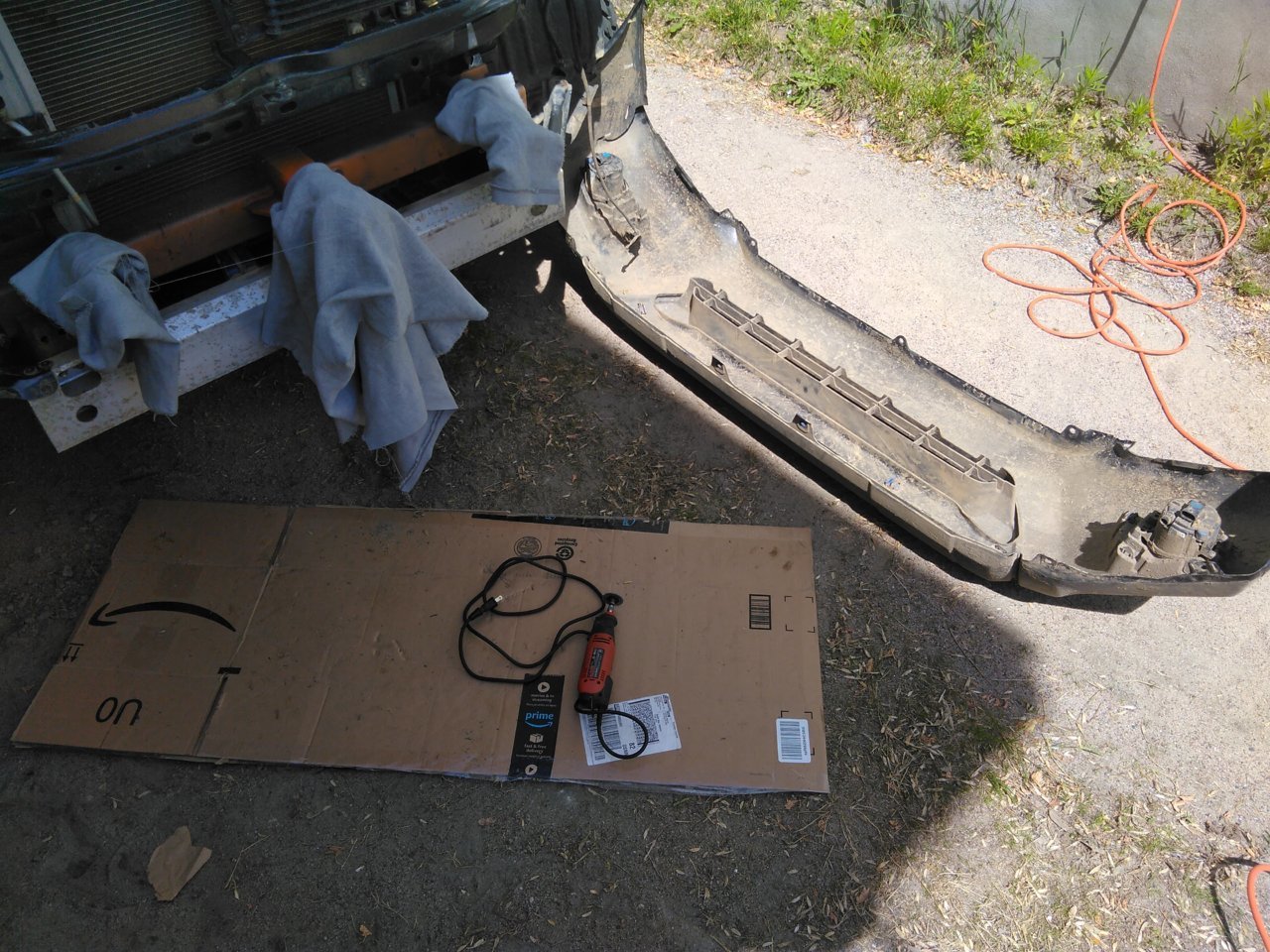

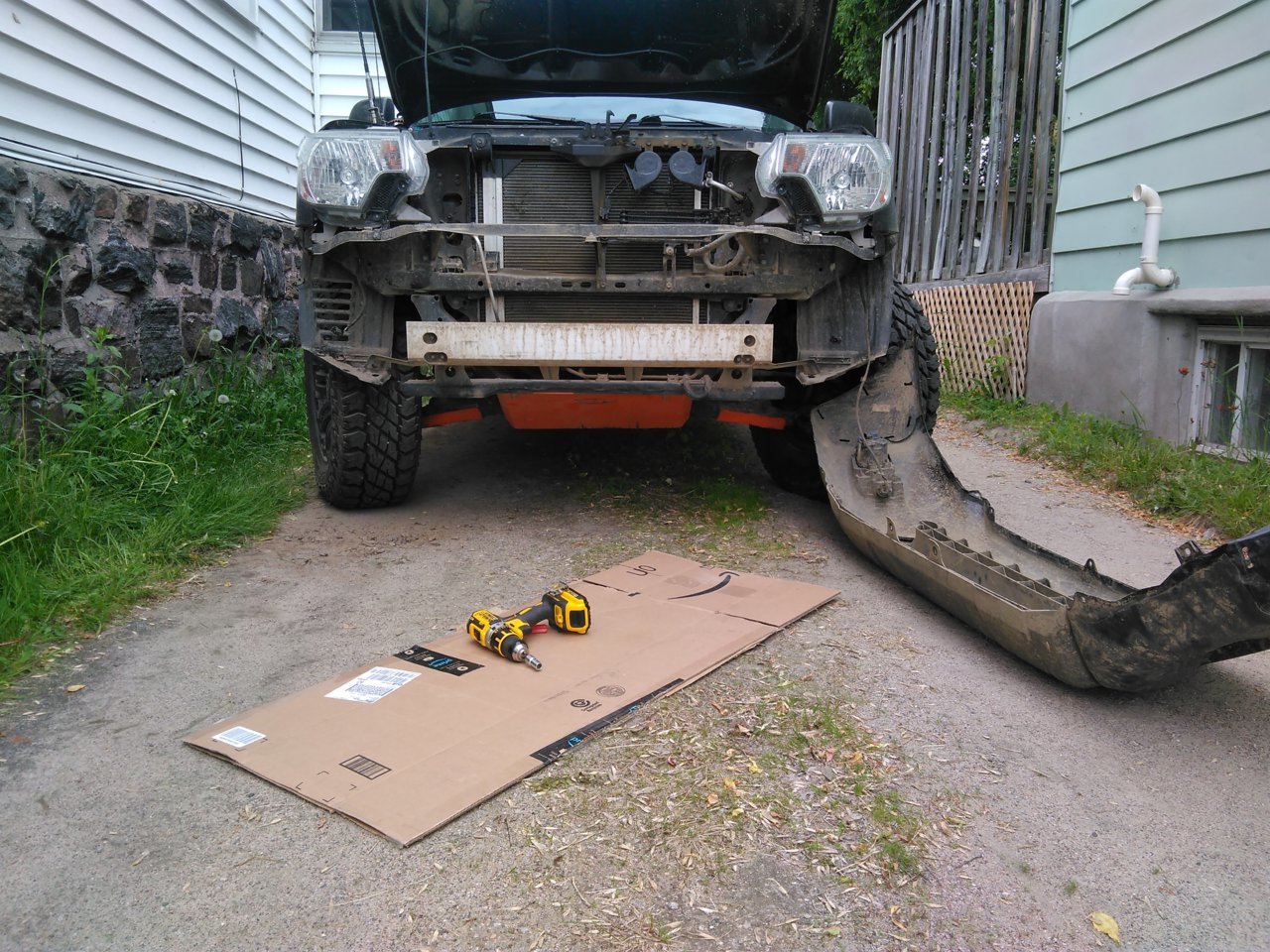

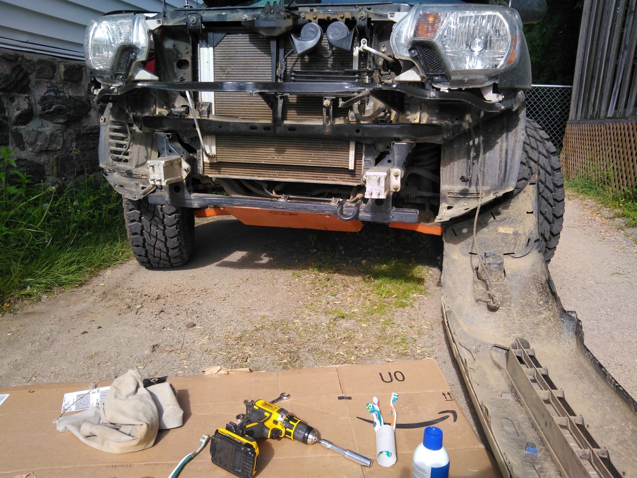

    Saturday turned out to be absolutely beautiful, so I used it to work in the driveway and install the Mobtown Front Hitch Receiver.
    The instructions from mobtown are a little 'light' so it took me a stupid long time to get it all done, but it is finished.
