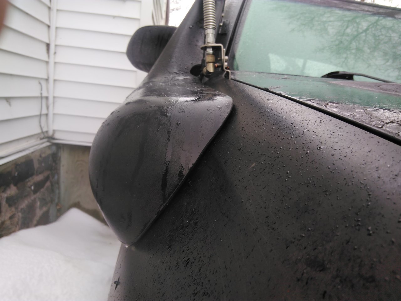

    The weather warmed up a bit and I could'nt wait anymore, got the Dobsinson snorkle installed.
    Had no problems with the install, just as @boogie3478 video said 'use soap' helped a bunch.

    Looks good nice job,you took it for a drive yet

    Thanks! It turned out perfect.
    Just home from the shop is the only drive I could fit in today.
    It didnt fly off and get lost in traffic, so :fingerscrossed:

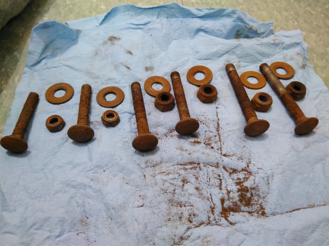

    I am pretty disappointed in the hardware supplied with the snorkle. Rust on the hose clamp holding the scoop on, rust on the bolts, washers, lock washers and metal bracket attached to the A-pillar. It has been on 2 weeks. Guess I have to change it all out for stainless on my own.

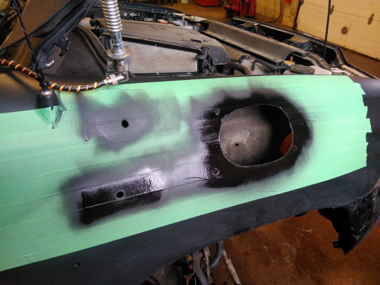

    Removed the @TOTAL CHAOS LCA skids for some love. The powder coating that is still on them lasted for 3 years so I can not fault it at all. It just costs to much to have that done, when compared to just my time and effort now that I have access to a sandblaster. They are going to get sandblasted and rattle canned orange.
    Didnt strip anything or have 1 problem removing the hardware holding them on. I now know that the maintenance I am performing is working. There is rust on the nuts and bolts, but nothing was welded together after over 2 years of not being removed.
    :sawzall:
    I need to add a drain hole to the LCA's. Each of them had about 1/2 a Liter of water drain out of them when the lower bolt let loose on them. This I believe is also the source of some 'banging' in the front end at odd times that just comes and goes in the winter. I think this is thawing and re-freezing, as well as bouncing around inside the LCA because it is hollow and making noise.o_O

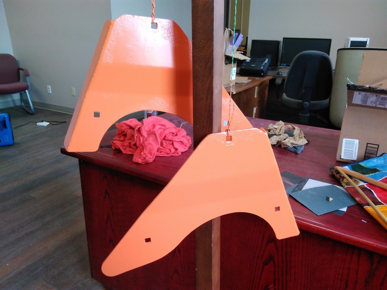

    Got busy again today!
    Ground each of the Total Chaos stock LCA skids with an angle grinder using the flapper paddle wheel, then sand blasted them.
    :laser:
    Slapped on a layer of primer when I was done, to keep them sealed from rust until I can get paint on them this week.

    1st coat of orange on them, they will be getting a 2nd coat tonight that should make them just pop in full orange. :bananadance:

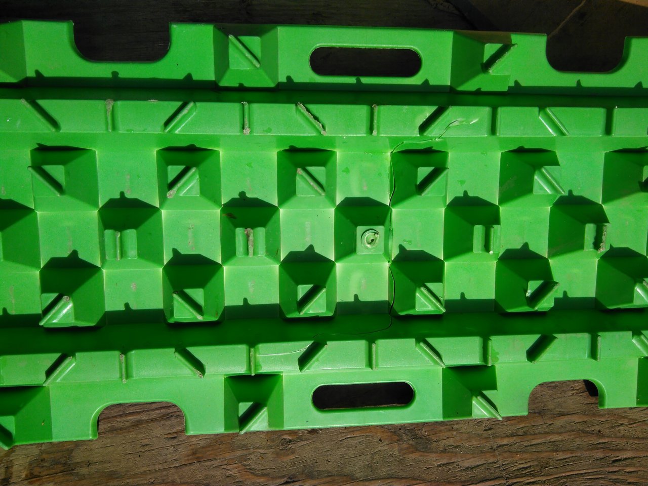

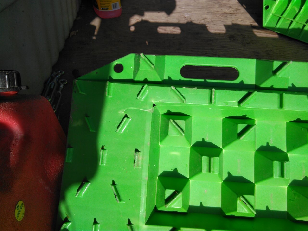

    This caused some of my cheap recovery boards to poop the bed, I have used and used them so it does not surprise me. I heard the one fail it was pretty loud cracking popping noise when it happened. One broke in 2 places, one just cracked in a single place. Time for a new set of 2.
