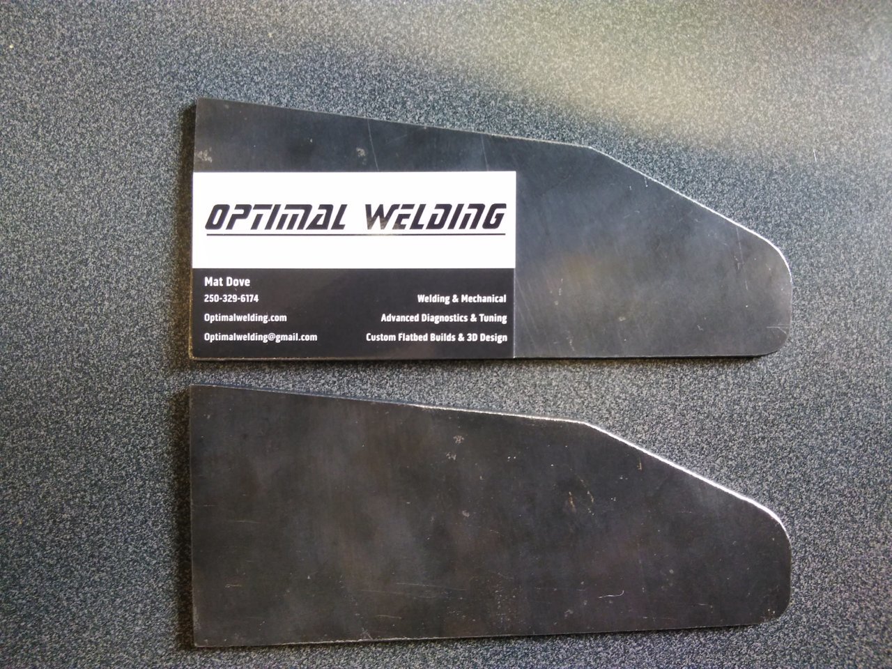

    Going to get the 2nd one of these finished up, so I can then put them on my rig this weekend.
    This will allow me to ensure they are correctly fitting before I pass the template onto other TW members :cookiemonster:

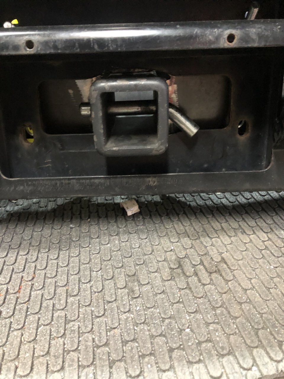

    Glad I decided to clean up the brakes and put some anti-seize on the pins. Got them done at a 'shop' and they only put the top pin through one pad on the passenger side. Had to dremel the pad to make it flush again after correcting it. :facepalm:

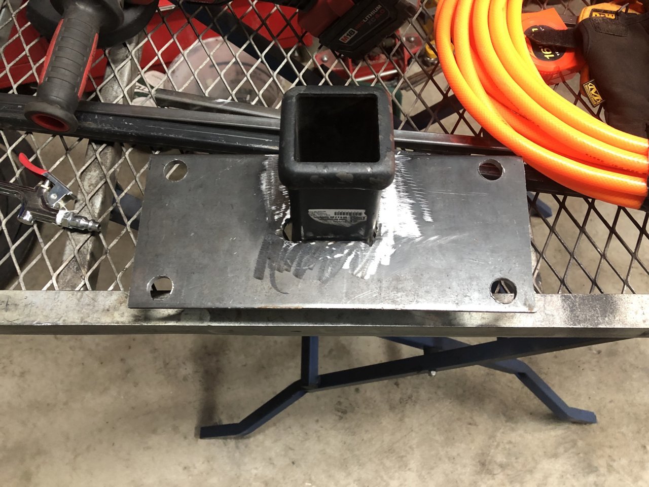

    Going to be dumping photos here for ya. Rainy day out my way so perfect for working in the garage.
    Base plate is 1/4” and it will be gusseted. The holes aren’t perfect but I’ll be making you some heavy duty washers. I will also be giving you some hardware as a guide. Just have to get it in grade 8.
    I will be cleaning it up a bit more. This is just roughed out. Let me know what you think.

  14. Apr 29, 2019 at 5:18 PM
    #154
    llamasmurf
    llamasmurf [OP] Herpa Derp
    Mar 1, 2016
    #179866
    5,176
    Wes
    Northern Ontario
    '15 Matte Black TRD AC
    FJ t-case with twin sticks, UTE bed, some other things :D
    :cookiemonster:
    That looks great :headbang:

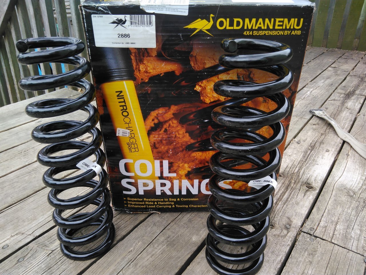

    886's and All-Pro rear stainless steel lines went in last night. I guess the front had sagged a bit like @Norilsk said it would with 885's and that mobtown bar :wink:
    (Height messured from center of wheel to edge of fender, I have no fender flares on my truck currently)
    OME 885: 395mm in height 590 pound spring rate - 55 CM 21.65 Inches
    OME 886: 402mm in height 660 pound spring rate - 58.5 CM 23.0315 Inches
    :transformer:
