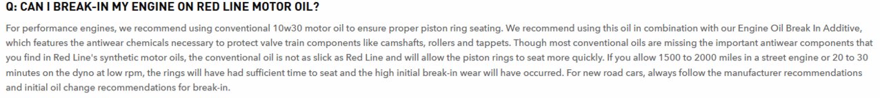

    FYI, this is what Red Line has to say about it:
    zoo truck[QUOTED] likes this.

    Pretty much what I mention.
    BillyE[QUOTED] likes this.

    That really wasn't the point I was trying to make but there is some sense in using an additive in certain cases. If you're breaking in a flat tappet cam, it's a necessity. Oils have reduced ZDDP in recent decades to reduce catalyst poisoning.
