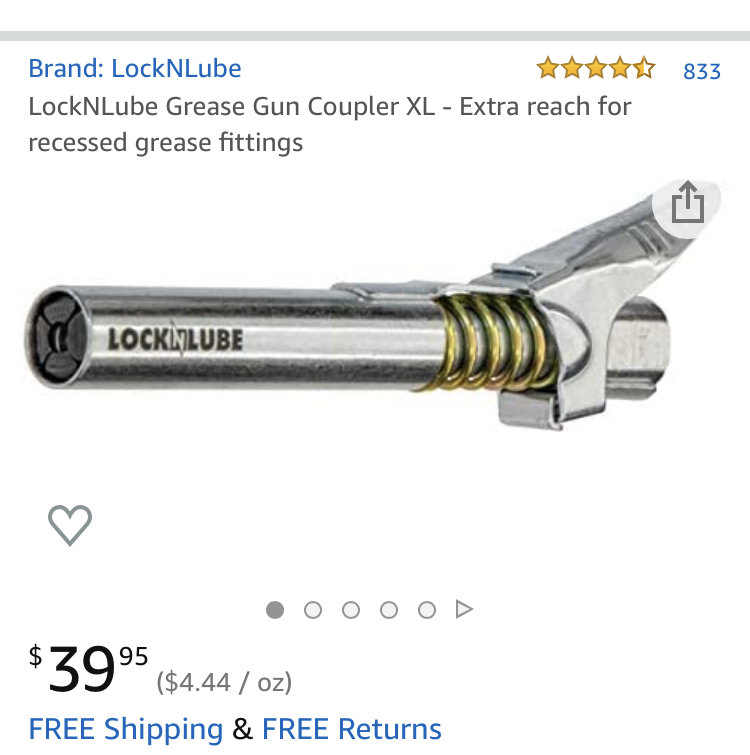

    I use one of these. Makes connecting to the zerks way easier.

    didnt need that. standad gun hit them all. Apparently needed to do some torquing as well

    I was looking at those , didn’t know how well they would work actually

    Used it this weekend for the first time. Worked great.

    Hmm I might have to get one , you had no issues with it being longer ?

    No, that made it easier to get to the front ujoint zerks that are inside of the spider.
