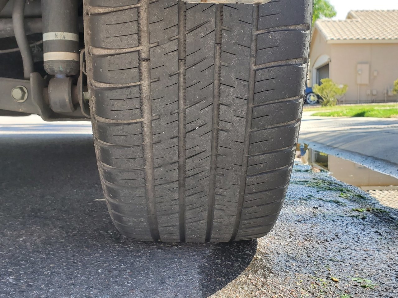

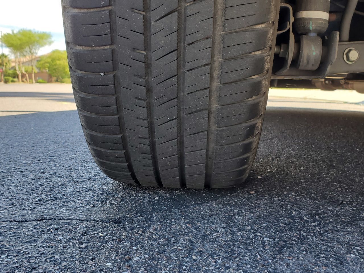

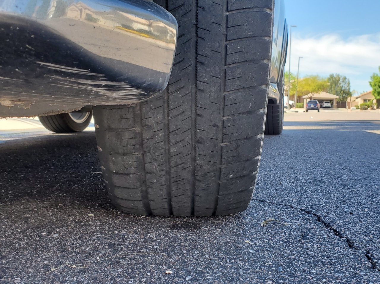

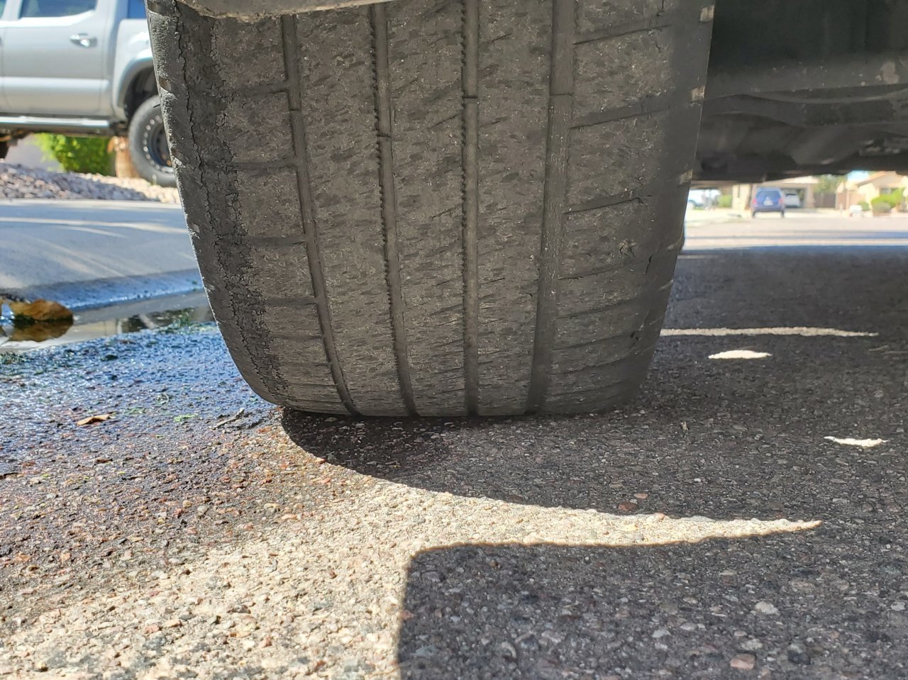

    Dacon
    Dacon [OP] 2017 Tacoma TRD PRO Quikrete
    Dec 20, 2016
    #205354
    2,932
    Danny
    Gilbert, Arizona.
    2017 TRD PRO DCSB. DOP 02.20.2017
    TRD PRO Cement 2017 TRD CAI and AFE Magnum Flow Dry Air Filter Camburg KINETIK Series Billet UCA Icon LCA skid plates Icon Coilover extended travel shocks with 700# springs Icon 2" rear shocks Icon RXT leaf springs full pack (new rims and tires soon)
    Daylight came and pictures available as promised. Not sure is the alignment, although FRONT RIGHT tire has the most wear. Car tracks straight. Will take the pictures to the alignment shop that did the alignment on all our vehicles.
    Front Right
    Front Left
    Rear Right
    Rear Left

    Clearwater Bill
    Clearwater Bill Never answer an anonymous letter
    Oct 11, 2014
    #140097
    24,592
    Billy
    Largo Florida
    '13 5 lug AC w/convenience package
    A few OE parts from fancy trucks
    The wear on the RF is indicative of hard cornering to the left. If you've ever run a skid pad, you'll know it's easier to turn hard to the left (driver side) and and stay tight to the cones than turning to the right. Has to do with vision and body roll.
    Of course the same is true on cornering on the street. Drivers typically feel more sure of themselves turning left than right.
    Unfortunately as a teen dear old dad pointed out the aggressiveness of my driving of mom's sedan with similar, though not as far gone, tire wear. Not from being on a skidpad, on the street.
    The wear of the other tires also indicates lack of rotations.
    There *may* be an alignment problem, but based on those photos I'd lean towards not.
