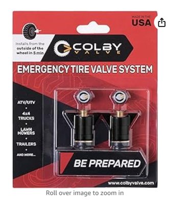

    the one i have (never been used tread full) is cracked bad between the treads and they say if you run highway speeds like that it can be deadly. you made me realise though, instead of time and money to replace (just to upgrade wheels and suspension down the rd anyway) i might be able to get it to a shop on my super cracked and dry spare, only kicker is is if youre trying to get home from a long trip and its after hours or something from when shops are open
    i have a good tire repair plug kit, and a viair compressor (88p), and these in my truck at all time though
