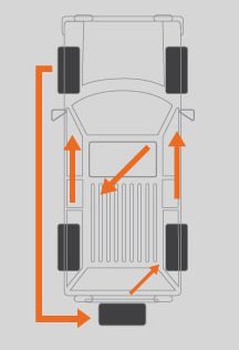

    Could do a 5-wheel rotation Jeep style.
    This is the one I do.
    Then you know your spare is in good shape :)

  5. Dec 12, 2024 at 9:25 AM
    #25
    SH10151
    SH10151 Farang
    Apr 10, 2018
    #250059
    3,187
    SF Bay Area
    2022 SR AC UP 4x4
    This is something you would have to do yourself because the dealer or tire shop will never do, too much effort for them.
    I used to mark my tires for when I would swap out my summer and winter wheels, and you would be surprised, or maybe not, how many times after telling me they did a tire rotation they actually didn’t.

    100%. The shop I go to will if I throw the spare in the bed, but dropping and re-raising it under there - doubt it. I just do it at home. You'll need to reprogram the TPMS as well, at least in my 2020. I have the pressure readout on the dash, but I don't think the TPMS system looks for the spare at all on second or turd gens.
