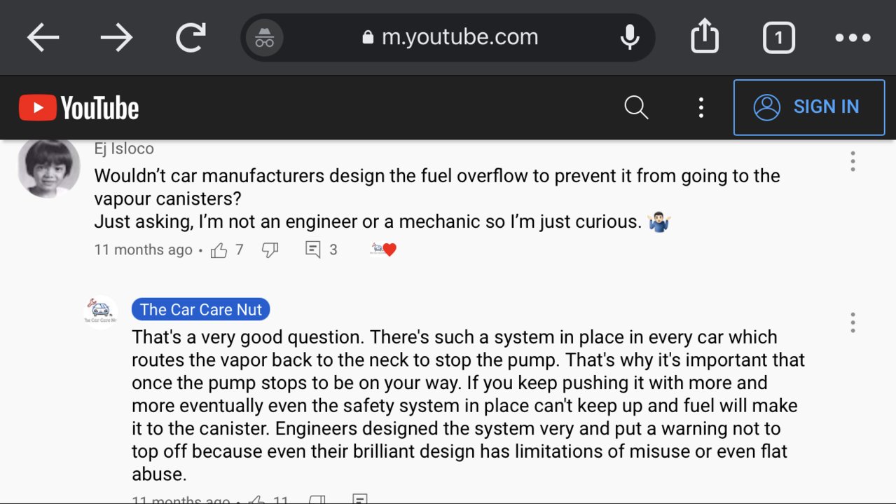

    I wanna know how much cash youtuber The Car Care Nut made by letting people know that they're stupid

    yes, that guy sounds smart. What's not taken into consideration is the fact that there is a cut-off valve, and the evap canister takes suction from the top of the tank. With where the fill tube comes into the tanks, there are still a decent margin before the tank is completely "full", thus no chance of liquid fuel from making it into the evap canister. I still don't think it's worth "topping off" the tank, not for the reasons he describes but just because it's not buying you very much.

    In 45 years driving I’ve never had this happen. You probably almost have to force the nozzle trigger to full flow after it kicked off, you’re crazy if you do that but I guess some do. From the youtube channel for that video:
