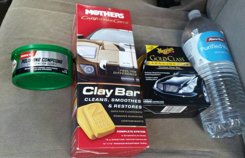

    How's this guys? Had the turtle wax polish. Only clay bars I saw, and megiors was the only wax that wasn't cleaner wax besides some off brand stuff. The water is not part of this, just had it in the seat when I took the pic.

    those are great off the shelf items however if you look online you can get a much higher quality grade of items.
    http://www.detailedimage.com/

    Gold Class is a good off-the-shelf wax. It's what I use for "normal" wash/waxes. I use other stuff for my full details.
    The clay bar is a great product, but don't be surprised if you find yourself going through both bars (I think that kit comes with 2). Your paint is going to have a lot of stuff in it if you've never done this before. I use quick detailer spray as my lubricant - better than water IMO and helps pick up the dirt that you've loosened, but not absorbed, with the clay.
    As far as washing, one of the best things you can do is the 2 bucket method. Your car wash/water mix in one bucket (I would never use dish soap, but that's not important), and then a bucket of water to rinse your mitt in after you've washed each panel. You'll be amazed what comes out of the mitt when you dunk it in the water. If you don't do that, you're just introducing the dirt and crap that you've just cleaned off your car into the soap bucket, and putting them back on your car.
    Good luck! And for that polish to be worthwhile, you're gonna need a buffer.
