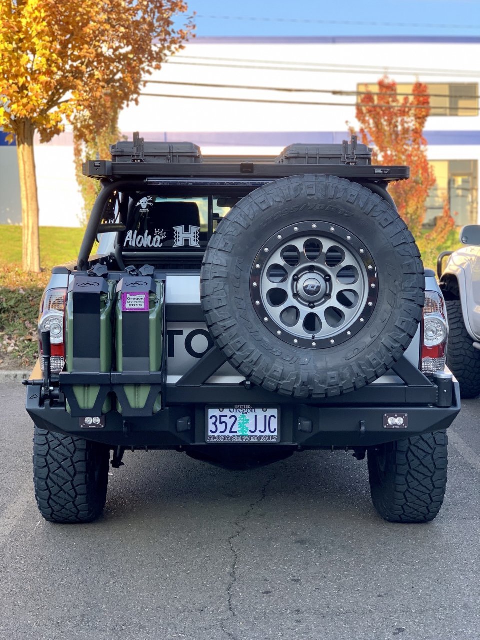

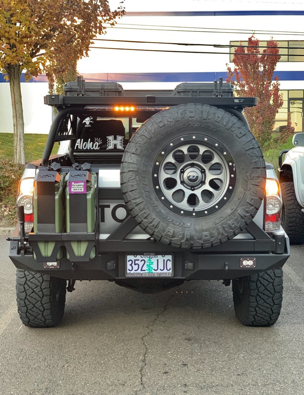

    Here’s a pic of my RTL-S for others to see what it looks like and have a better idea of what they’re getting. So far it’s been a great addition to the rig. It’s performing well and withstood several power washes.
    I also like how it doesn’t attract too much attention when it’s not running. Full disclosure, I did smoke the lens with laminex film to make it less noticeable.
