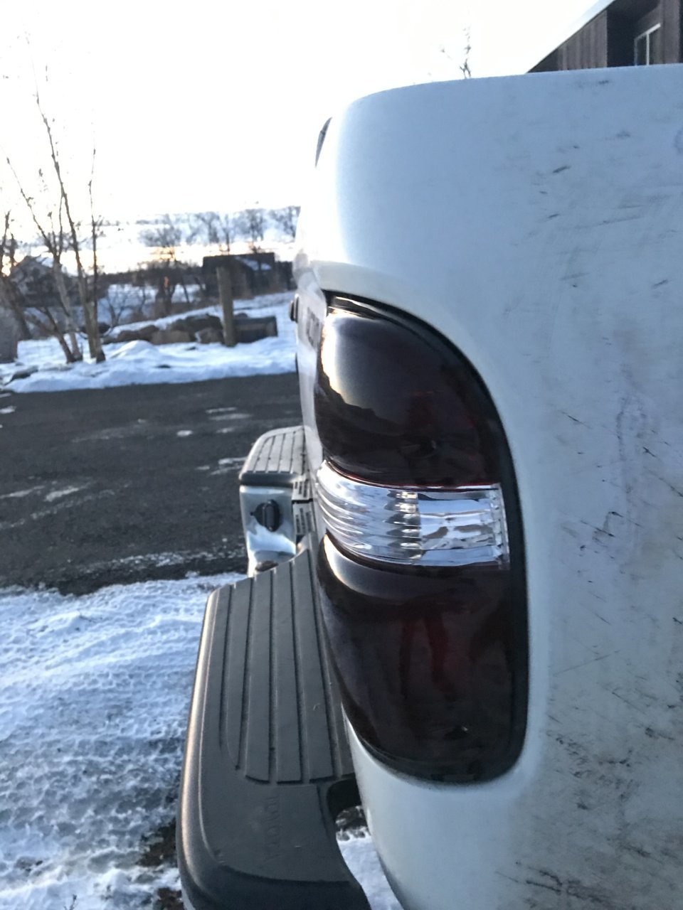

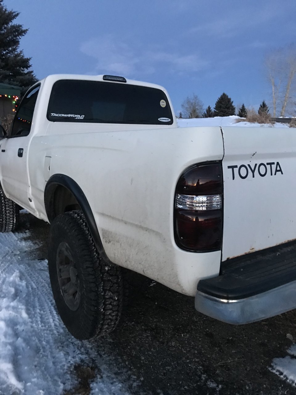

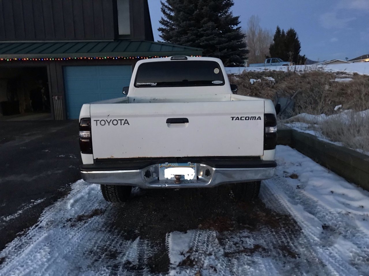

    :yay:Had these taillights for a while, and finally got around to putting them on my truck. They’re 01-04 blacked out taillights I got around a year back. Found a guy on Instagram with some of these on his 99 Tacoma and he said they worked fine so I finally got around to putting them on the other day. They hook right up to the factory harness and they screw into the factory holes no problem.

    Thanks for posting. I was considering putting 01-04 tail lights on my 95 Tacoma but even after multiple confirmations I was not convinced they will look right. I have clear (milky) white/red covers but wanted clear (clear) transparent / red that is available only on 01+ style.
    Question: does 01+ lens fit into 95-00 lamp? Or while mounting screws are in the same location the shpe of lens-lamp connecting surface is different? Simply saying can you just swap lenses between years having the original lamp not replaced?

    Actually the 01+ lens does fit into the 95-00 lamp, I tried this as a result of me just being lazy and the screws line up in the same spot and everything but I’m not sure why you would do this because a new housing is always better. One defect of using the 01-04 lens and not the housing is that it won’t reflect the same way, and you also have to remove the little plastic piece on the inside of the housing that of which covers the backup light so it only takes up a part of the light. But to answer your question, yes it does, but it probably won’t look the best.
