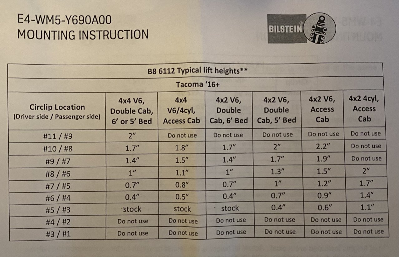

    Just received some Bilstein 6112 and noticed they come with 11 circlips now instead of 6. The retailer has informed me that Bilstein just made these changes and these new versions will supersede the previous version with 6 circlips. So now if you want a 2” lift, you have to have the circlips set to 11/9. Which sucks because when I ordered these preassembled, I requested a 6/5 circlip setting. With these changes, it would’ve gave me a 0.4” lift lol.
    was anyone aware of these changes?

    OP can you provide the Bilstein P/N you received (not the vendor #)? I am expecting 47-234413, should arrive later today. Bilstein-US posted install instuctions still show 6 circlip slots. Plus its weird that they would have a Tacoma specific product with multiple slot configurations that should not be used on any Tacoma, that makes no sense - wondering if they are reacting to supply chain issues in a sketchy way. If you change thread title to something like '11 slot Bilstein 6112' your thread will gain traction, right now looks like just another 6112 comment. good luck!

    The part number my set has is 24-309981. I found someone else on Reddit that received the same set as me and he said that he reached out to Bilstein directly and the Bilstein product management team informed him that these are the new shocks for the 3rd gen Tacoma. They were confused as well but said he got them before their official release which is why it's not in their online catalog yet. So it seems like these will be the new 6112s going forward.

    Going through this right now too. I ordered on 4/9 and got them on 4/25. I unboxed them and was surprised to find the 11 Clip 6112 shocks. They were also both assembled on the 11th clip (driver and passenger). Passenger side is supposed to be set to clip # 9 per Bilstein. Wheeler's is in the process of getting me a return label so they can rework the shock for me. Stinks that is was wrong, but I am glad they are owning it and going to fix it. Very little information out there on this change. I am pretty sure the update was so that Bilstein could supply one shock for both Tacoma and 4Runner applications.

    6/5 settings / new settings are 11/9 for 2” of lift

    Dude it takes like 5 minutes to change the circlips on each side. While you're installing them, put it in, put the bottom bolt in and jack it up under the LCA. When it's compressed, pull the center nut on the top of the hat. Slowly lower the jack and then you can move the clip down with a pair of pliers.
