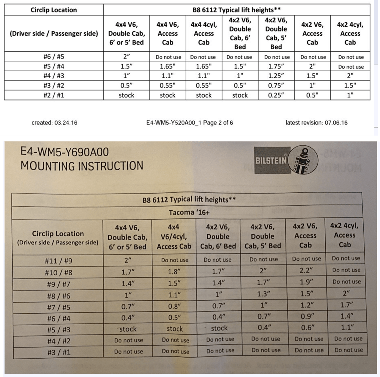

    The lift for the new 11 circlip model is one page back at the very start of this thread. I've re-attached it here as well as the 6 setting version for comparison.
    Note I did not get the advertised 1.7" on my 10/8 setting. I am not stock but don't have a ton of weight either. No winch, still have stock front bumper. Main weight is sliders. In order to get 1.5" to 1.7" I had to upgrade to the 650# springs. That was a bit frustrating. I even called Bilstein and they said you will get what is advertised unless you have a winch or have added a heavy offroad front bumper. I only ended up with about 1" with the 600# springs they provided.
    As always YMMV.
    As for the ride, mine at 10/8 rides like a dream. Look up "Tinkerers Adventures" about lifts, preloads on springs, and harsh rides. It isn't about how much preload you have, it is how much up/down travel do you have left after the pre-load. It can cause you to top out or bottom out on the shock.

    Thank you for posting the chart for the Bilstein shocks settings. Nice to know what each adjustment means to us.

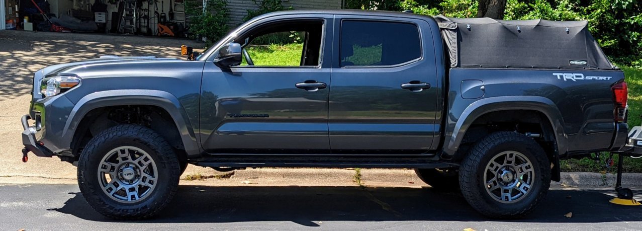

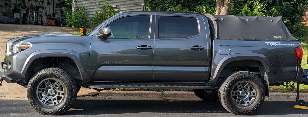

    Here's a visual difference on the old 6 position shock, 5/4 vs 4/3:
    5/4
    4/3
    It really is about 0.5 inch per clip as advertised. The difference is barely noticable, but I could tell, looks, driver's sight lines, and road feel. It's subtle, but there's a difference.

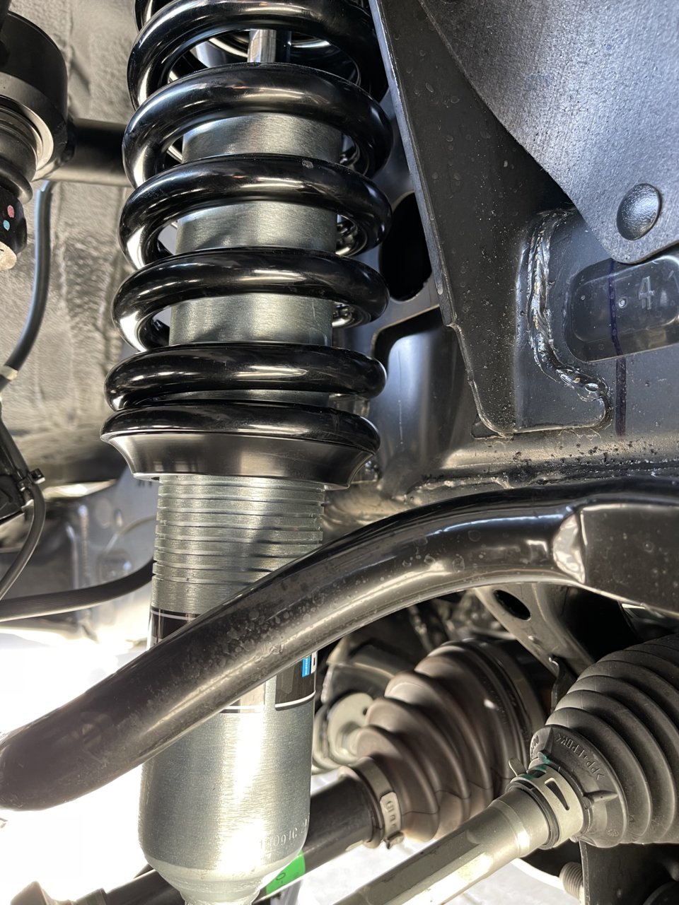

    Here’s a pic for reference. Tripped me out when I looked under and started counting the lines.
