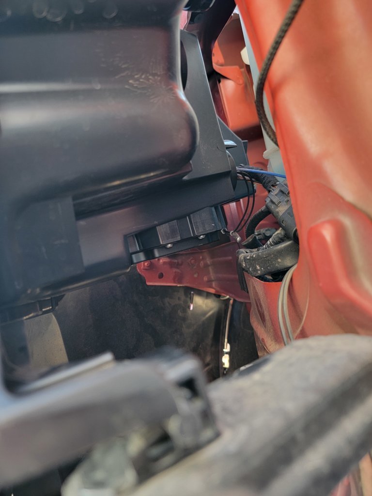

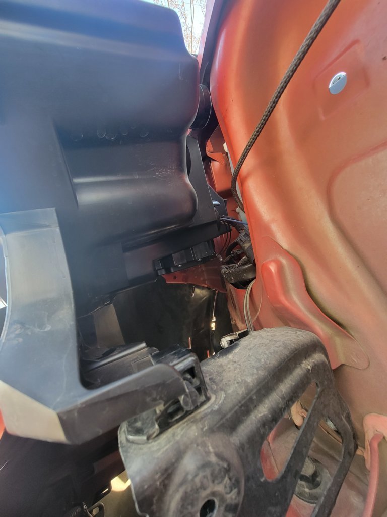

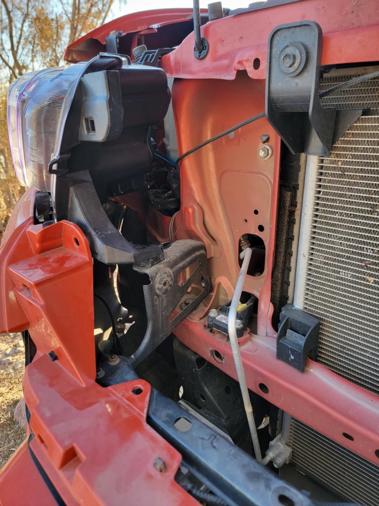

    Well, I got the supercharger installed on passenger side. Just did the passenger side in hopes I can get some good comparison shots between the two when it gets dark. Just too cold to sit out there and mess with installing and setting up a camera to take before/after pics with both..
    For now I just wanted to share some install tips, since this was only my second time removing the front end. When I initially installed the evos, I removed the grille and bumper. This time I was just going to loosen the bumper to access the side bolt of assembly behind bumper and remove assembly. All was going well and was MUCH quicker/easier doing it that way. Until I went to slide the headlight out/away, and my hand slipped, annnnd I SCRATCHED THE DANGED LENS!!! ARGH!!! So pissed I did that. Sigh..
    :annoyed::frusty::facepalm::mad::mad::mad:
    So I stopped and placed the headlight back in place. Kicked myself a few times. Then looked inside to see if I could manage to access the driver without having to remove the whole assembly. There was a ton of room after removing the radiator air deflector (very easy to remove) to get a stubby screwdriver (even a regular screwdriver fits but stubby is recommended) in there and remove the screws. Took a little fenagling and awkward body twisting to get to the connectors without yanking or putting stress on the wires, but it was doable. Installing the new driver and popping the connectors in was a little easier.. Definitely recommend doing it this way and not removing the bumper, or messing with removing the assemblies and risk scratching them like I did. And for anyone installing the Evo's for the 1st time, take care you don't scratch them on that fender corner. Ugh..
    Anyways, here's a few pics of the access area after the air deflector is removed. Will follow up after it gets darker and I get some output shots.

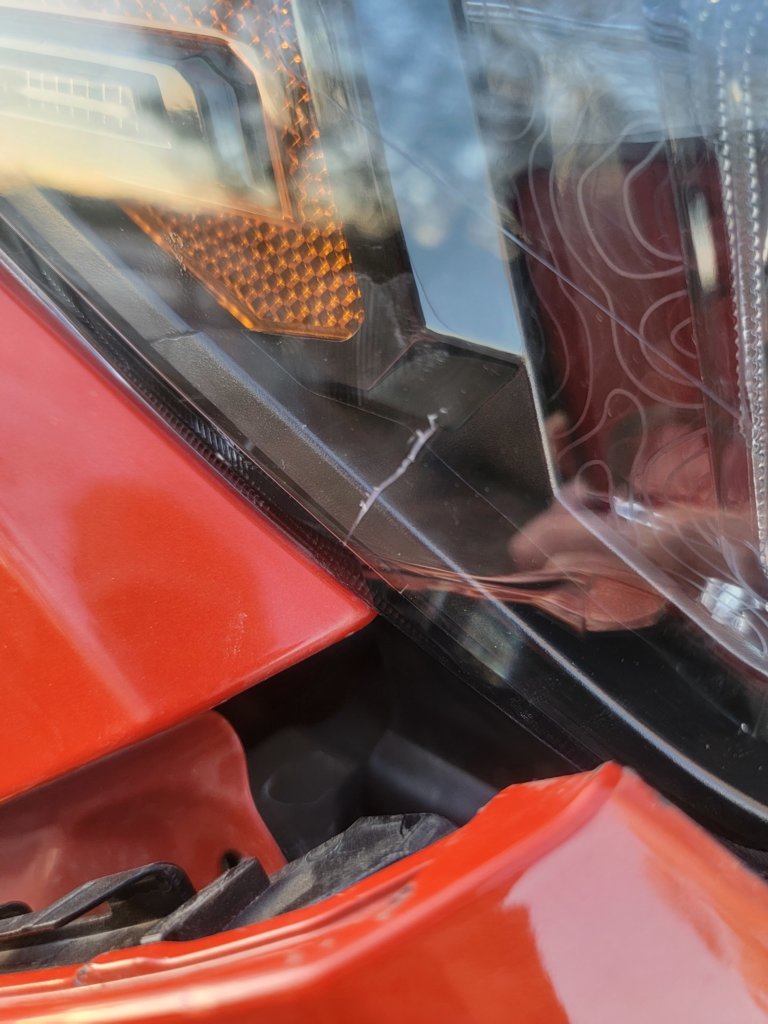

    Lesson learned for sure. Lol. I was confident in my ability to take great care with them when removing but alas, shit happens. I actually tried to slide them out of the bottom clip this time instead of pulling it out, and that was my mistake. Should've pulled them straight out like I did the first time. Oh well. Maybe i can get them to buff that scratch out when I get around to getting her in for a full ceramic coating.

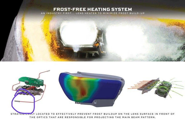

    I appreciate the data :) I'm not sure where the thermal sensor is, but you can trick it with compressed air.

    ha I was thinking that same thing. or an ice cube. or somethin. But no, its already nearly there. reading 42 rn. got a hard freeze warning. Low of 26 it says. Should be good.. Gonna freeze my balls off here in a bit tho:oops:. lol. I'm a desert rat and I hate the cold. Doin it for you guys tho! :luvya::rofl:
    Edit: oh wait, I totally forgot I have 1 dot driver and 1 supercharged driver in atm. Ugh. I guess I'll have to install the other driver when I get back from photos, for a better test result.. Dangit.

    It’s the metal probe off the back of the housing
