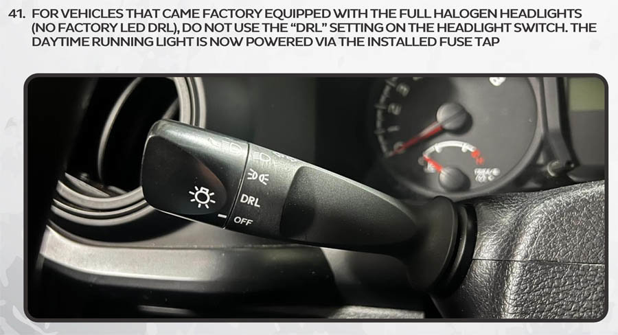

    You're a genius! I saw that in the instructions and was thinking it was just the setting on the column and not in the vehicle settings. Turning off the DRL settings in the vehicle settings resolved the problem with hyper flash.

    Yeah, it won’t make a difference for the XBs DRL, that was just a solution to fix the hyperflash on the SRs.

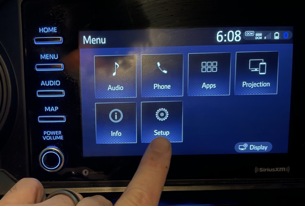

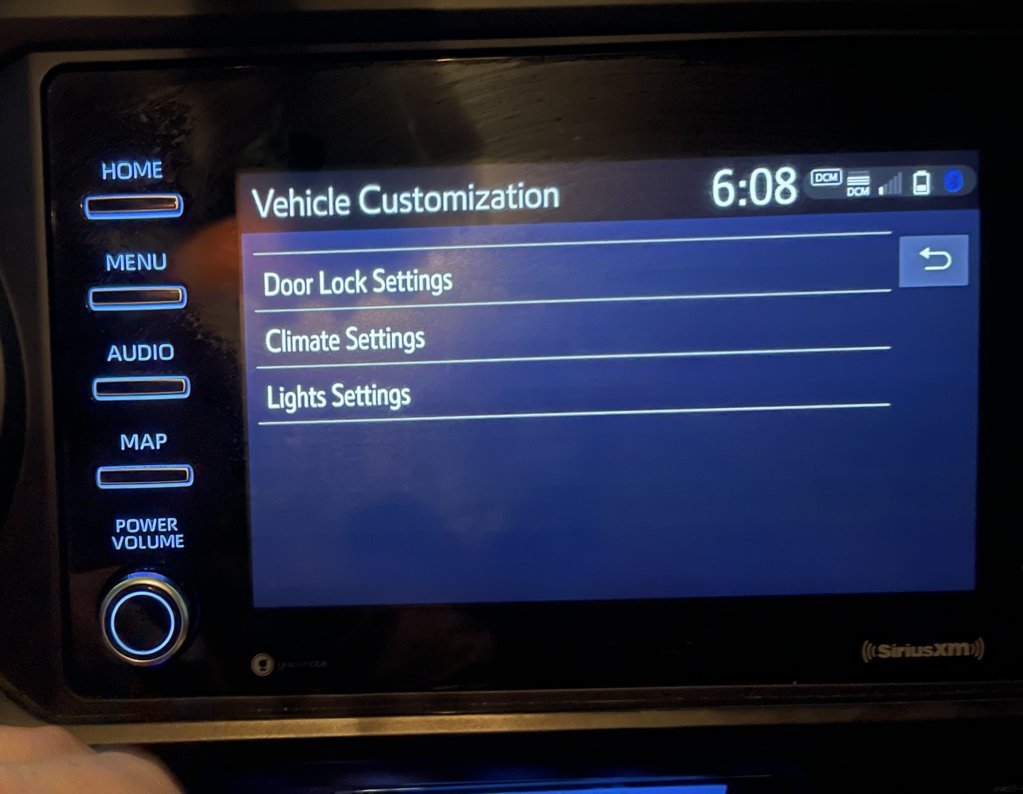

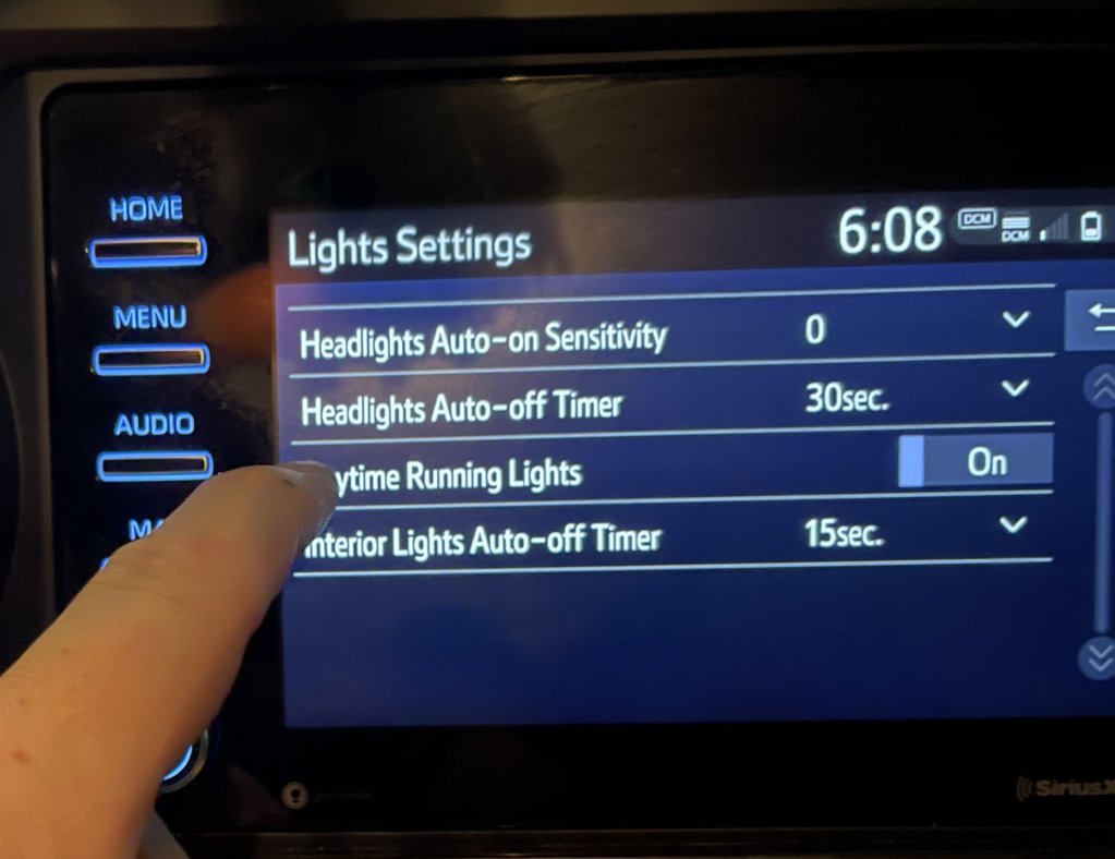

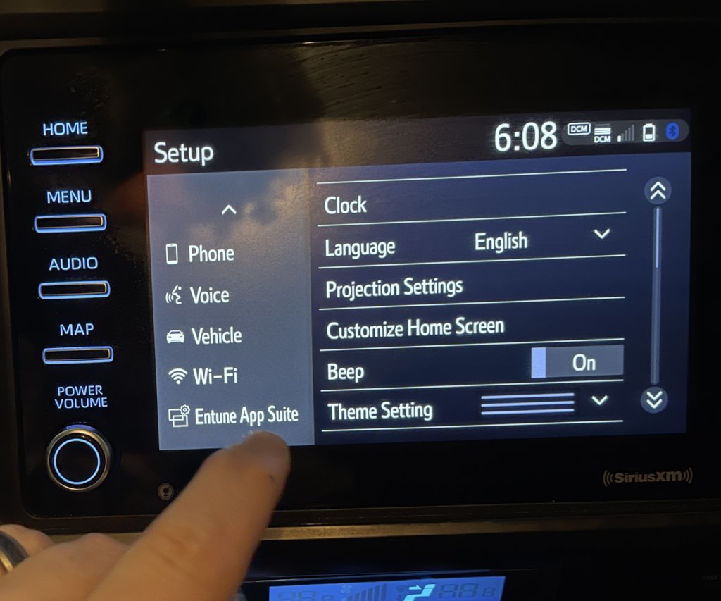

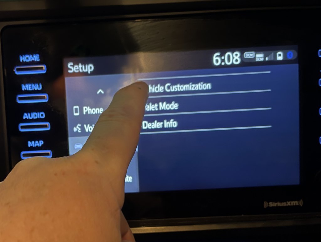

    And if anyone needs it, here is how to disable the DRL (at least on a 2020. My coworkers is the only one I’ve done this on, and his is an SR as well, so other trims might vary?)
    Main Menu>Set Up
    Engine App Suite>
    Vehicle>
    Vehicle Customization>
    Light Settings>
    Daytime Running Lights> ON/OFF
