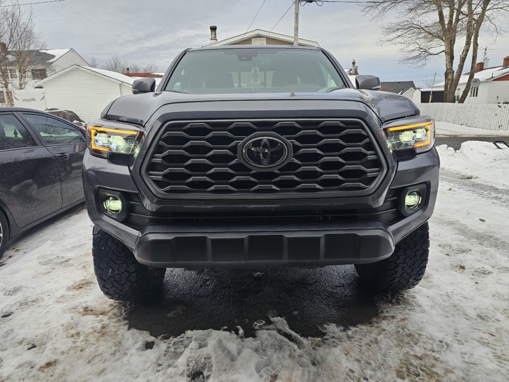

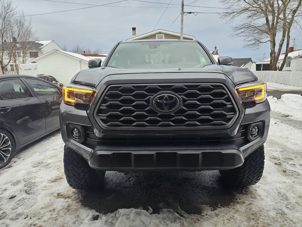

    Evo fogs too?
  5. Jan 19, 2025 at 1:12 PM
    #285
    devinzz1
    devinzz1 Well-Known Member
    Jun 28, 2014
    #132892
    7,010
    devin
    lewisporte Newfoundland
    2023 aclb trd or mt
    icon stage 10 kit, toytec 1" bl, 35" general x3s, 17x9.5 procomp wheels, locker anytime mod, s&b intake, blackhawk 2.1 tune,
    yes

    They do look good. I’m not much of an amber guy though, but if you’re into that kind of thing… :p

    adds contrast to a dull coloured truck. i do like we have the option to change colour on these tho. how it should of always been if they dont mind me saying
