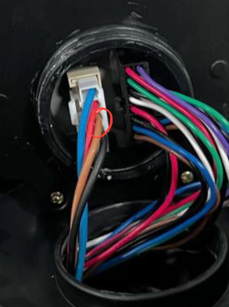

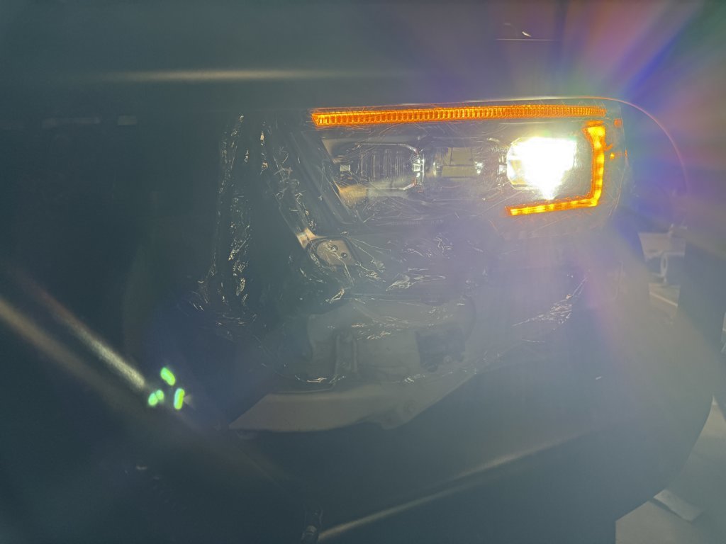

    Having trouble with my new XBs. 2017 Toyota Tacoma TRD OR 4x4 light set up from factory is halogen with LED drl.
    Current issue: low beams on driver side do NOT run.
    High beams turn on for both sides, the lights run through the start up sequence, then the drivers side low beams turn off afterwards. Drivers Red LED is on and solid.
    I’ve checked the 10 amp Low beams fuses for continuity and they’re good. I’ve checked continuity to the fuse tap prongs and they’re also good.
    I’ve switched the wire harnesses and the issue persists on the drivers side.
    Only thing I ran out of time to do today is swap the headlights from one end to the other. Any suggestions?

    Found a loose brown wire in the housing that went to the four pin connector inside of the LED drivers.
    However, now the low beams turn turns on, but only one of the two projectors turn on specifically, the outer most beam on the drivers side. Weird

    Update: sending Morimoto support photos and videos. They said that they might just warranty them out. Here’s to hoping!

    I will check with the team who is handling the case, sorry I wasn't around here much Loose wire seems to be a manufacturing error CS hasn't respond yet?. I will poke them what's going on @NightProwler about brake / hyper flash issue, swap resister made issue follow indicating some insufficient load at that resister. What's the tail light you are running? stock? Share a list up findings, I will forward them to the team to assign CS
