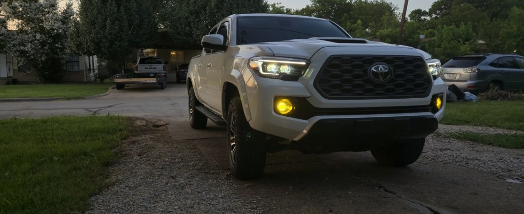

    Got my EVO Hybrid set installed, paired with Diodide Dynamica Elite Series Yellow Fogs. Adjusted them since they looked to be aimed low. Going to monitor and adjust them accordingly. Overall I'm happy with the set lights.

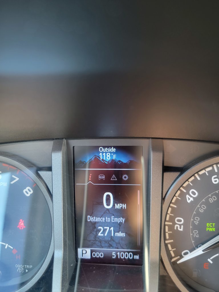

    I just got my replacement evos and swapped them out last night. Was talking to both morimoto and trs about my hyperflash issue for a while now. Trs sent me new resistors to try out, which did not correct the issue. So morimoto went ahead with sending new ones and rma'd my other ones today.
    So far so good!! Really not sure what was causing the hyperflash but it seems to be fixed!! I thought it was due to the heat with temps increasing here in az (since i installed them around wintertime) and the worsening progression of it over time SEEMED to correlate, but its 118° today (was 120 a bit ago) and no issues driving around!!
