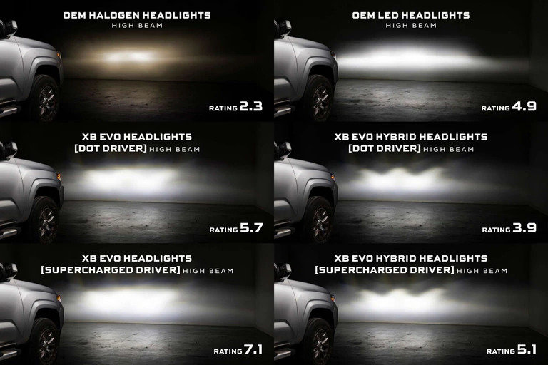

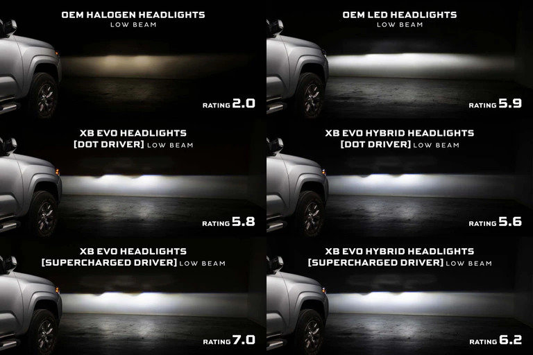

    They’re pretty comparable on low beams with better high beams. Then there’s the SC drivers, which bumps them to better low beams than stock LEDs and even more intense high beams.
    This rating system uses a variety of measurements to achieve a final summarized score. More info on the testing process: https://www.morimotohid.com/multipoint

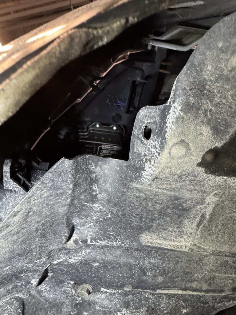

    So the drivers are totally accessible! Just need to peel back the fender liner. I have a viper cut so mine is modded and I can see it much easier
