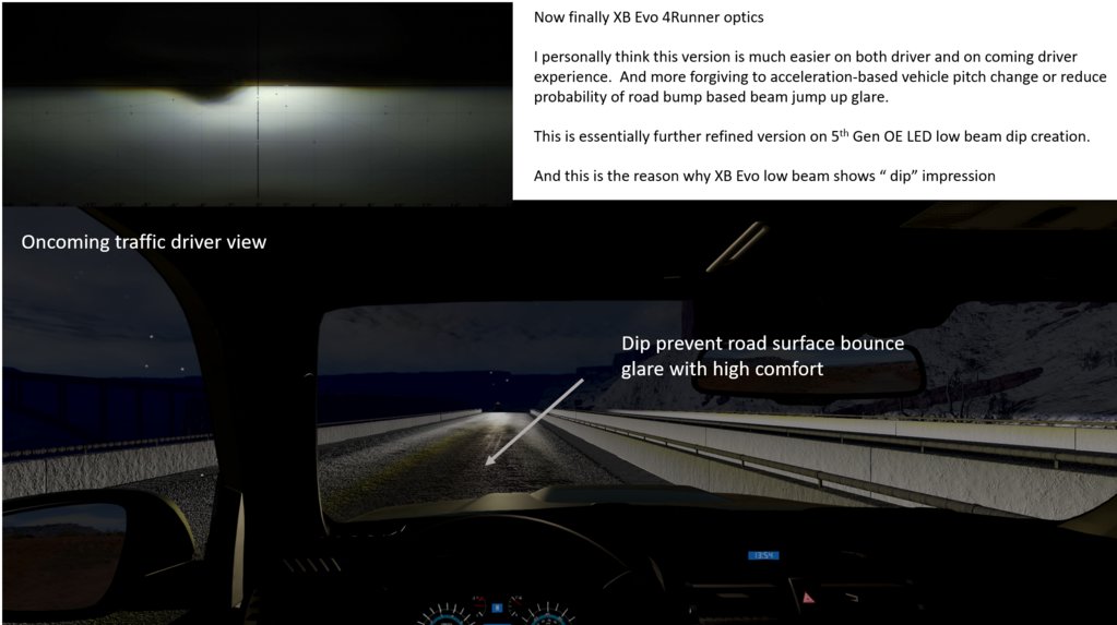

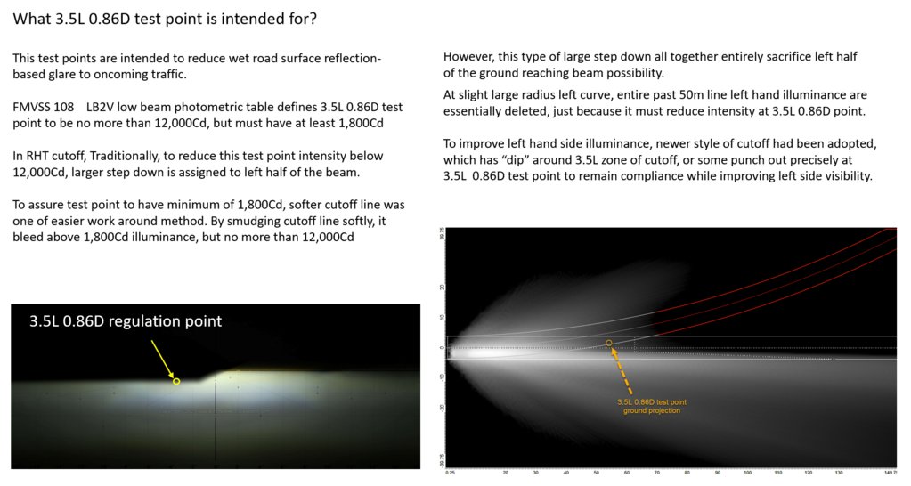

    Low spot is FMVSS 108 LB2V low beam regulation defined control point, this is to prevent wet road surface reflection based glare and also to reduce vehicle pitch shift related direct glare probability. And what you are seeing is how exactly is designed for very strongly well intended reason.
    Plz do not attempt adjust aiming other than VOR aiming protocol, there has nothing to do with this control point.
    It is very important to follow correct aiming method. Essentially, both beam is straight forward axis, both beam cutoff height is 2" below lamp height at 25' ( if you won't have any load on bed or mostly driving without passenger on back seat, and fully stock height, you can aim at same height as lamp mount height) If you have fitted larger tires or lifted, 3" down at25' is required.
    About "dip" low spot
    There had been very frequent confusion about this type of advanced VOR cutoff style, but there is immense advantage over outdated classic step down cutoff( which many is accustomed to and calls outdated standard as "clean")
    Perhaps, it is best to provide below visual to guide for those who aren't familiar with new type of cutoff.
    Since there are large amount of information to explain, I have made detailed explanation available for community, please find PowerPoint presentation via below link
    https://docs.google.com/presentatio...ouid=106785414004260995300&rtpof=true&sd=true
    Lmk if there is any access issues.
    For those who just want to grasp visual note, here is some key aspect visualized below (all in powerPoint)
    Page 3 shows the exact reason why I adopted this type of cutoff style.
    Also full anatomy of upper illumination is explained, all are fully intentional for deep consideration, respect to regulation compliance.
    Once you review presentation, then you may have this questions.
    Why some OE optics can get away without this pronounced dip? answer is simply due to OE optics are much lower intensity.
    For example, OE LED reflector does NOT have as pronounced dip shading as XB Evo headlamp, but this is because OE LED reflector distance zone(near cutoff) center intensity is only about half of what XB Evo outputs.
    In this case, as long as defined test points remain under 12000Cd limit, it can still pass as compliant beam design.
    However, high potency headlamp that project much stronger beam, dip shading contrast naturally become higher, this is another reason many may notice more than some of other OE design.
