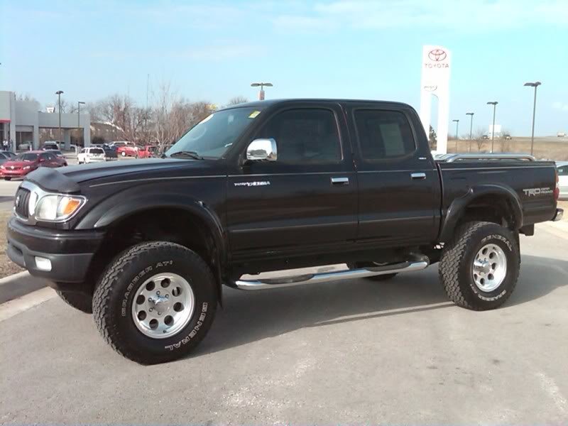

    I finally found a 1st gen DC that met my search criteria. This one was a trade in at the Toyota dealership. Traded in on a Friday, sales person called me, and I bought it the next morning!
    It seems to be in really good shape. Definitely hasn't been beat on. Lift was installed by dealership (Revtec), but i'm not a fan of the body lift..... :eek:
    I have some pretty big plans for this truck, but one of the things I'm having trouble locating is a rear winch bumper.
    I realize this will be a custom piece, but does anyone on here have anything like that?
    I would also like a rear swing out tire carrier/jerry can holder as well. Something similar to this:
    http://www.tacomaworld.com/forum/armor-tech-offroad/94554-latest-full-rear-bumper-build-ato.html
    Any suggestions are appreciated!

    Hey guys, thanks for the replies! Today has been really busy for me, but I'll have more time to update this tomorrow.
    I'm attaching a pic of my truck when I first saw it sitting on the dealer's lot. I live near Tulsa, btw.
    I've actually built several rigs in the past that I'll post up too. My wife and I love to explore Western Colorado and Utah. This build will be centered around expedition/adventure travel, so reliability trumps crawl capabilities. Part of the reason why I wanted a 1st Gen DC!

    So the truck had a body lift too? It kinda just looks like a spacer lift by the photo (revtek).
    As far as the rear winch bumper goes: just buy a winch cradle that plugs into your rear hitch. that will save you big bucks and you still get the winching.
    Also - I had the revtek spacer lift before I upgraded to 2.5" coilovers. You will have a much smoother ride if you consider alternatives.

    It has a Revtek spacer lift (3" I think?) and what looks to be a 2-3" bodylift. I've had body lifts on fullsize vehicles in the past, and it looks like this one was at least done right... Gap guards all around, and everything has been properly extended.
    I would like to get rid of the body lift, but since I didn't put it on, i'm afraid it would be a ton of work to try and get that off and back to stock....
    A true coilover lift is in the works, along with the correct UCAs as well. It actually rides pretty good right now, so I can only imagine how nice it will be with a REAL lift on it!
    The tires are 285/75/16 General Grabber AT2s, and are almost new, so they'll stay on there for a while. Seems like a pretty decent tire too.
