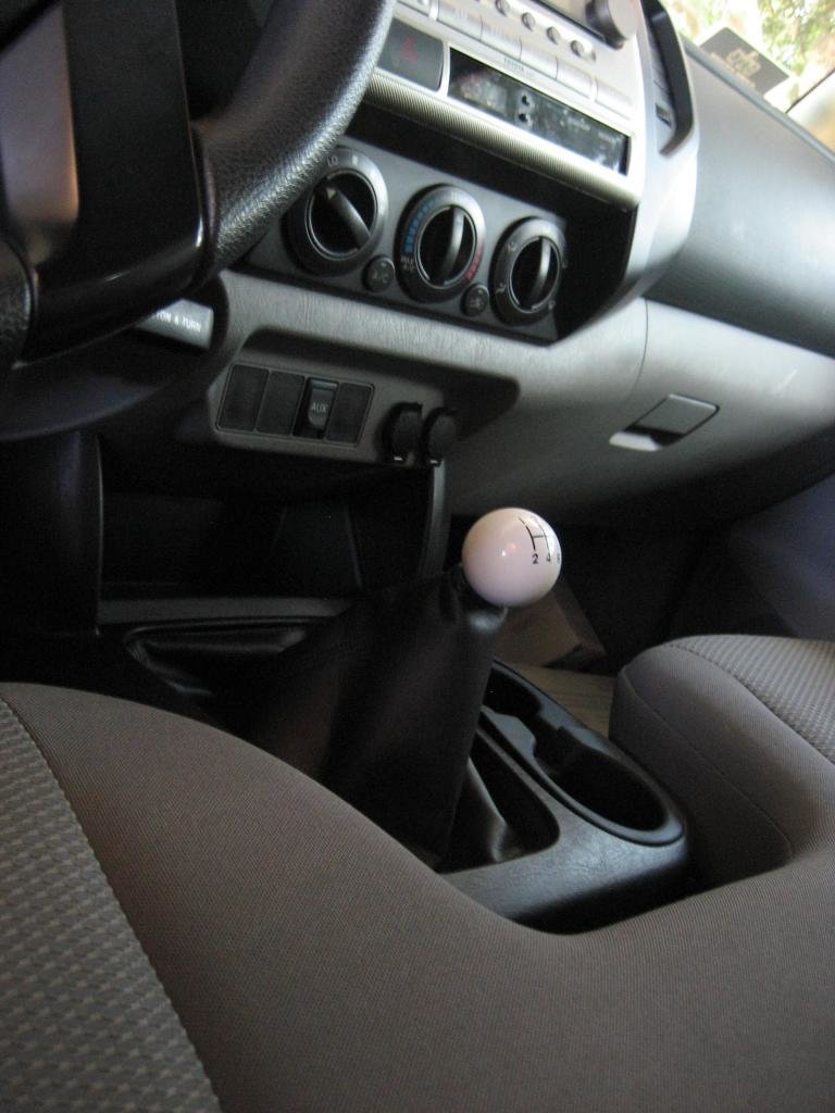

    I've been driving Toyota stick shift trucks for 25 years, and they're all notchier than cars. This is due to the shift lever being directly attached to the top of transmission with no intermediary linkage, so there is less leverage over the shifting forks. This design has not changed in 25 years. How do I know this? I recently sold the shortened shifter I kept from my 1988 typyta pickup and it had the same ball and socket setup as my 2012. the only difference was a small slightly rectangular 4 bolt mounting plate. I also have the shortened shifter I kept from my 1996 Tacoma It uses the same sprung ring to attach as my 2012.
    A 17 year old shift lever fits perfectly in my 2012 because they still use the SAME shifter design.
    What you described sounds like the clutch is not fully disengaging. That makes the synchros want to reject the first to second gear selection. There is increased resistance because the synchros are keeping the partially engaged gears from grinding.
    Also, have you checked the fluid level in your trans yourself? It's not rocket science. You remove a plug and stick your pinky finger in the hole. If it comes out oily, your trans is full. Check the linkage to your clutch cylinder. Is there any play that prevents full disengagement? Bleed the fluid line between the cylinder and the clutch slave unit. Air in the line compressing can reduce the pedal stroke and prevent full disengagement.
    You need to first try to find out for yourself what's wrong... before you take it to a dealer. They're the last resort. Also try an old timer independent Toyota mechanic. Let him drive it. This shit hasn't changed in decades, so he'll know exactly what's going on. :)

    Yes, and it's also very heavily weighted to keep it from resonating with the transmission's vibrations. Being directly connected, there is no possibility for any isolation between the lever and the transmission.

    Thanks. I love my short shifter and am totally happy it fits the new truck.
    It's notchy, but has super positive short throws and feels really solid and precise... and I like that. :)

    so i can put the shorter 1996 taco's stick on my 2013…? ...i might have to do this….
    I dont have any problems w my '13 6-speed *knock on wood* but the shorter shift lever and maybe throw in a short-shifter… may be a winner combo for my liking!
    is the thread on the knob still 12mm x 1.25 ?

    Not sure if there is a difference, but tooter is a 5 speed and you are a 6 speed. The TRD short throw is a bit pricey, but a great accessory.

    Sorry, I don't know anything about the 6 speeds. As others said, this is on the 5 speed transmission which has been basically the same design since the 22R 1980's.
    This was the the shifter from my 1988.
    It uses exactly the same plastic "foot" and ball socket as my 2012 except the retainer is different. My shortened 1996 shifter has exactly the same round rotating spring loaded retainer as my 2012, and went right in. :)
    I cut the shifter short myself and ground the top down so that the brass threads of the Hurst cue ball shift knob would grab it tightly. Then I put some silicone caulk in it and screwed it on and let it dry. The knob stays on and doesn't twist and yet can still be removed cleanly with some brute force.

    That's pretty cool about using the older shifters. If anyone has theirs break or become loose this is a cheaper option then replacing with stock.
