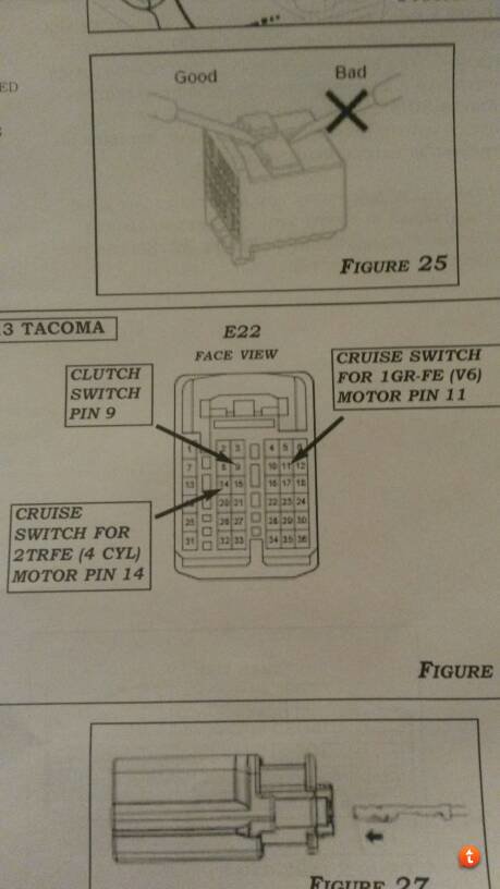

    I just picked up a 2014 4cyl 4x4 base model last night....no CRUISE...how can I figure out if it is pre wired for cruise? and how do I install...I already did a search...but I'm wondering if anything has changed for 2014...

    My 2014 access cab was pre wired...if I can find my installation instructions I can give you the pin numbers that the wires go to (at the ECM) and you could check to see if the wires are already there. I'll try to find them tonight. I had already half way wired my Rostra kit when I realized my truck was pre wired (Rostra support assured me no new Tacomas are pre wired!). Wish I would have known to begin with because I would have at least ordered the original Toyota clutch switch as the Rostra unit is a PITA! Ended up having to do a bunch a wire cutting and soldering to get it in. You shouldn't have to deal with that though since you have an automatic. You could just order the stalk and install it....if it works then you are pre wired :)

    Here is probably the easiest place to find the wires if you are pre wired (you can also look under the steering column but requires a little more work):
    Locate the ECM by removing the glove box door. There will be a black connector(E22) to the right on the ECM...second from the bottom. Pull out this connector and check to see if there is a wire in pin 14(Brown I believe)ytumevyt_d5890659516980538b342ef85dedd3162af65c6a.jpg. If so this is your cruise switch wire. If this wire is in place all else should already be taken care of and the stalk should just be a plug and play kind of thing.

    That really helps,clcartwr....thanks

    If you are pre wired the kit is very straight forward. Remove the air bag and install stalk (there is a stalk bezel you can buy to replace the plastic caps on side of steering wheel). The cruise works through the computer (drive by wire) so no throttle body mods. If you don't install the clutch switch the cruise will have a constant cancel signal since the switch opens to cancel cruise unless you tied the wires together. The Rostra instructions assume you aren't pre wired so you have to pick through them a bit.

    Yeah if you are pre-wired I would suggest buying just the stalk, stalk bezel, and clutch switch from Toyota. The Rostra clutch switch is a PITA and doesn't have the right connector so you have to splice into the stock wiring. I'm guessing the Toyota clutch switch would be a much simpler install. There are two wires with a connector taped up behind the fuse block in front of the clutch pedal arm. I would guess if you went through the trouble of getting under your dash to find these wires you might as well install the switch while you are under there....I have read of guys not installing the switch but I would advise to go ahead and install it.....
    If you aren't pre wired the Rostra kit is the way to go because it includes all of the wires and pins you need to tap into the ECU etc.
