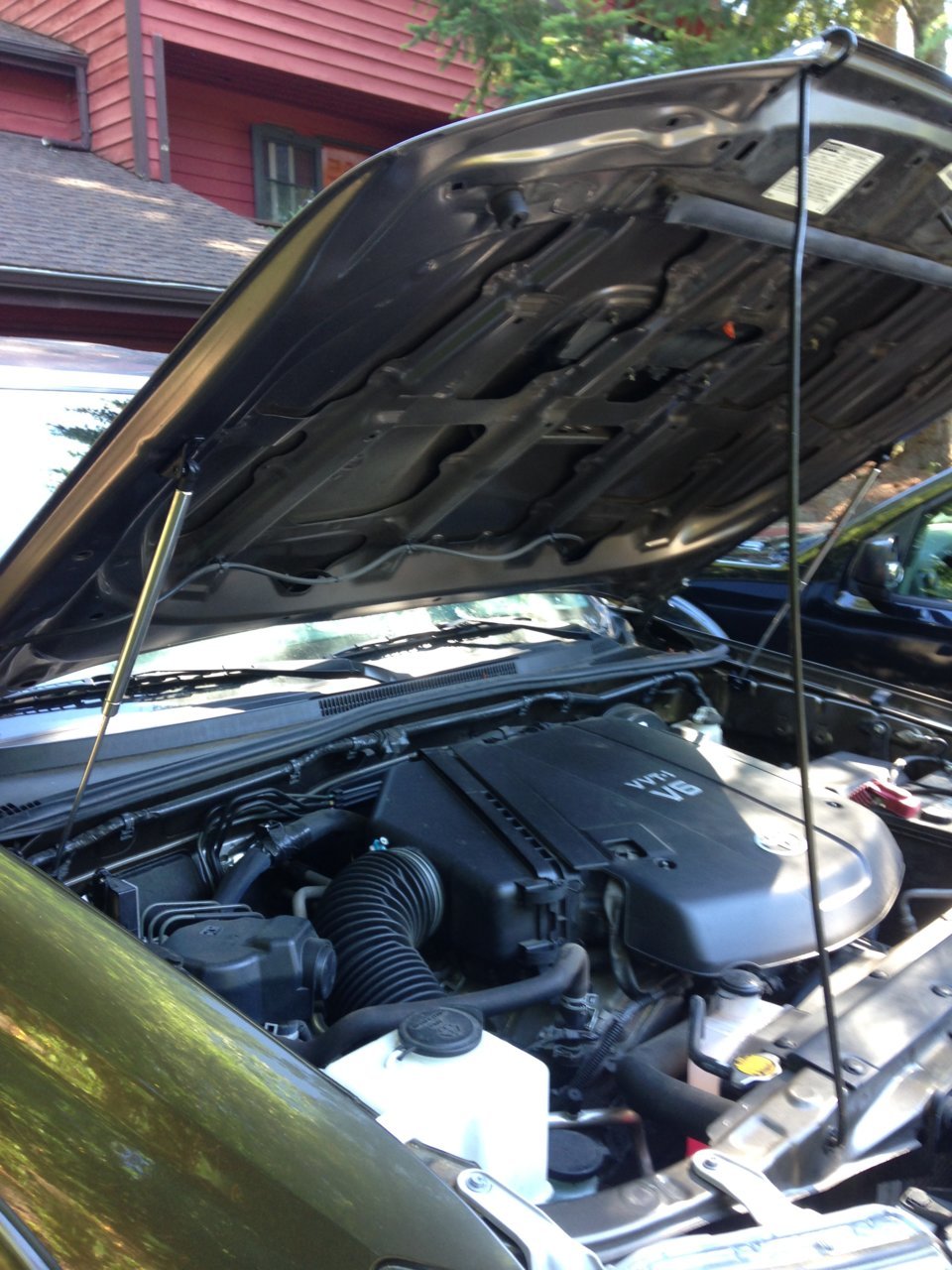

    About halfway done...
    This is not the case for me. I have a 2013 sport hood. The hood opens about 2" less with the quicklift struts.

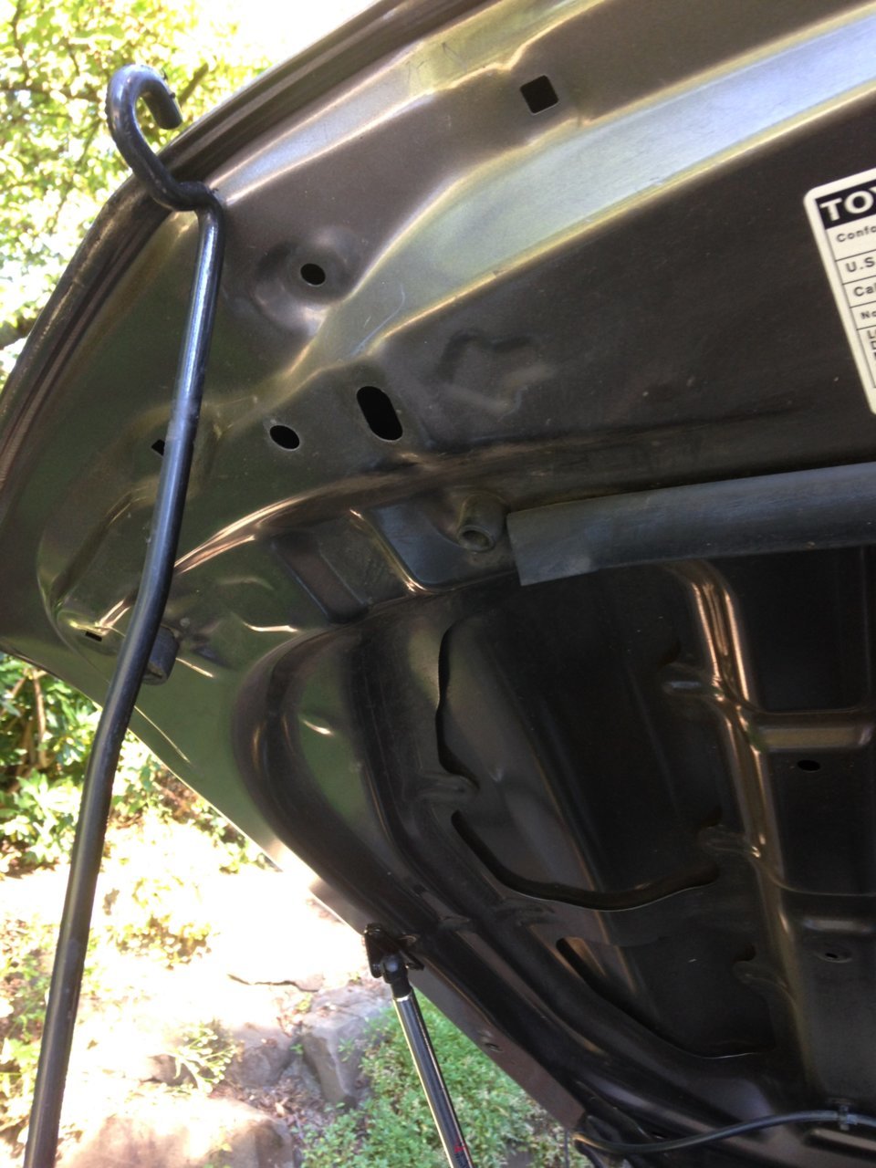

    My base cab 2013 works well with the hood support rod and will raise about 1-2" higher. The placement of the lower support is where my installation differs from yours in the picture. I finally gave up on trying to figure out where the instructions wanted me to measure for the lower support, and just extended the Redline while connected at the top and while the hood support was engaged. The lower support attached to the strut came to the span crush joint in front of where your lower support looks to be connected. The lower support fit nicely into the dimple of the crush point making for a more flush fit. The Redline struts are a good addition to my 2013, but the installation instructions and pictures leave a lot to be desired. Black supports on a black car, do not show up well at all. If I ever installed another set, I would just install the top support to span the hood crush point and the lower support to span the first crush point from the cab. No measuring required. I also drilled holes to attach the lower support from the side using SS rivets. Much easier than trying to get the self-taping screws to work using the top drilled holes. I suspect the strut mounts are a generic product not made specifically for the Redline/Tacoma installation.
