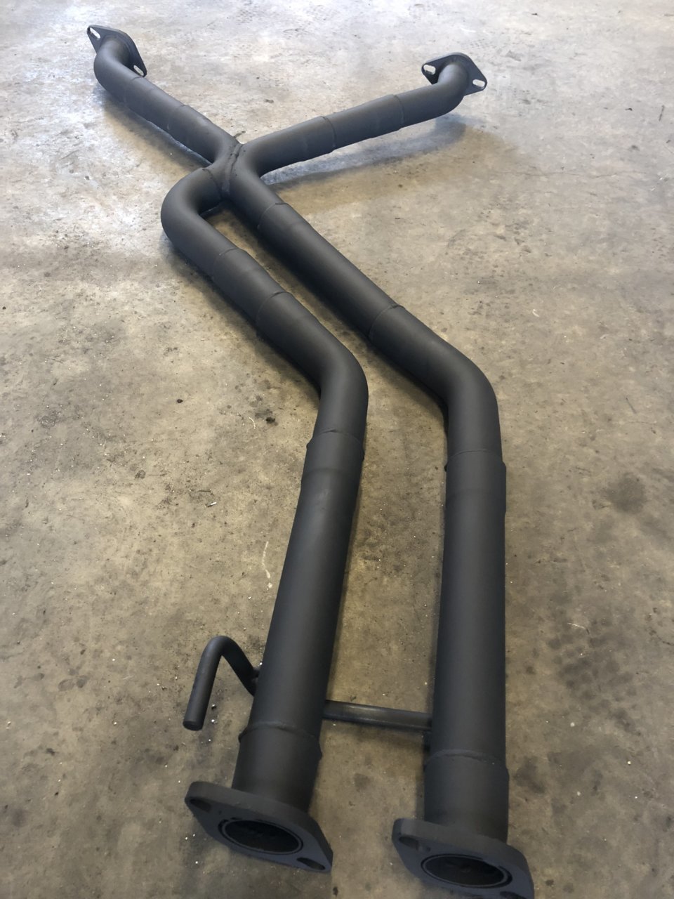

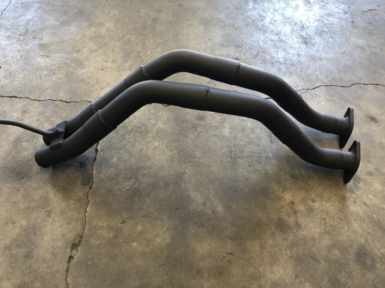

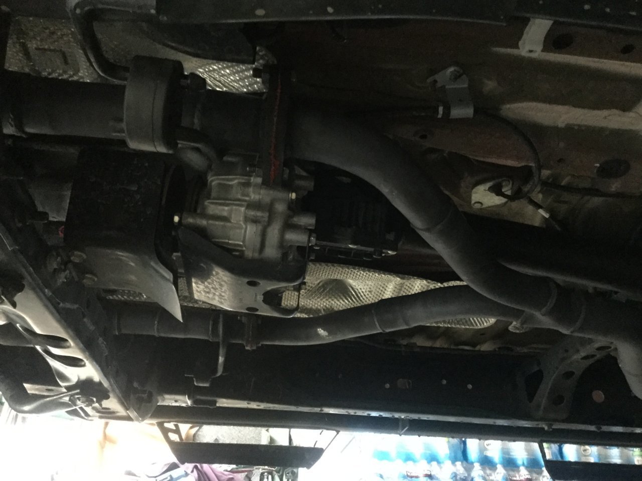

    Progress Update (9/3/2018): Took the Mid Pipes and made them Equal Length

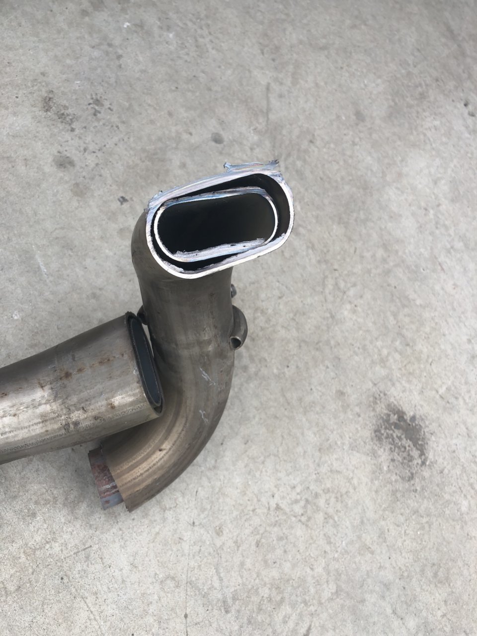

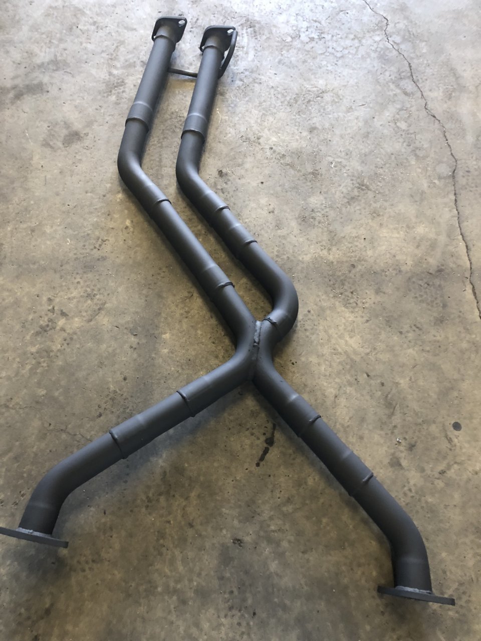

    Progress Update (9/4/2018): Smash Section Removed (Aka. Low Stock Crossover Pipe) & X Pipe Built.
    Smash Pipe: Both pipes are smashed separately and there is a bend before and after the smash. The inner pipe must be welded together somewhere, but threw it away after getting tired of making cuts. Haha
    On to the more important section of this build...the X Pipe! It definitely got rid of the rasp!!!!!

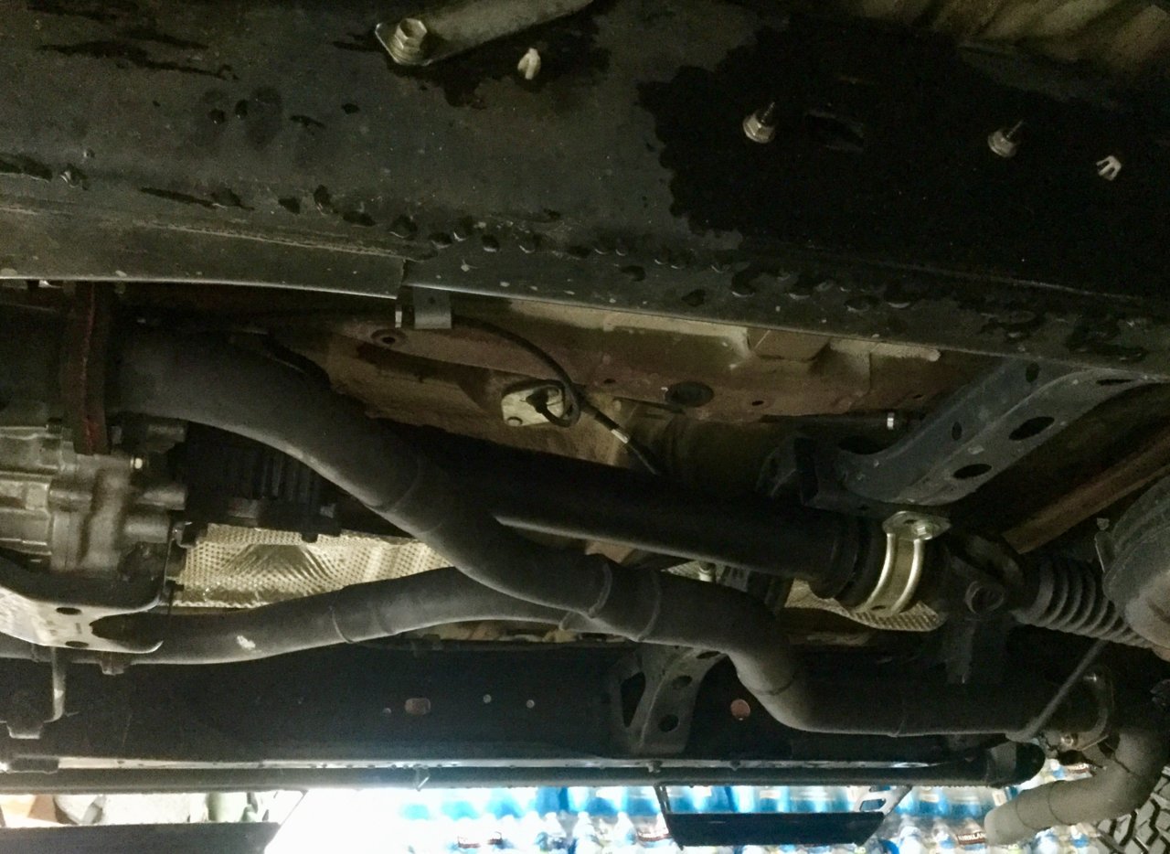

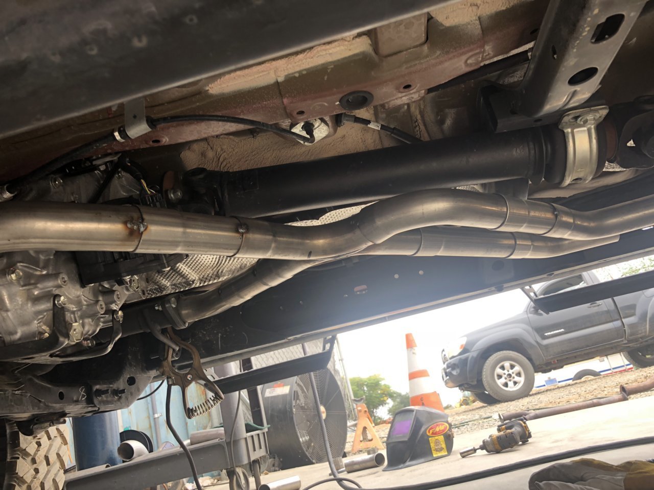

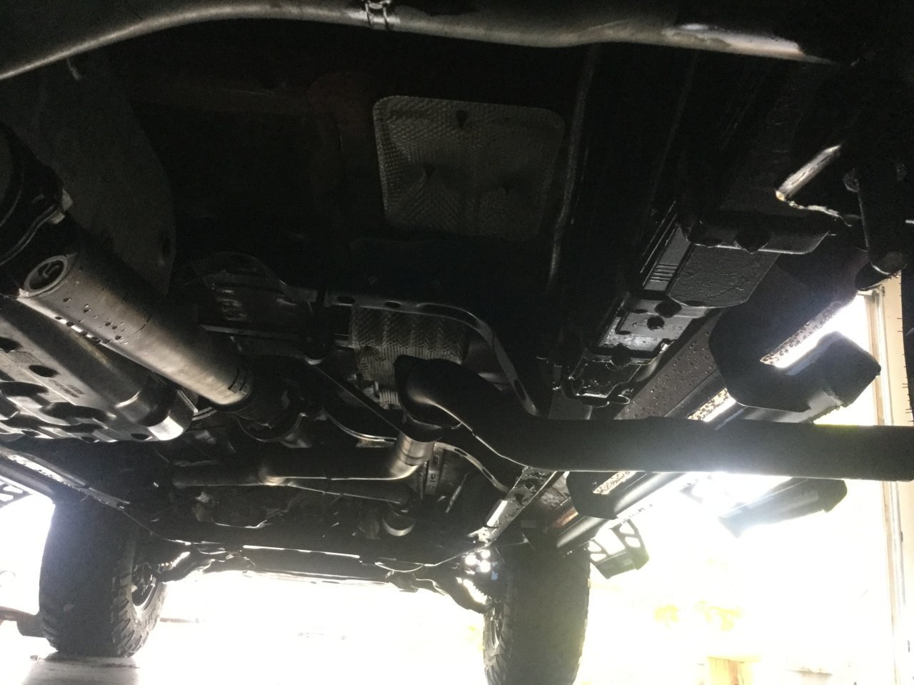

    Progress Update (9/12/2018) Dual X Pipe mounted under the Truck
    Single Y Pipe mounted under the Truck

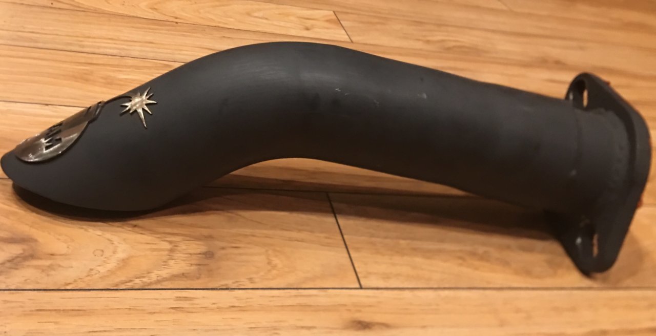

    Progress Update (9/16/2018) Dump Pipe

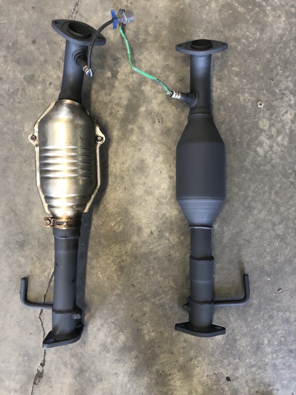

    Here’s a quick progress report:
    First of all, we modified the stock mid pipes. They both have custom flanges on them now. According to smog nazis of the communistic state that I live in, after the cats is fair game.
    Then we built a fixture around them. This gives us SEVERAL options:
    1. If you send us your stock mids we can modify them to work with our catback.
    (Our catback will only work with your modified mids or with our custom made Mids)
    2. We can build one off mids straight piped.
    3. Custom mids with mufflers
    4. Custom mids with any other cats.
    Second we built a custom catback. It was dual exhaust with x pipe. We made it end before the rear end with flanges so we could bolt tailpipes right to it.
    Then we built a fixture around that section. And we designed the fixture so that we could build a single exhaust with y pipe in it if we wanted. That’s right, we can build a dual x pipe. Or a single y pipe in the same fixture. We straight piped Katie’s truck. But there is room for a muffler in the system;) so to sum it up, we can make x pipe. Y pipe. Or mufflers. And we hand build our mufflers to dictate how loud or quiet the system will be. And we are able to size the muffler based on whether or not the rear cats are in place too!!
    Third, we built custom tailpipes. These go up and over the rear end. We built the fixture around them to also allow us to build just one if we wanted.
    After The first pipes were built, that laid the foundation to start trying things.... first thing we tried was a pair of mufflers. This made the truck really quiet. Without mufflers it really wasn’t all that loud.
    After building the dual exhaust and fixtures we tried several configurations. Each of these configurations kept all of the stock cats in place:
