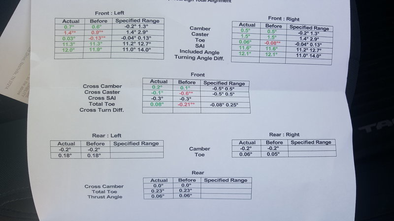

    Have you seen the print out of the alignment specs and care to share them? Usually they provide a print out of before and after such as this 20170401_081828.jpg
