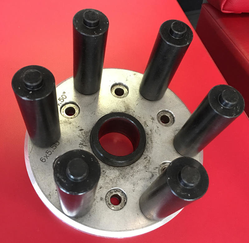

    I am not a mechanical expert. The vibration in 4Runners and Tacomas, has been a problem. My experience on new deliverys, 4Runners, '08, '12, '13, '15 and '18.
    Also, new '17 Tacoma, TRD. All purchase's, 4WD. I have never had the dealer fix this. Usual answer, "cannot duplicate the problem".
    The '08 and '12 4Runners were good, but not the best on vibration.
    After all this, I finally was able to get it worked out, but not with Toyota. The dealers do not have the time to do a fix, and will do a re-balance, or anything to satisfy
    on each visit, tell you to keep coming back, until you just get tired of it. This is not saying all, I am only relaying my experience thru the years.
    Here is my fix, not necessarily yours. On delivery, go straight to your favorite tire store. My choice, Michelin LTX/MS, and current designation, Defenders. You have
    to find a dealer that will do road force balance. This is for stock rims only. The wheels are either lug or cone centric. The key is the guy on the balance machine.
    Next, find the tire store that has the Haweka 6 pin adapter. This is used with the proper road force balance, plus, index the wheel, tires.
    For me, this has been the correct fix. IMO, the Toyota dealer does not have the time to get this right, I am not saying Toyota is wrong.
    The vibration for me has been front and rear wheels. Front feel it in the steering wheel, rear, in the seat. I am not interested in changing brands, except if the new
    2020 4Runners are unibody, may have to keep the '18.
