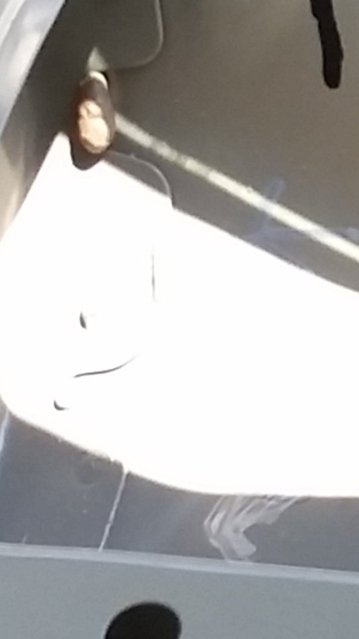

    I’ve never been so disappointed upon finally seeing a hole in my life.

    In the picture where the hood is open beside fresh air intake there are chalk mark arrows pointing to the spot where leak supposedly is located. Unreal

    Hard to see brown chalk on brown truck

    Thanks! I thought I was going a bit mental not being able to see the chalk.
    Given that it looks like a seam overlap, why remove the fender? Inject some sealant in and around there, test it, and be done?
