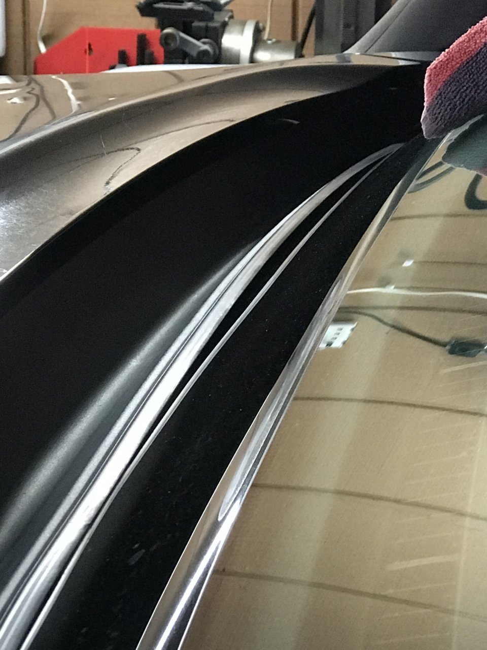

    I got a lot of water in my truck through the AC vent. The plastic cowling had some broken tabs, and the rubber wasn't tight against the windshield. So water ran down the windshield and goes right into that AC vent. Passenger side footwell had a pretty good puddle in it. Can see the gap in the seal.

    I have noticed a similar gap in that same area on my truck but thankfully no leaks.

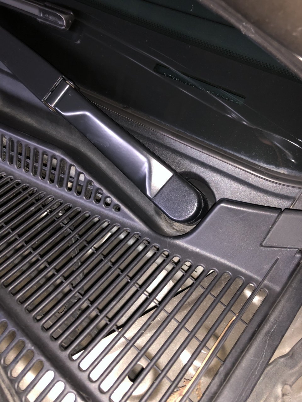

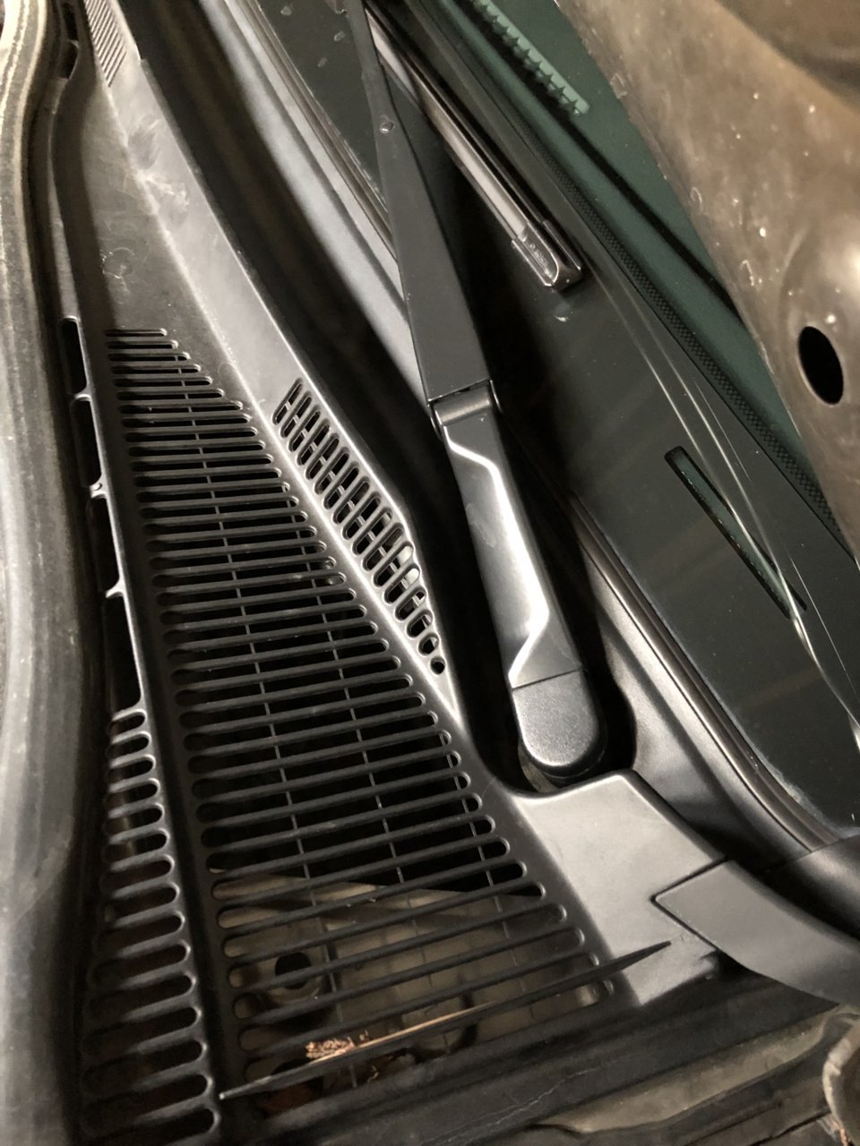

    I doubt that’s causing the leak. That ‘seal’ isn’t really a seal. It’s easily rolled simply by touching it. That cowl isn’t sealed either. Where the windshield wipers pass through has a large opening and there are vents through it. I would suspect your AC drain line is clogged and leaking water. Passenger side floor is exactly where the water goes when that line is clogged.

    Under the cowl is a large open area for fresh air intake. That could be leaking if the seal isn't right.

    How has no one commented on that drip?? Looks like someone replaced the windshield, if you're now having leaks because they didn't seal it properly then it explains why toyota won't cover it.
    Did you take it back to the original dealer you bought it from?? They should know if the windshield was replaced before the vehicle was sold, its not something that requires disclosure but given the problems you're having now I'd look into that...

    It's a known issue. On the passenger side is the ac intake. Look at the OPs pic. If that cowl isn't tight against the windshield, water will run right down the glass into the AC intake, then down onto the floor. Horrible design carried over from the 2nd gen. You better hope that seal is really a seal.

    I noticed that too. That's exactly what happened with my truck. But it wasn't the mastic seal, The guys that replaced the windshield broke some of the tabs on that cowl, and then water got past the seal, and into the AC vent. That's probably what is happening to the OP. Should have them check all the tabs on the cowl to see if any are broken or bent.
