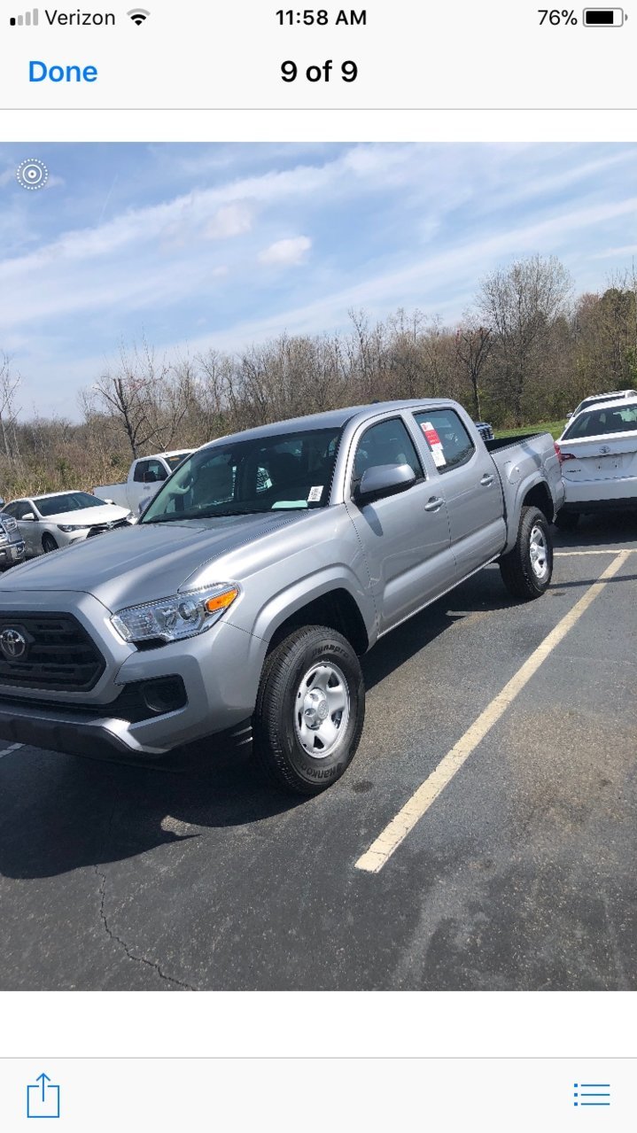

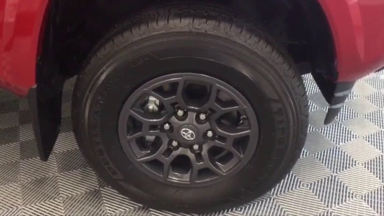

    I just bought a 2018 SR with the Stock steel wheels but ordered a set of the Toyota Dark satin alloy wheels as well
    They included install also
    Will my lug nuts work? Will by TPMS work?
    Thanks!

    Yes and yes

    Yes new lug nuts will be required. The steel wheels use a tapper type nut and the aluminum uses a shoulder type nut. Your TPMS sensors will not work with the aluminum wheels. The steel wheel sensors have a different angle than the sensor that goes into the aluminum wheel and you won't be able to install them.

    This is exactly what I thought. I know you can’t force the lug nuts but could they try to force the TPMS to work? I want it done right!

    I have a 17 SR. You would have to get them to turn the tpms upside down as the angle is different. If you want new tpms go aftermarket. My dealer wanted $100 each for new tpms. And new lugs will be needed as well. Keep a set of the old lugs!! Your spare is a steel wheel.

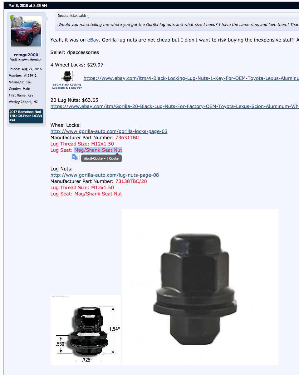

    If you want the best (Gorilla) correct lug nuts for your wheels then check out my post from a few weeks ago.

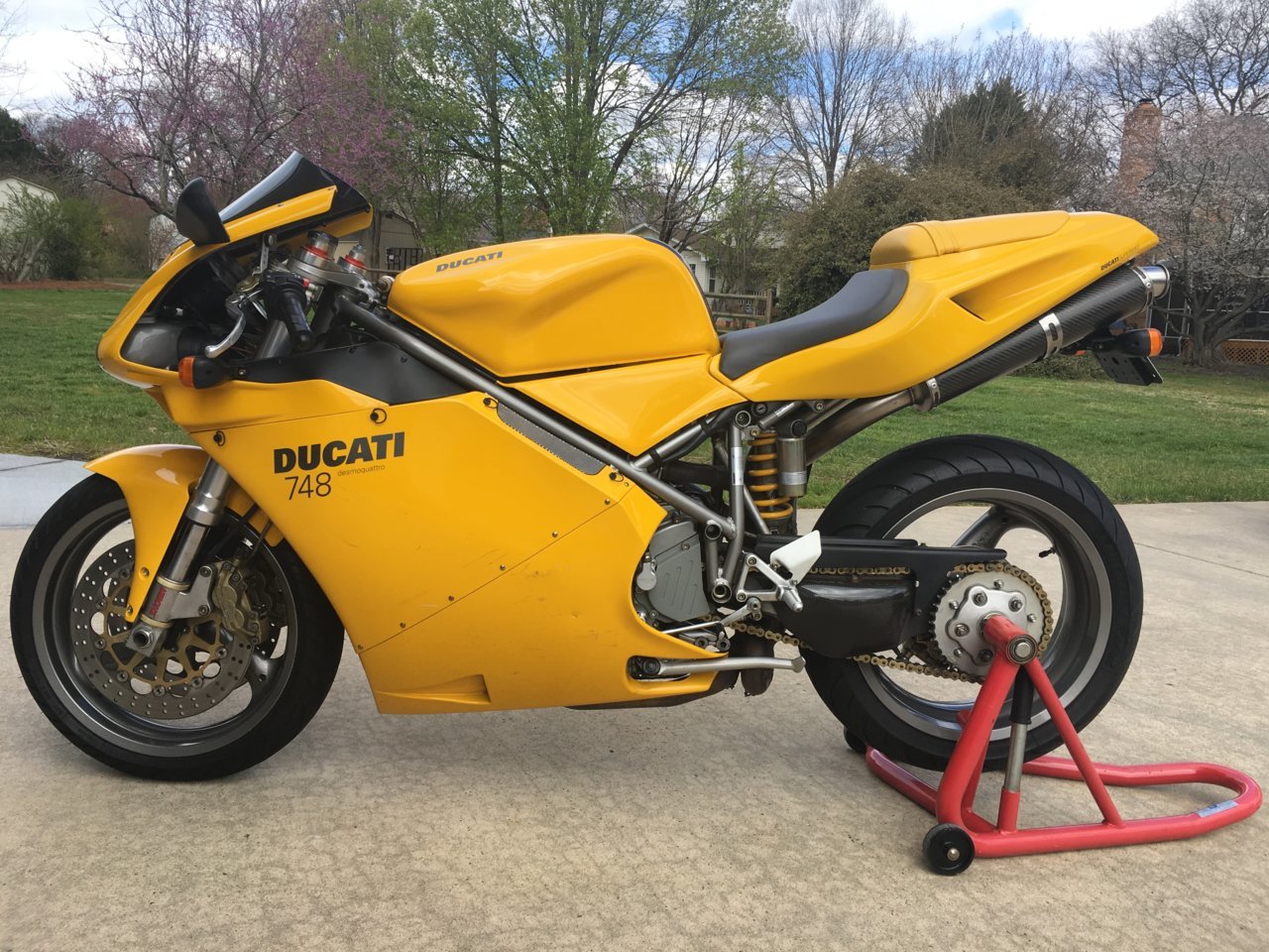

    First superbike...owners 4 Monsters before this bike. Absolutely LOVE this thing! Even the “ugly” side looks good!

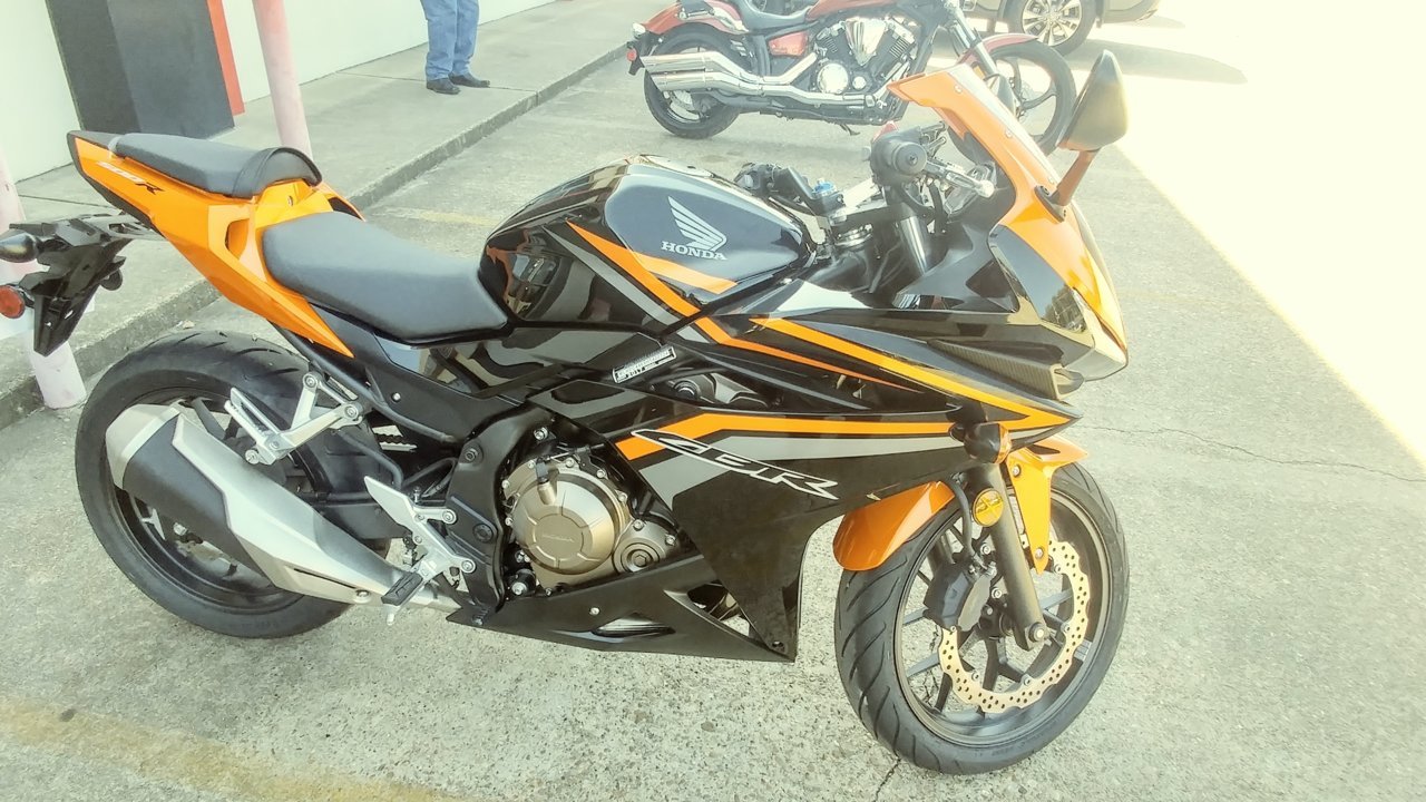

    I saw the pic of the bike and had to see what was going on in here. Very nice.
    Not nearly as fast as yours, but I like my Honda.
