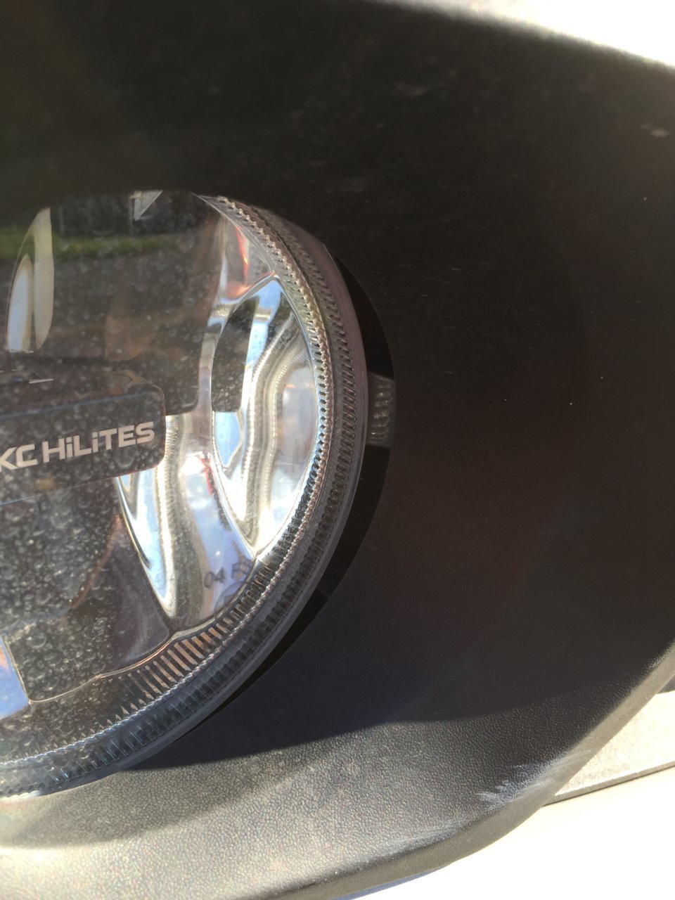

    Hard to tell from the pic which way the tabs face, but I think mine are long tabs toward centreline after all. I ain't removing the lights to check because of the risk of dropping that bloody screw again.
    You can see the word "driver" molded into the plastic in the picture. It is near bottom right of the back face of the light as shown in the pic. That pic is of the driver's side light.

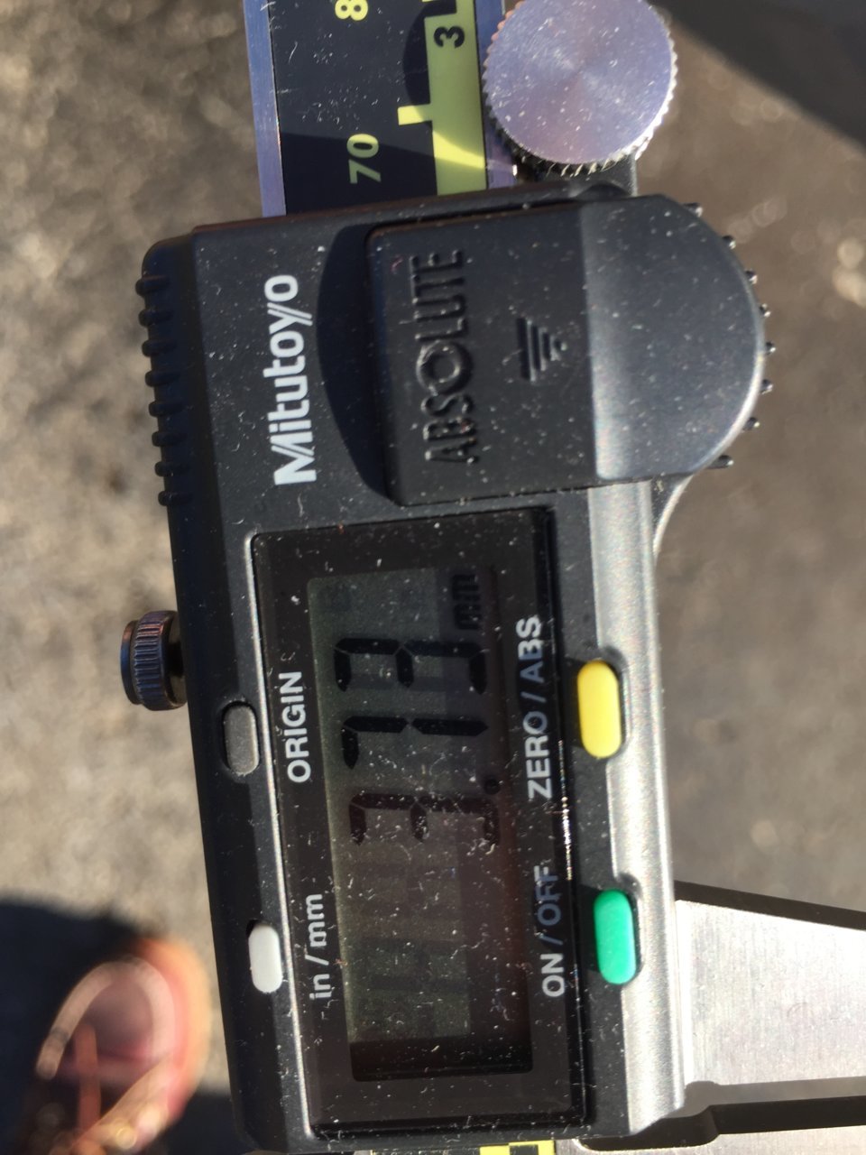

    Gap seems to be around 3.7 mm on the side closest to vehicle longitudinal centreline (gap pic is of passenger side light). Taylor@KC HiLiTES Do not recall to whom I spoke, I think you just need to improve the instructions and make the tech support guys aware as far as 3rd gen goes.

    You've got that installed on the right side, but to me looking at those pictures, the bottom short tab isn't inserted into the slot all the way, causing the long tab you secure with a screw to not sit all the way towards the midline. On mine, the screw is pretty much centered in the slotted hole of the long tab, and your picture seems to show it is situated not centered.

    You definitely have the long tabs outward based on the first photo but the short tabs look like they are not inserted fully into the slots.

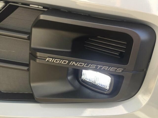

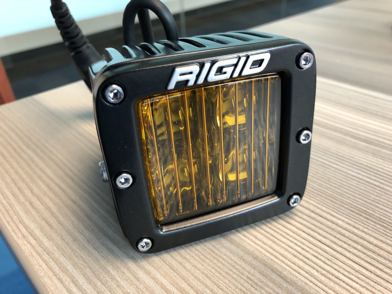

    Planning on getting the Rigid Amber covers for my Pro fogs. Curious if there is a way to double stack fog lights for higher output without blinding oncoming drivers.

    The D-series takes about a 50% loss in output using the covers. See my post #186 here. Going with Rigids selective yellow by comparison takes only a 20% loss. See my post #261 here. The OEM setup does look sharp, but the D-series SAE pods are nearly 2x the output of the Pro Rigids. Rigid is launching the new 360 Series fogs this month, designed to mount in the OEM location (non-Pro), boosting the output an additional 76% over their existing D-series fogs.
    I haven't seen anyone stack the fogs in the Pro location, but it looks like they might fit size wise. I like your stealth D-series in the lower grill. What did you use to mount it?

    So basically the benefits of the amber are negated due to the compromised output with the filter on?
    The setup isn't mine, but Ill check where I found it. If i remember correctly he either used the two light bar brackets or retrofitted something off of a UTV.
