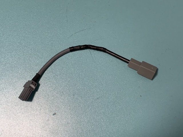

    Got both the KODJL cable from AliExpress and the other cable from Opuradio today.
    The Opuradio cable looks identical to the one on eBay. I’m pretty sure it’s salvaged from an OEM harness which probably explains the price.
    The cheaper KODJL cable from AliExpress seemed to be purpose built.
    I tore the Opuradio cable apart and wired it up to a USB retention cable to make an adapter from the car side USB matching the Entune 2.0 to the Entune 3.0 stereo side. Probably the most expensive adapter ever lol. :p
    In any case I can confirm that other than the painfully long wait, both seem to be good sources for the USB connector that goes into the Entune 3.0 side.
