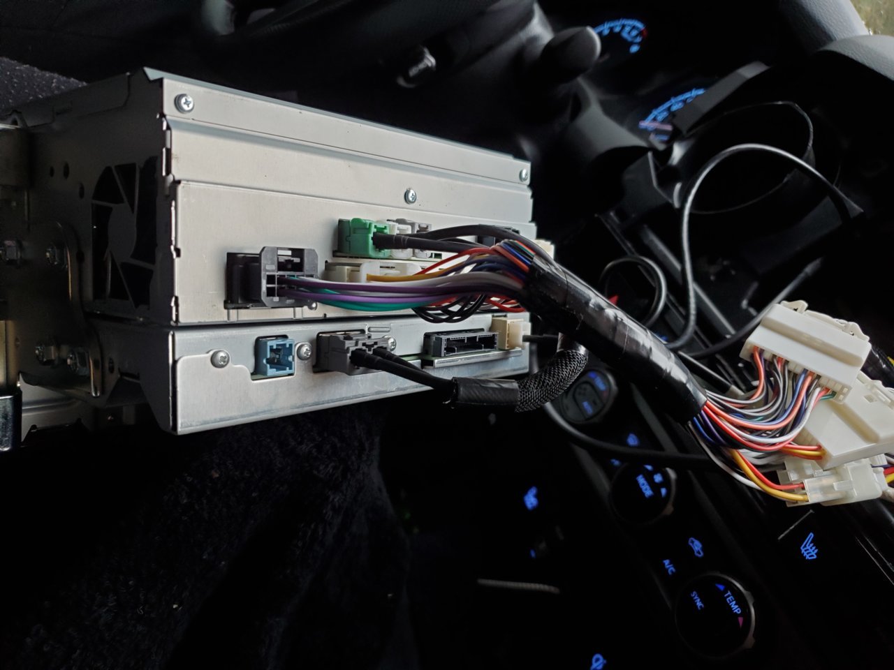

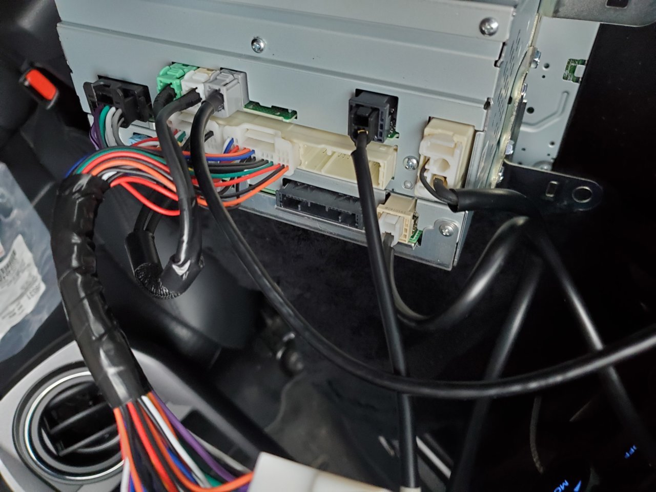

    I tried to change the clock sync settings but couldn't. I think the headunits with integrated nav require GPS for time (no option for manual time), the stock Nav unit my truck came with was the same but I will give it another shot and report back.
    I bought an entire headunit with integrated nav (radio plus nav unit) from a recycler/wrecker, (came from a wrecked 2020 Tacoma) but I didn't pull it myself, it was just sitting in their warehouse so I didn't have a chance to cut any harnesses. Mine came with zero wiring. I was able to buy the coax harness that goes BTW the radio and the nav module but that made no difference.
    I've contacted autoharnesshouse and he said he would be able to make the additional harness I need but it would take time. Im hoping he comes through cause otherwise this headunit is useless to me.
    This is currently what I have wired up. GPS antenna is in and coax to the main headunit (transmit images ?) but there is a black socket thats empty, I'm thinking a connector needs to go here to power the nav module?

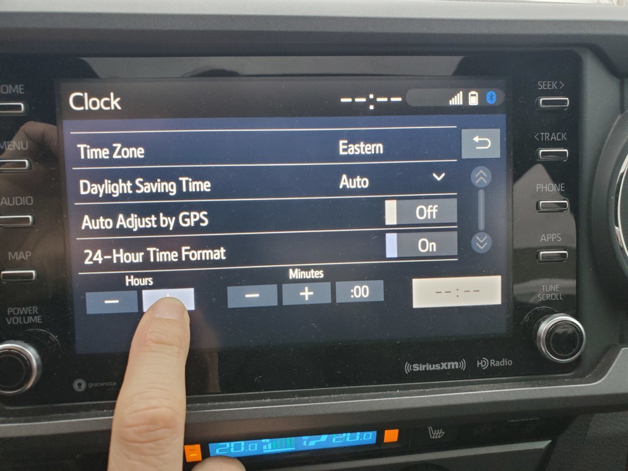

    Canada
    2018 DCSB Sport MT
    Under clock settings I can turn off "Auto Adjust by GPS" but that doesn't let me set the time manually. No matter what I select, the time remains dashed out

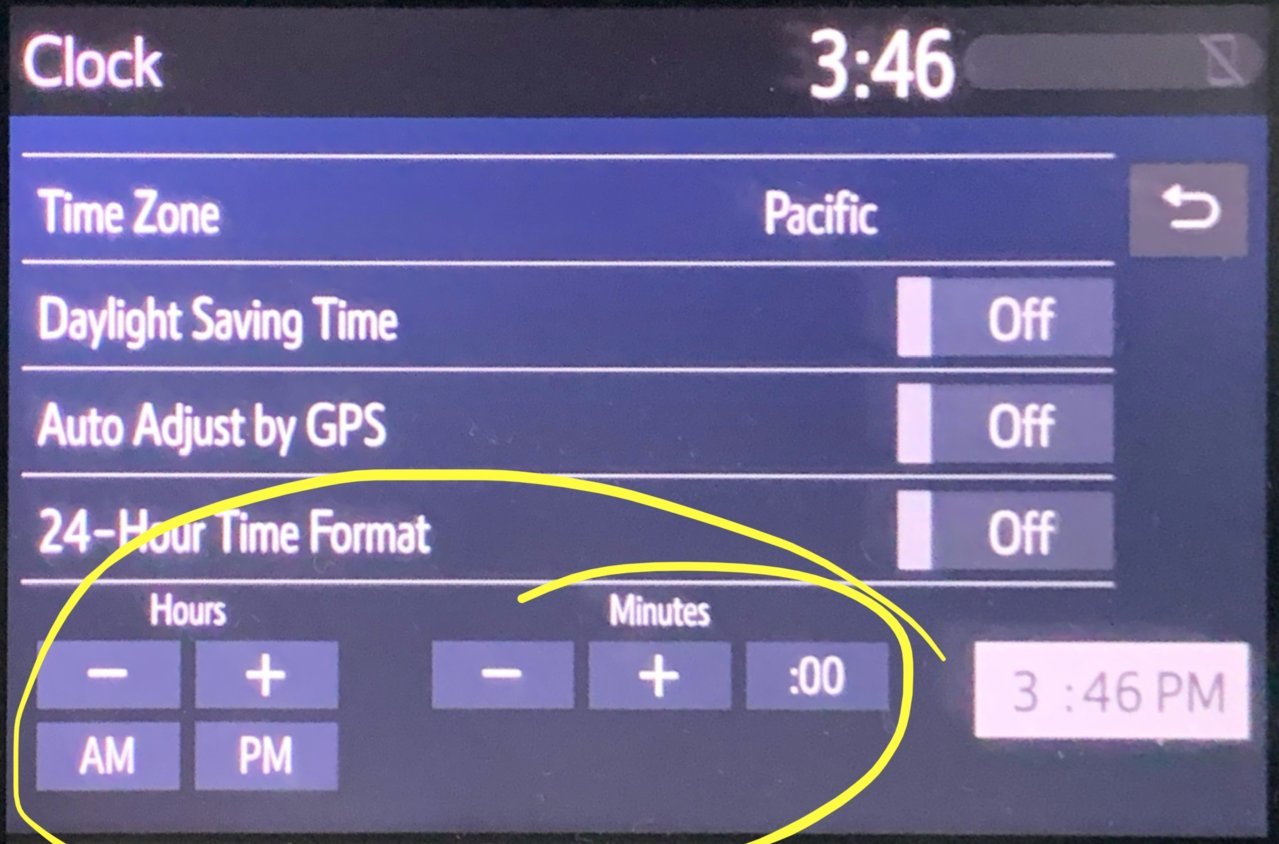

    Do these buttons not show up?

    They do show up but nothing happens when I press them.
