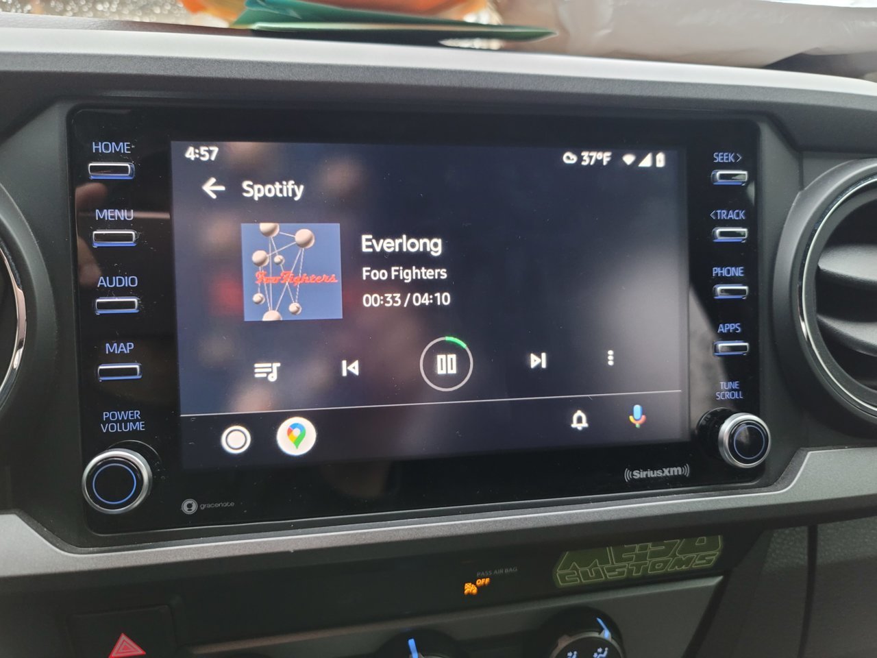

  7. Jan 25, 2021 at 2:06 PM
    #367
    Aje0010
    Aje0010 Well-Known Member
    Jun 27, 2019
    #297574
    48
    Alec
    2019 Quicksand TRD-OR MT
    Successfully did the swap today. Nav is gone as expected but I hardly care considering I have android auto now. Everything worked perfect with the harness from autoharnesshouse. Instead of using the factor usb port, I used half of the harness they include and then plugged my usb directly into the harness and ran the cord out of the vent directly under my hondo garage phone mount. Very clean, only like 3 inches of cord sticks out. Still can't figure out how to get the entune apps to work because mynew Toyota app is showing my VIN as 2019, therefore won't let me look at entune 3.0, it still wants me to use the dedicated entune app suite app (which is only for 2.0).

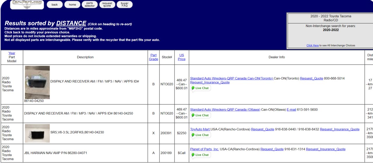

  12. Jan 31, 2021 at 7:40 AM
    #372
    TRDCal
    TRDCal Well-Known Member
    Feb 2, 2016
    #176893
    307
    Canada
    2018 DCSB Sport MT
    Car-part.com, searches wreckers all across North America. Local one here had one for $500 last year so I jumped on it. Looks like they have another but price has gone up abit (Side note: $2250 from ToyAuto!!!):
    As for the camera, picture quality is the same as my previous radio. Would I want to watch a movie in that quality? No. Is it good enough to hook up a trailer or not run into things? Yes.
    Quick update on my harness, autoharnesshouse got alittle delayed but I paid for the additional harness I need on Friday. Estimate was 10 days to build and ship it out so I don't expect to have an update for you guys for another couple weeks.

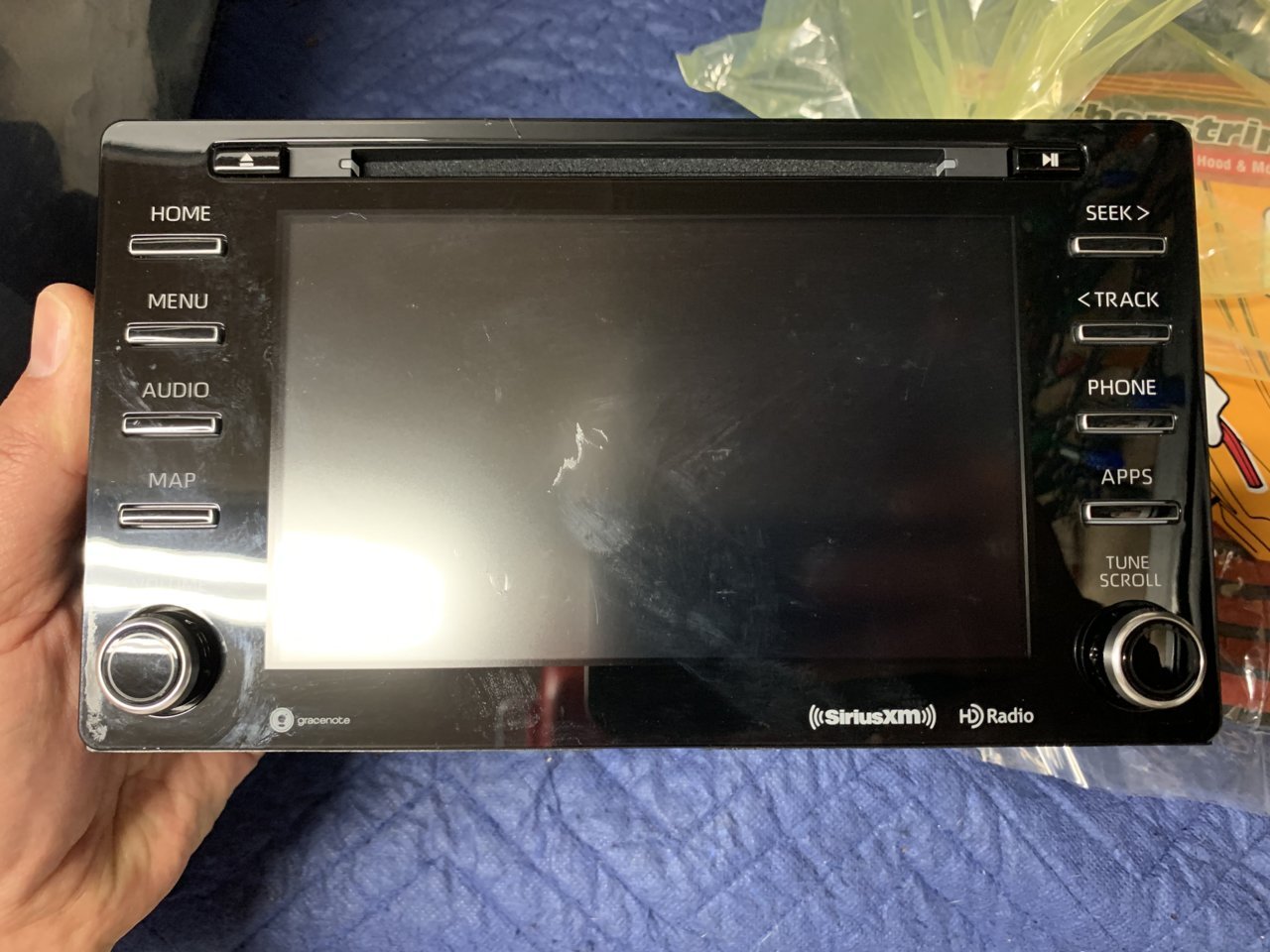

  13. Jan 31, 2021 at 8:10 AM
    #373
    IcemanPNW
    IcemanPNW Well-Known Member
    Apr 7, 2020
    #324019
    126
    M. E.
    3rd Gen TRD Off Road
    Nice, thanks for the tip, I’ll take a look!
    Going rate on eBay for the 86140-04230 - same as the ToyAuto - is around $2k right now, not sure why that part# is going for so much ... funny enough I don’t think that part# has integrated nav like yours.
    Is your part # the 86140-04250, or something else? I have a post on here somewhere where I’m keeping track of the features of all the different part #’s.
    Just got a prototype from him yesterday, soldered it in place last night and it worked perfectly with the Sienna radio with nav. First time I’ve had the nav box working. (No soldering needed normally, he’s been helping me with this for a while - I told him he didn’t need to send me a whole new harness, I’d splice the last connector in myself).
    I speculate the wiring is the same for all of the Entune 3.0 radios within feature sets (eg nav/non-nav, jbl/non jbl, etc), so you should be all set.

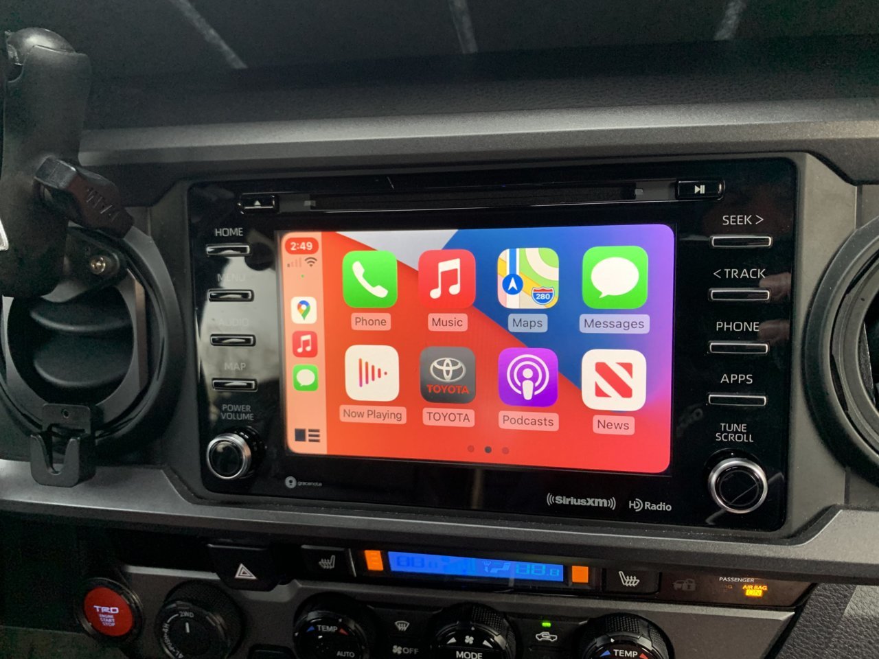

  20. Mar 13, 2021 at 5:24 PM
    #380
    TRDCal
    Feb 2, 2016
    #176893
    307
    Canada
    2018 DCSB Sport MT
    Finally got this working. Had some delays due to personal reasons and then I wired it incorrectly at first which added further, unnecessary troubleshooting. Bottom line, autoharnesshouse harness worked and this 2020 navigation system is working 100% in my 2018. Love android auto and I prefer this headunit over the original. It still feels like an OEM unit but it at least feels like an OEM unit from this century.
